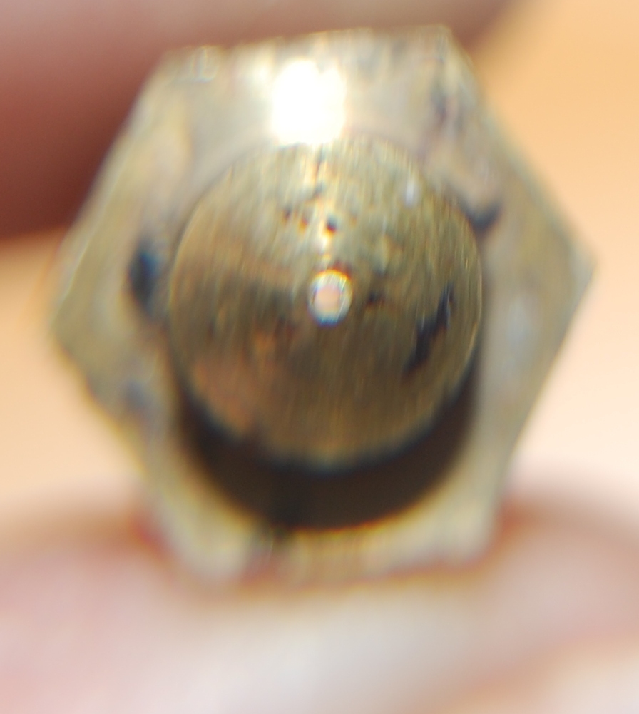

Later - I heat up the hot end and run some filament in 10mm increments. It isn't flowing well. Spitting some and not smooth. Does not even look like the full thickness it should be. This must be what a clogged nozzle is. So I let the hot end cool to remove the nozzle. Big mistake as I will show you. I removed the nozzle and it didn't remove easily- I sort of had a bad feeling but here is what happened.
Nozzle removed while cold
The PTFE 2mm tube came along with it. This means my only perfectly sized tube is now smaller than it should be. Well don't have any PTFE sitting around but lets clear the clogg first. I found two ways online. Acetone and torch. I choose acetone as it was later at night and seemed less an issue. (here is a good link to torch method http://www.youtube.com/watch?v=6bTfl35zlHE ) I left it soaking in Acetone for 48 hours. When I took it out it was a soft guncky consistency. I use a drill bit to push it through the nozzle and used a popsickle stick cut down to fit ot scrap any other stuff out. I also had on hand a small resistor where the wire was a perfect fit to push thorough the nozzle opening.
Used a small drill bit to push the Acetone soaked ABS thorugh the nozzle
Outside of nozzle clog cleared
Inside of Nozzle cleared

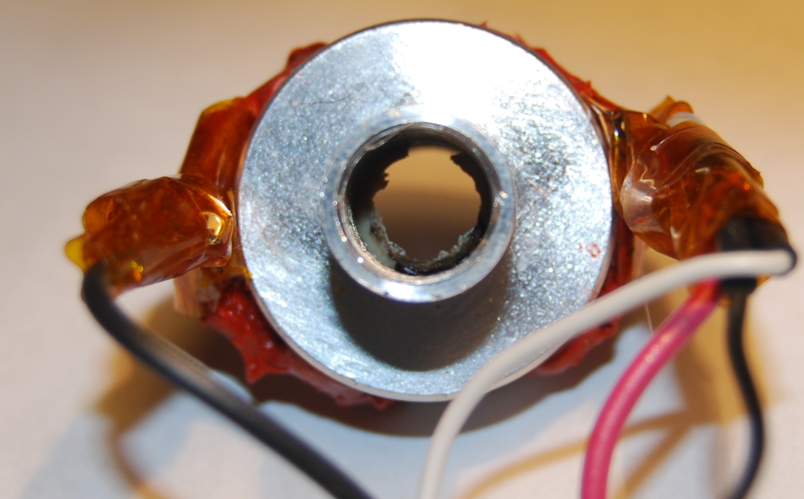

OK all good right - time to switch from ABS to PLA. Oh, wait that PTFE thing I twisted off. Well lets look at the PTFE tubes. Need to remove them from the hot end. I push on them and no go. I heat the hotend and push. No go. I heat up high to 240 and find a metal file with a round 2mm size. I push hard and they come out. ( maybe next time I will remove the hot end from plateform.) Below is what I see. That doesn't look right.
melted PTFE or just deformed. Not sure
Try to make do and it does not work well. You can see belwo where some ABS squeezed through the too shor PTFE liner.
Inside the Hotend  - that is some ABS from trying to use to small a PTFE tube

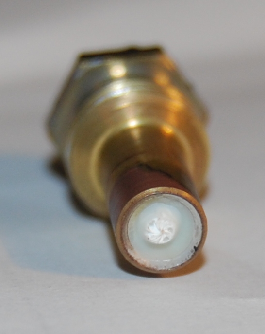

I put the 2mm PTFE into the Nozzle and then screw it into the Hotend to find the length I need. ( can't use the old one as I broke it. ) then I subtract the end of the PTC fitting ( about an 1/8th inch) and that is my 2mm size. I that a length equal to the 2mm of the 3.2 mm. I slice one side so it can split open. It is a smaller Inside Diamter than the outsdie diameter of the 2mm ID PTFE. It looks like below.
PFTE liners measured
Executive decision. I will drill out the PEEK so that it is all about 6mm well it will be 1/4 as that is the drill bit I have.
Now the PTFE tube slides inside and works well.
