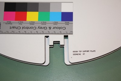

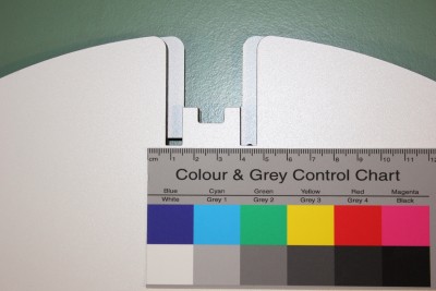

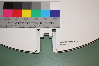

When I built mine I encountered the same problem (see the pictures below).
I decided not to rely on the both plates beeing exactly the same, but on the heated bed beeing exactly 90° to the towers. This is ok as long as the circular alignment is right (which it was in my case).
Nevertheless I sanded the bottom plate (the one which had a slightly elliptical shape) to match the top plate. Just in case. :-)
Top/Bottom plate, matching side.
...and the opposite side.
Using a good bevel gauge which helps you to adjust the three towers to be exactly (!) 90° (and this in both, X and Y dimesion) to your heated bed, is more important than having exact matching inner faces of the both plates. IMHO.
