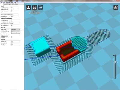

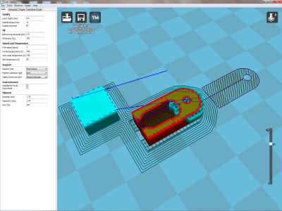

As soon as you release your mouse button Cura will "re-slice" the model. Use the View Mode > Layers icon to view the layers of the re-oriented model. You'll see support material generated on several of the layers.
The most troublesome layers of this model are the transition from Layer 30 to Layer 31. Layer 31 presents a huge unsupported overhang (over the horizontal cylinder in the middle of the model). I have not found a way to "force" Cura to build support in that area. So, I have attempted to use the "Plug-Ins" feature of Cura to adjust both print speed and temperature as these layers are printed (see the Plug-Ins Tab in the Cura window to see some of the settings that change as the print runs). Here are screen shots of layers 30 and 31.
You will notice I am using the "Prime and Wipe Tower" in Cura. The name of this feature says it all; when it is an extruder's time to print it first puts down a layer on the top of this tower (it primes the extruder) and then the gcode "drags" both extruders over the surface of the tower (or vice versa - heck, I'm tired and confused). This wiping removes "drool" from the extruder that has been "turned off" and cleans the tip of the extruder that is about to print. After the extruder primes the gcode "hurries" the active extruder to its starting point and it lays down its print layer.
