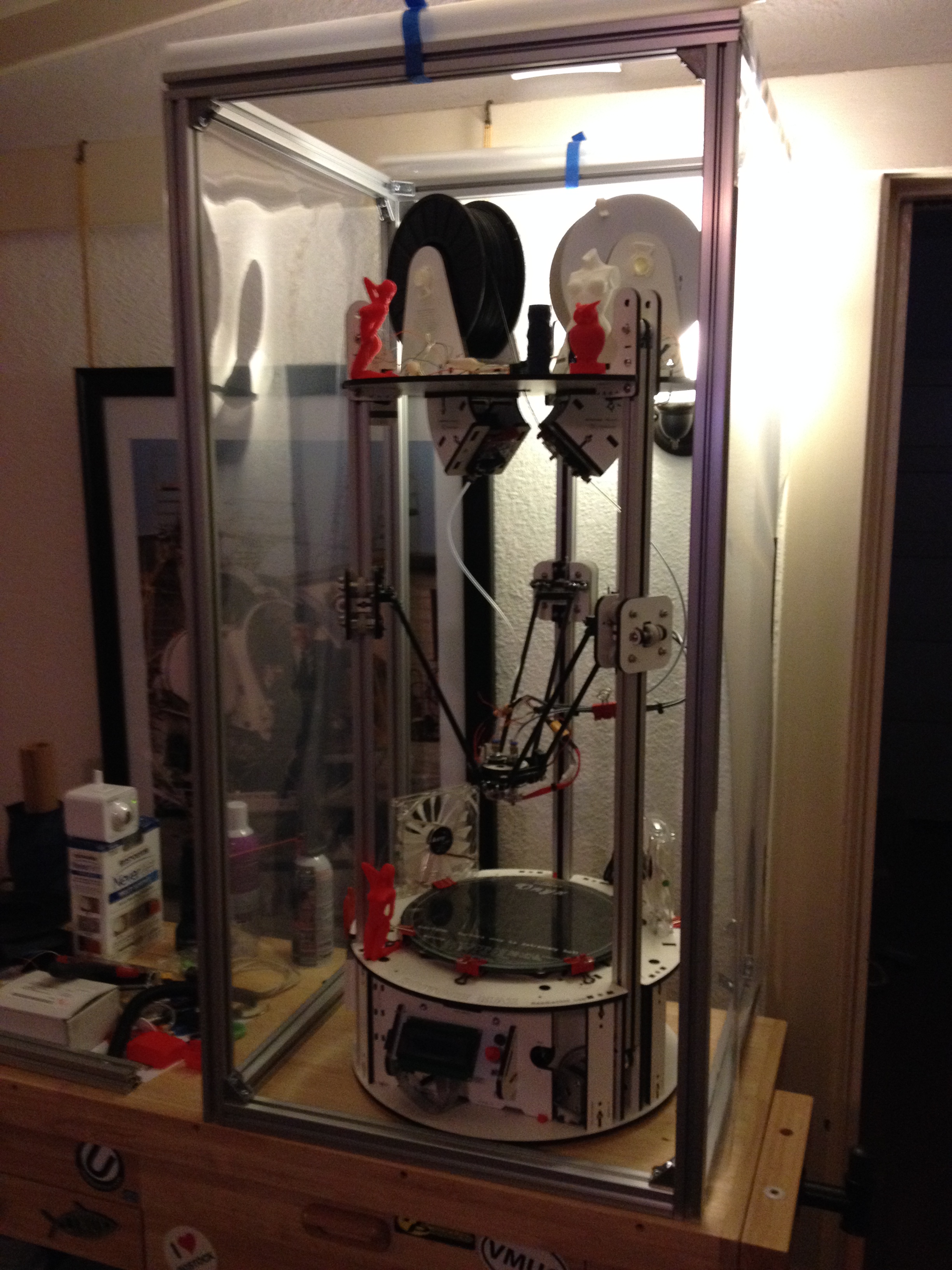

Poor Man's Heated build chamber
Post by ArthurDent »
In case anyone doesn't know, Misumi has a $150-off first order deal going on util the end of March. Search Reddit for the coupon code.
I really didn't know what I should get from them, so I thought, "Why not a build chamber?"
The (30mm extrusions) frame is a complete kit (HAUBA6L-3030-W600-D600-H1200) for $138, and I grabbed some sheeting that hopefully will withstand the temperatures.
I will be placing some more horizontal extrusions (15mm) in the middle to support a "gasket" between the hot print volume and the electronics in the base, as well as one on top to have the spools of filament in their own space with desiccant. Some more extrusions to hold LED lighting and my netcam.
I might add actual doors in the future, but that will cost actual money. :)

Very nice enclosure. The kit is a good idea but you can also create one from extrusions that you can get from
80/20 or Misumi. Buying the parts separately will probably exceed the cost of the kit, making the kit a bargain.
