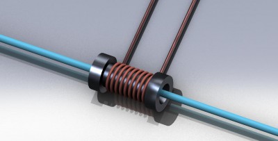

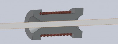

Hey everyone,
I've had this idea for a while now that I think might solve some of our problems with filament diameter and water absorption. I call it the Dry-Draw, but it's pretty simple.
So basically it would be a small metal tube with a hole down the middle that the filament gets pulled through. The hole would be the exact diameter of what you want the filament to be when it's printed. This part could be about 1/2 and inch long and would be mounted somewhere between the spool and the cold end extruder. The metal tube would be heated to a point below the plastic's melting temperature, but hot enough to dry any moisture out of the filament immediately before being fed into the hot end (especially nylon and hygroscopic plastics). It would be passive; the stepper pulls it and a small nichrome wire with a low voltage could heat up the tube to a reasonable temperature until the dissipated power is equal to thermal losses. Like a tiny toaster on your printer using only a few watts at most (it could be powered by the 5v output on your printer's power supply). The raised temperature would reduce the force needed to draw it through the metal tube.
The whole point of this is to draw the filament to a consistent diameter to avoid over or under extrusion regardless of variations in the filament diameter, as well as to dry out the filament prior to printing. I think it's a simple solution that would eliminate the need to bake spooled plastic prior to printing. It would also allow the use of homemade filament extruders without the need for an extremely consistent filament diameter.
Does this sound viable, or am I stupid for thinking of something like this in the first place? Any experts on wire drawing or thermodynamics please tell me if this is legitimate!

It's a neat idea. The devil will be in the details.
Just thinking "out loud":
If it's hot enough to ensure drying at high feed rates and to set the correct filament size, it will be hot enough that the plastic will be soft. Soft enough that if you pull on it the filament will be drawn thinner. And pushing on it will blob.
Sadly, on most prints there's plenty of push, pull and all manner of acceleration in between meaning you're going to end up with a mess of plastic if you put something like this in the live filament path. What you could maybe do, though, is have a steady rate extruder pushing filament through this device at the "average" rate into a big loop into the air which would buffer the extra filament, allowing the main extruder/hot end combo to back and forth as much as required.
Another point - just a bit of nichrome wire won't give you the fine temperature control you need to ride the very fine line between too cold to do anything useful vs melted puddles of plastic. You'll probably need a full PID loop.
All in all it might end up looking like a continual rate 1.75mm nozzle extruder sitting between the spool and the "business end" extruder.

Yes, it is an interesting idea. Dies for drawing wire to size work by pulling the wire lengthwise, thus decreasing their diameters. Our filaments are ductile enough to do the same thing I think. These wire dies are actually conical - and I think your's would need to be too. Think about it, the fatter diameter filament would need to feed through the input and then be reduced in diameter to come out the output. Your idea of using heat would increase the ductility so the stepper could draw the filament, a good idea.
[img]http://upload.wikimedia.org/wikipedia/e ... rawing.svg[/img]
These wire draw plates have a very short length and not a lot of reduction since it takes a lot of force to pull wire. Our plastic should be much easier, especially when warmed, so a longer draw length would be fine and provide the necessary residence time to warm the plastic.
It's time to build one and try it out!

geneb made the point of adjusting the flow rate based on real time changes in filament diameter; I've heard of this as a concept before. It could be done fairly simply but there would need to be major changes to firmware to support it, as well as extra inputs on the electronics to detect the sensor (potentiometer probably). It wouldn't actually modify the filament in any way, so moisture problems wouldn't get fixed.
Just to make it clear to everyone since my concept picture was vague, the dry-draw would be mounted between the free-spinning spool and the cold end pinch wheel. This would mean that there doesn't have to be any special "buffer length", since the plastic would only be warmed while inside the draw tube and immediately after it exits it.
I also realized that the draw tube itself should be extremely short with fillets and chamfers to prevent jams and stuff. It would probably look more like a plate.

The filament would definitely stretch a little bit if it was larger in diameter than the hole. If the filament were smaller than the hole, it would just be pulled through and heated up a little bit. If it were larger than the hole, it would be drawn to size and heated up. The hole would just reduce the diameter variations of the filament to get the exact flow volume at the nozzle.
There wouldn't have to be a thermistor on the metal plate (probably); a few watts of power from the power supply 3v output would be enough to heat the metal plate until the input wattage would be canceled out by thermal loss to the surrounding air. This would have to be fine tuned to the plate material and geometry. Of course this draw plate wouldn't need a very precise temperature control anyway. It just has to keep the temperature in the 100 degree Celsius range to evaporate some of the water in the filament and make the filament easier to pull through the hole.
