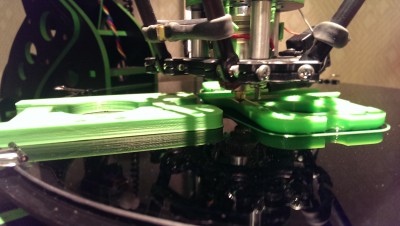

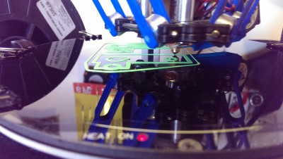

So guys, another trick I've been using for a while to make sure it works well is,
Cheap window tint from the auto parts store as a 'tape' or build surface treatment. I use the cheapest stuff they have. Put it on with a bottle of water and a few drops of baby oil or palmolive to let it slide around and let you work the air bubbles out, then go print!
Here's some pics. The first is on an Orion printing ABS parts that are appx. 4" diameter, with no warping at all on the bottom layers at 100c
The second pic is on a Rostock MAX printing PLA with the bed at 60c
Enjoy!

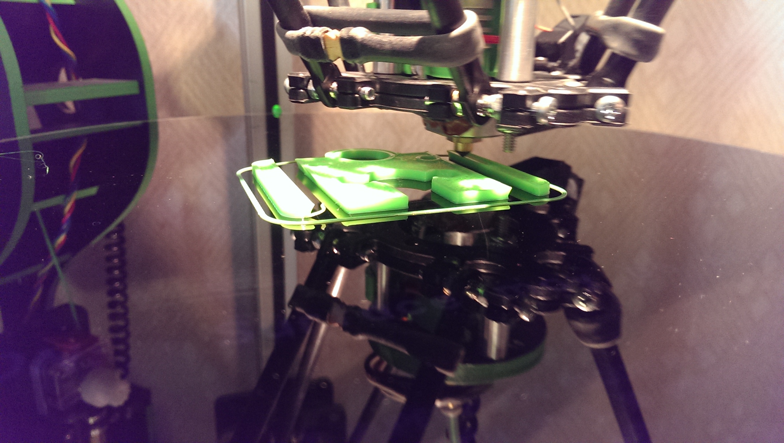

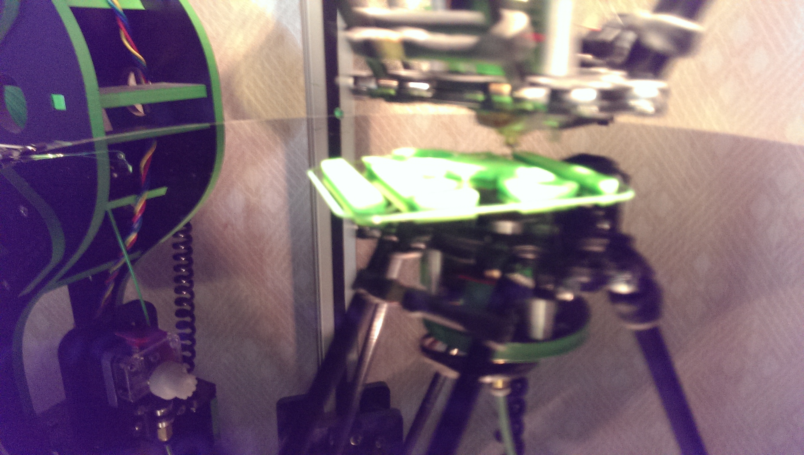

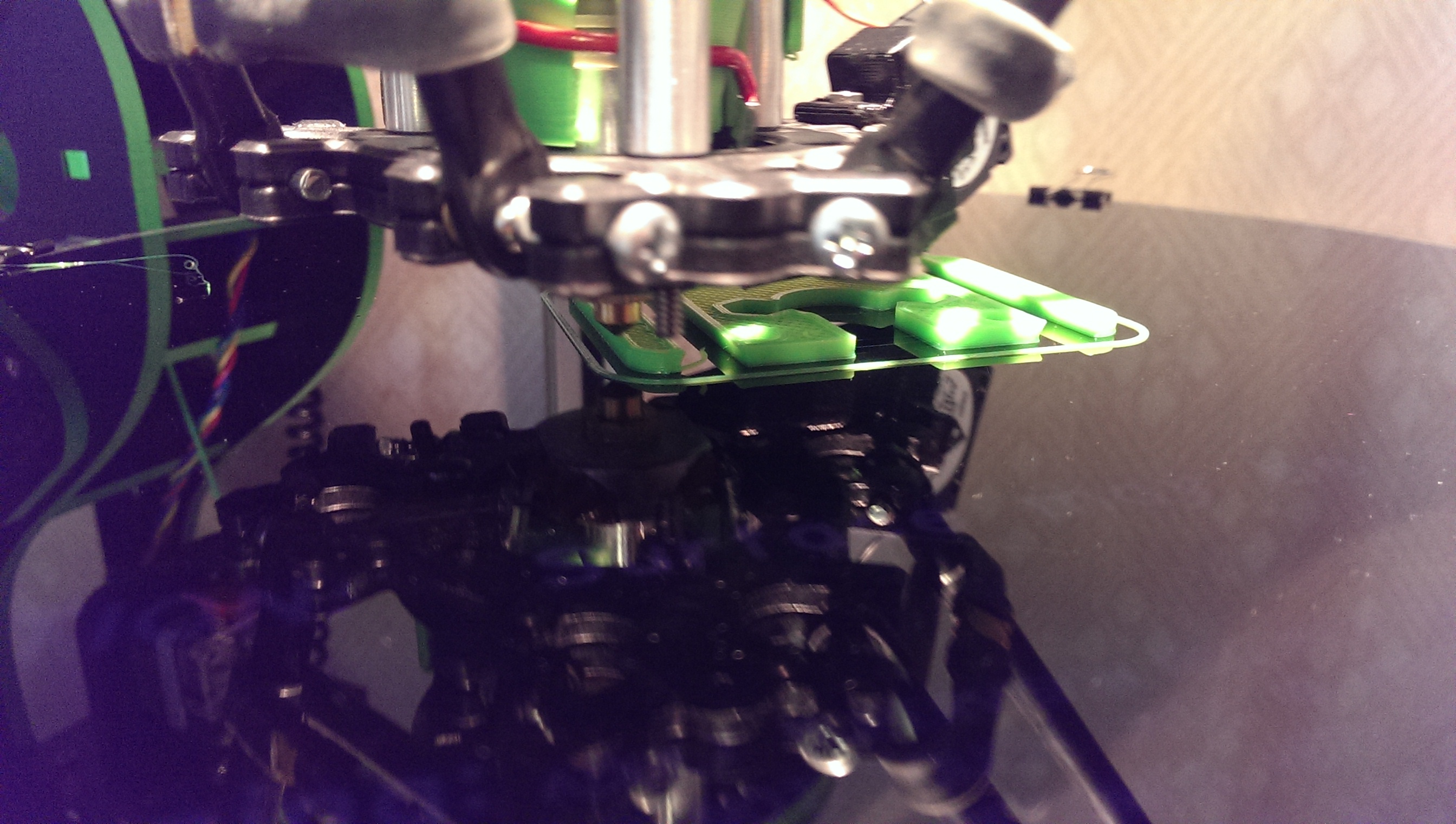

Check out the super flat large ABS parts! I'm really impressed how well it works actually!
