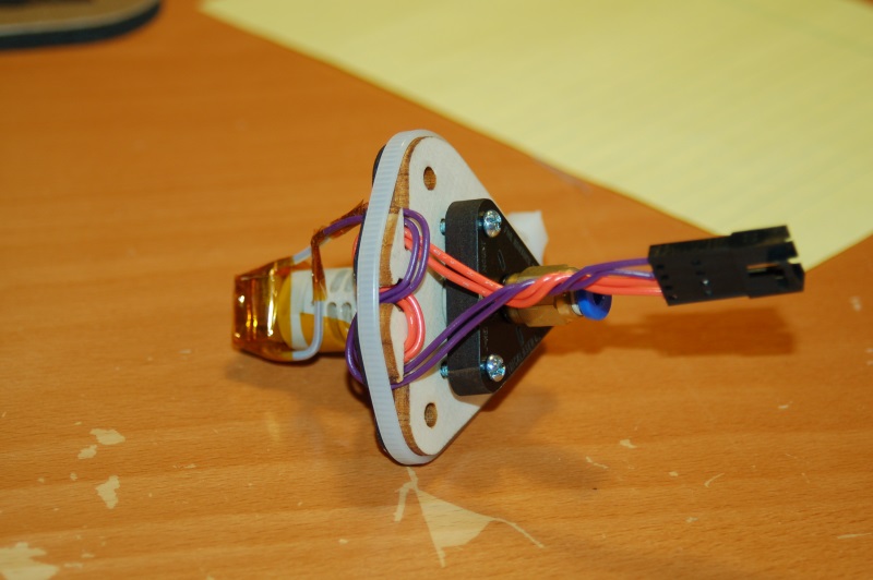

Being serious here, That looked like a new hot end design in your visual BOM? Or is it just a bad angle....
It is a new design. The sides have been shaved a bit, the PEEK barrel has had improvements made (single liner now!).
Also, you don't need to use foil on the resistors. Steve & the guys at SeeMeCNC have been testing using RTV only and they haven't had one fail yet. I suspect it's because the copper in the RTV is helping the heat distribution quite a bit.

The hot end wiring will use four pin connectors like the one I used in the image below, and I'll use JST connectors for the fans.
[img]http://www.geneb.org/rostock-max/j-head-2.jpg[/img]
Using the connectors allow folks to change things out more easily and that's a bonus when you guys like changing to different hot ends so often. :D
The four pin and JST connector sets can be purchased from Hansen Hobbies (http://www.hansenhobbies.com/products/connectors/) VERY inexpensively.

One thing I've noticed is that the wires are always going through the holes for the hot end. It is probably me but I never do that - primarily since if I have a blow out, it's easier to rewire a specific part - like a thermistor when it's outside of the holes.
I'm pretty sure that is not likely to change but I thought I would mention it. We all have our own little best practices.

The new hot end adapter is designed such that you don't run the wires through those holes any longer.
I'll be using Andy's photos for the hot end build and "hard wired" install, and my photos & process for using a 4 pin LP connector and two JST connectors for the hot end and fans. I got hooked on those 4 pin connectors from my LulzBot. They're perfect for doing quick-change hot-ends.
