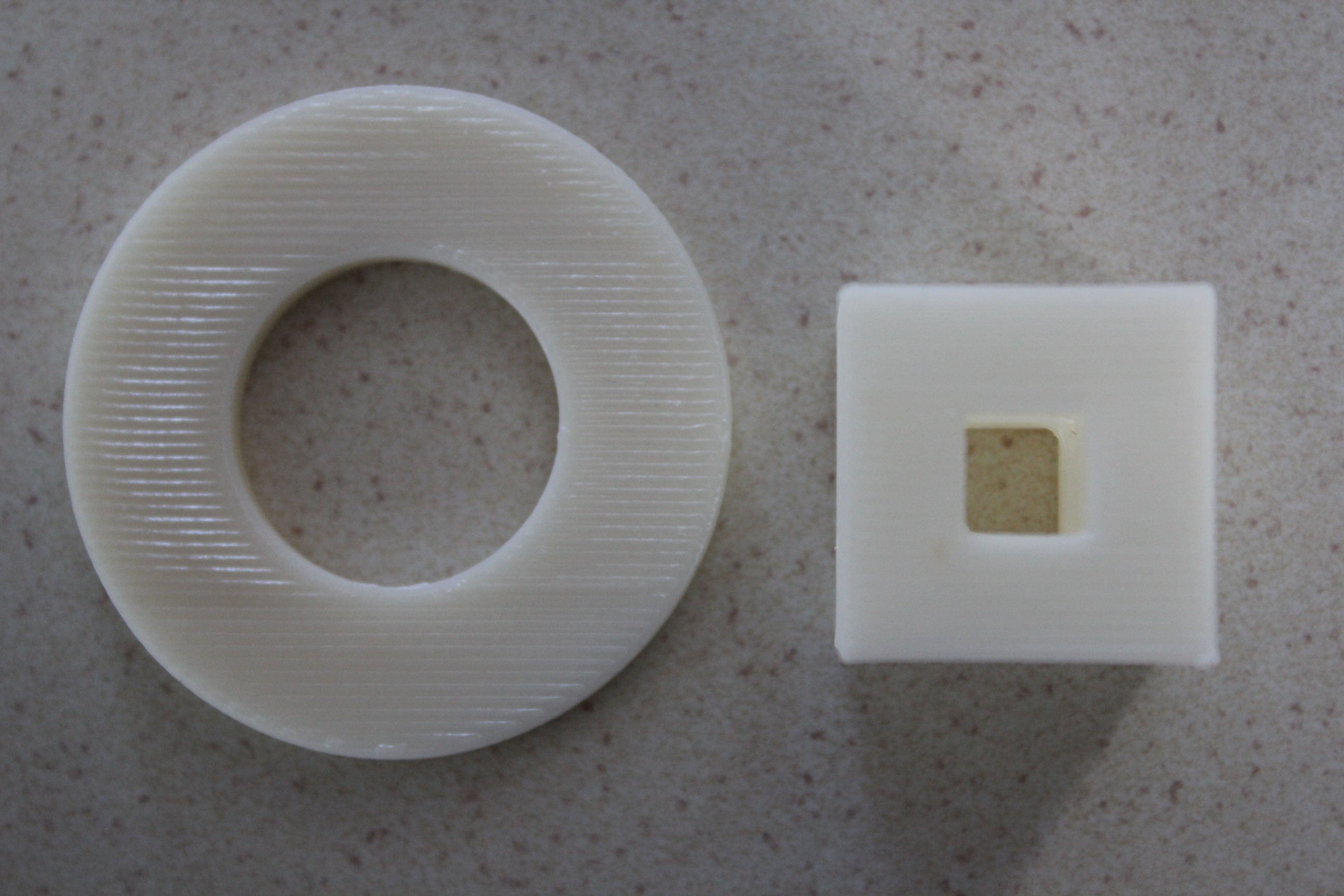

The 2 pics show a before and after. The problem was a completely seized u-joint onto the axle. The axle was rotating in the Carriage U-Joint mount so it was acting like a u-joint but with a lot of strain. Took it apart, cleaned and lubed and away we went. This machine only has 800 meters of filament through it so I guess regular check ups- Lubes are essential.
Out of round and the cube is twisted
Nice and round . the cube worked well too!

I just wanted to thank everyone Including John for sending me the new axles ans u-jonts and just like Holy1 one set was realy locked up .
Here is a before and after print of the seemecnc driver.

I do hope you put a little white lithium grease on the axle where the u-joints ride so you won't have to go through this again. It may not be in the manual but whenever
you have metal to metal contact a little grease is always recommended or should be.
