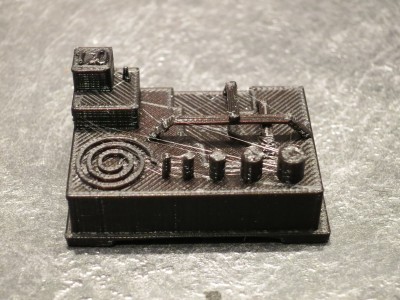

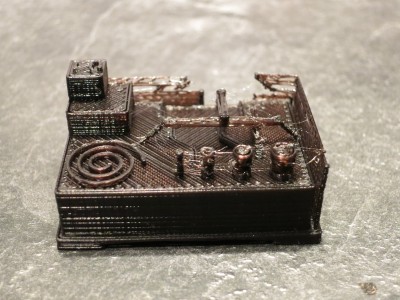

I wanted to try different slicers to see what I could come up with as I was having some stringing problems with my prints. It led me down a bit of a learning path in regards to seeing just what the programs do differently. I tried to set up all three programs (KISSlicer, Cura 14.02RC1, and Slic3r 1.0.0RC3) with as similar settings as I could get them and printed the "Slicing Engine Torture Test" http://www.thingiverse.com/thing:64549. I wasn't looking for anything as particular as a 'torture test', but this seemed to have some cylinders, hard corners, bridging, sloping, thin walls, etc. that I thought would be a decent test. I ended up scaling it down to 50%. I wanted to try and see what the programs would do for any finer details that might be thrown at it. Please keep in mind that I'm sure there are a LOT of people who have each of these programs fine tuned and running much better than I have got them going here. Again, I just wanted to see what each would do with the same settings. Maybe someone else could learn from it.
First was KISSlicer.
Tested using KISSlicer
There was a thin wall on the back of the print that barely printed. It was full of holes and had partially collapsed. The cylinders up front were hardly standing in some places. It was as though chunks were missing from the sides for some reason. Nearly half way through the cylinders in some areas. It didn't matter if it was small or large either. The pilars leading up to the bridge were not pretty. Neither was the bridge itself.
I'm not too sure why, but throughout the entire print, the outside perimeter has a small gap to the next one in. It's evident on the cylinders, squares and on the base that the object is sitting on. I don't understand why this happened.
There is a '1.0' written on the peak of the print, but KISS decided to omit the '.' and the bottom of the '0'.
Next up was Cura.
Tested using Cura
Tested using Cura
This one actually turned out very nicely. No gaps, the numbering on top was complete, the cylinders had no holes or anything, the bridge was MUCH cleaner. It even printed the tiny cylinder just below to the right of the '1.0' which was missed completely by KISS. However... it decided to leave out the thin wall along the back and side completely. I suspect that maybe the software decided it was too thin? Whether it be the extrusion width setting or the nozzle size, I'm not too sure yet.
The spiral on this one wasn't the greatest compared to the other two. It came out much wider and flatter. Also, wherever there are 90 degree corners, they seemed much more rounded than with KISS or Slic3r. Overall, this one came out rather decent I thought.
One other thing that I couldn't seem to find in Cura was the infill pattern. I checked in Expert settings and stuff and nothing. Perhaps someone could help if there is a setting for it. It made me sad that I couldn't find one.

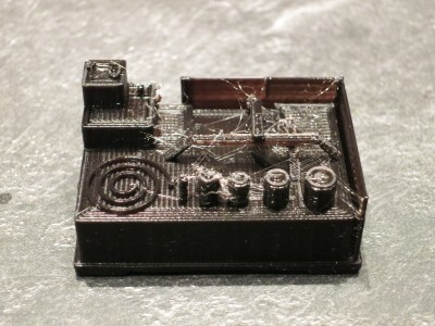

Last was Slic3r.
Tested using Slic3r
Tested using Slic3r
With Slic3r, it at least tried to print everything (except the '.' in the 1.0). It got the back wall and the tiny cylinder on the first square block. The spiral pattern was nice and crisp and the walls were good and thin. The pillars leading to the bridge were excellent and the bridge was so-so. A bit of sag on the first span then the rest went pretty straight. The row of cylinders turned out pretty decent as well. As with KISS, there was a bit of gap in some areas between the outer perimeter and the inner, but it seemed to be primarily isolated to the larger square.
My biggest beef... the stringing. I went through the layers and looked at the paths in Repetier and Slic3r made (by FAR) the most movements. KISS and Cura seemed to be a 'let's go here and here and here... next layer - repeat'. Slic3r was on crack. Tool paths everywhere (and no, random was not turned on). On every single one of my prints where the hot end has to move too far, it leaves strings. I've tried all different speed, retract settings, wipe, etc. but I just can't seem to get ahead. Right off the bat with this test, KISS and Cura had MUCH better results in regards to the stringing.
