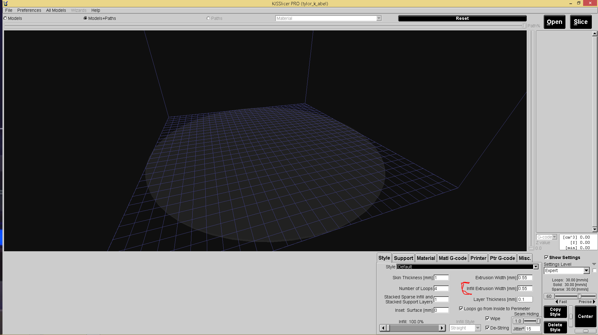

i use kiss but you should look for a setting that control infill extrusion width. or try slicing in a different program

Kisslicer on the other hand has never had any infill gap of any sort... as well as the other bonuses that Kiss offers. I just don't think slic3r handles filament flow very well at all...
