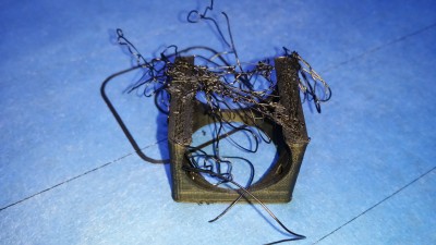

So I stayed up till 1am last night waiting for a print to finish (the fan shroud for my brand new E3D V5 extruder - YAY!) and so I was just watching a show and not watching the printer. Well... it evidently got to about 75% and the PTC fitting at the EZStruder decided to let go. When I later looked at the bowden tube, it looks like there was a defect in the connector as there was only 3 little points where the metal was holding it (the metal piece also fell out of the fitting). It wasn't a complete ring holding onto the tube. I guess I'd just been lucky up to this point. I thought maybe the hot end jammed, but I pushed on the filament by hand and it pushed easy as pie.
I took a picture of the tube having come detached and then the filament just looping in the air beside the EZStruder, but for some reason it turned out like I was taking a picture of bigfoot. Super blurry.
Filament sputtered out and was printing dry in the air for about 1/4" (probably 20 minutes)

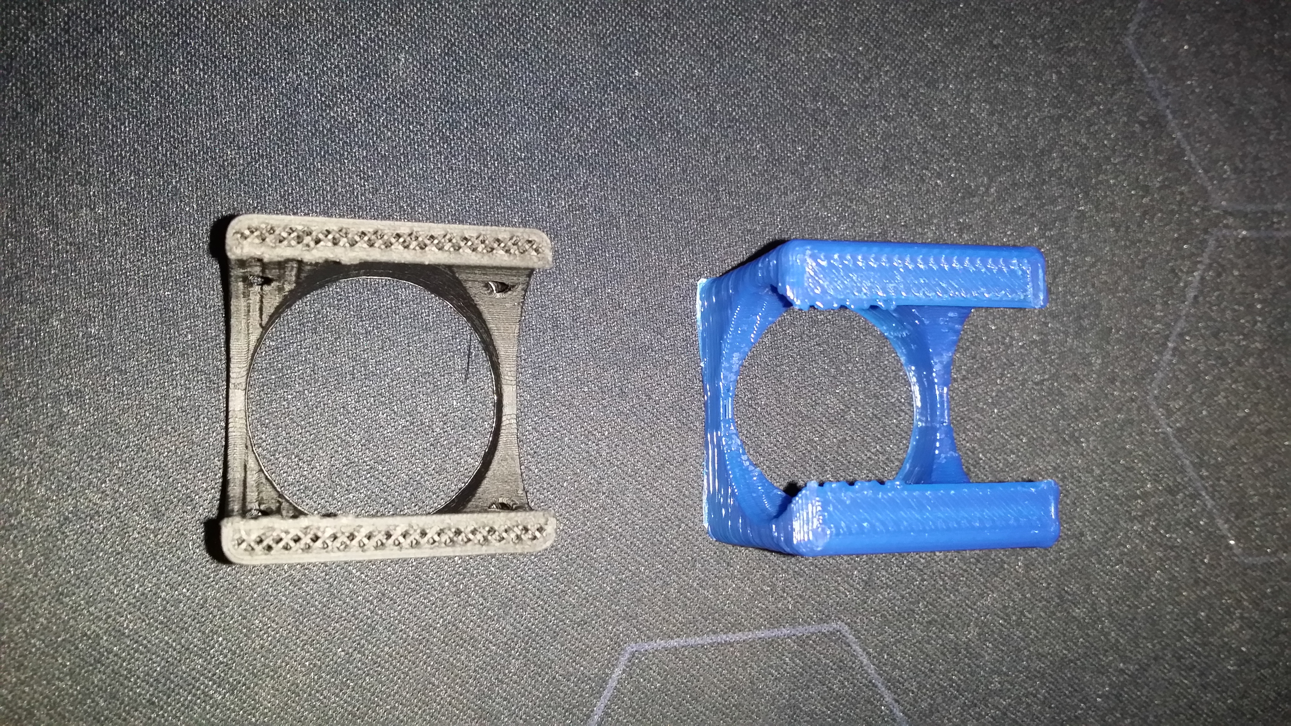

The hot end came with a fan shroud, but I wanted to print my own to keep the 'black' look. I wish the picture could do it justice; this was the smoothest print I had made to date. It was also my first attempt ever at ABS. I thought PLA was the bees knees having never used ABS... I now see it can make some awesome prints. I had a pretty decent issue with stringing with PLA, but there's not ONE tiny hair or bump on this ABS print.
Looks much smoother than the 'stock' E3D print, but I was obviously using a much thinner layer height

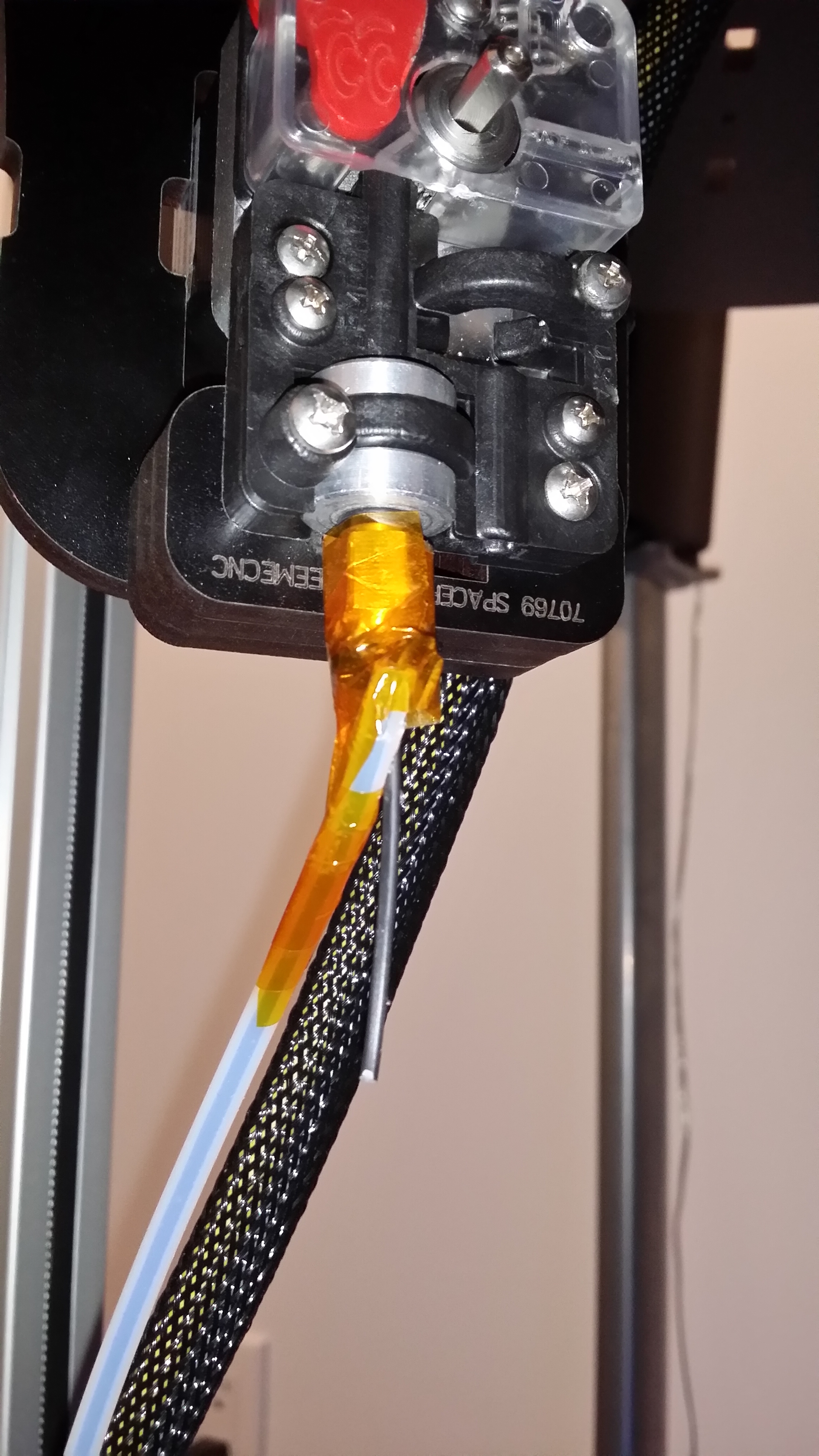

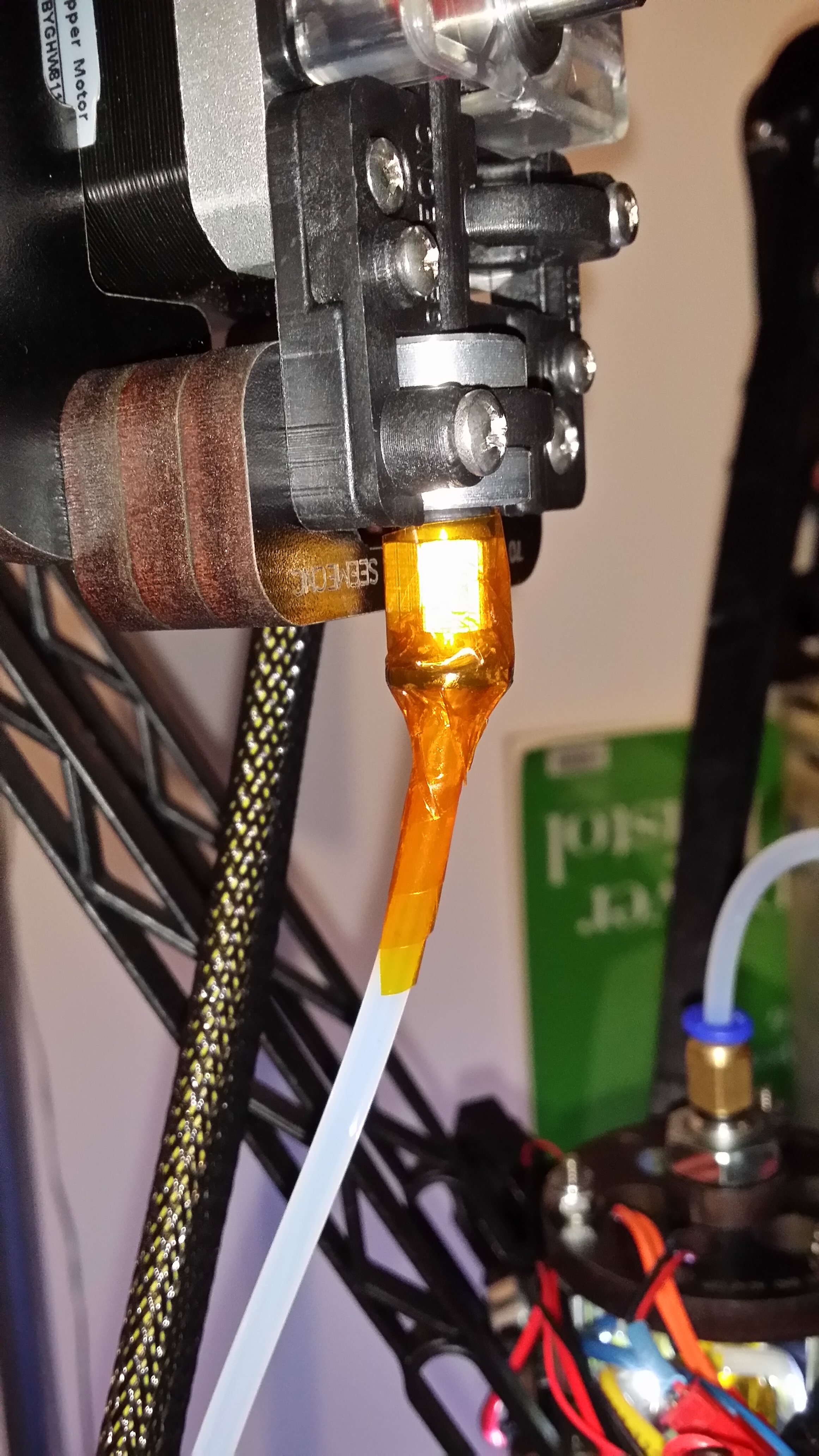

Well. I got about 15 minutes into trying that print again with my fancy-dancy patch up job... but alas... it too failed.
Glued and kapton taped.
Maybe I am experiencing jamming.
Glue didn't stick to either the tubing or the plastic in the fitting. Kapton broke and it snapped the ABS filament.

try some heat shrink tubing, then tape te heatshrink and the existing tube to help it from sliding, until you get a replacement fitting. Some hardware stores may carry it.
