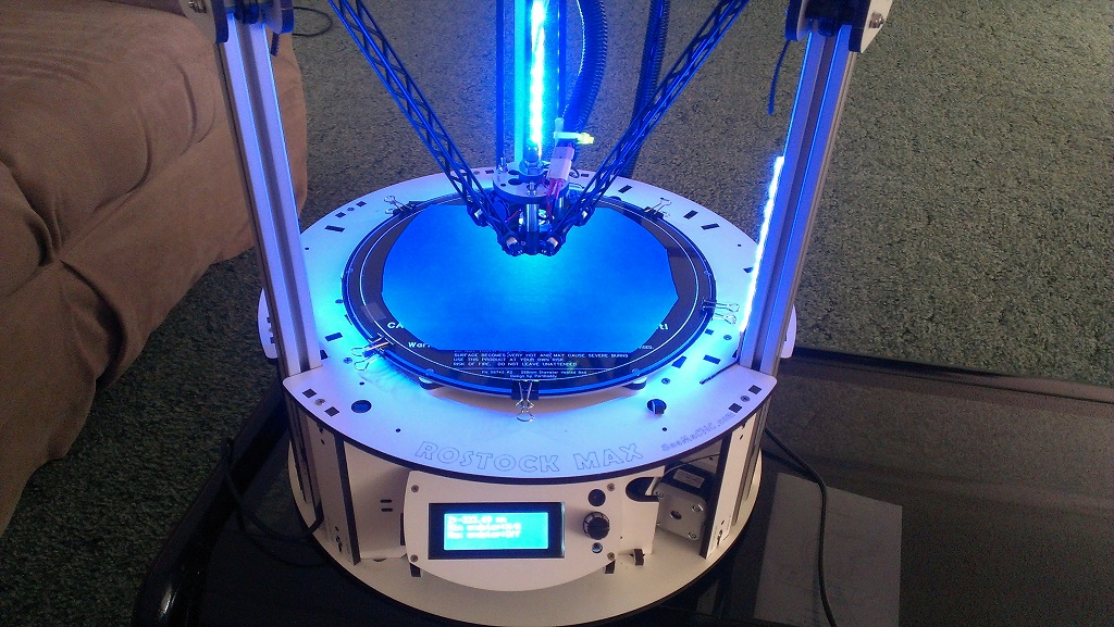

On a side note added some LED's

Nice build by the way. I like the blue LEDs. They don't interfere with the cheapskates?

Yea but they do a number on your eyes, I may as another set which is white on the other side of the extrusion, and I can have a switch for white and a switch for blue.

There is no interference with the cheapskates?

None the LED's are 6" long I think the cheapskates do not travel down that far.
