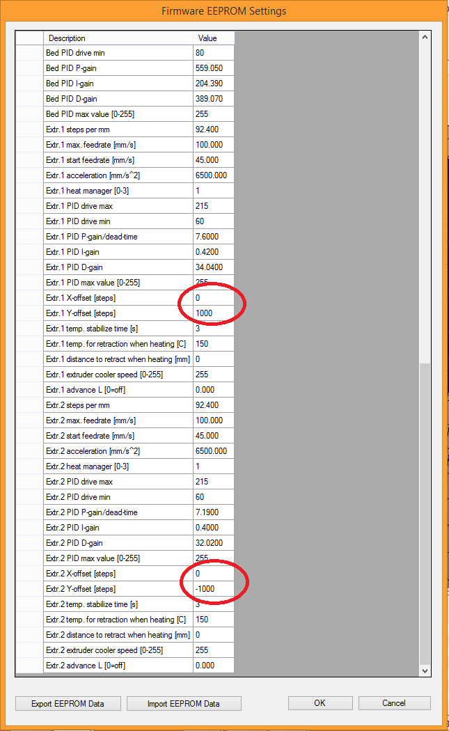

Re: dual e3d
Thank you for posting the files. This is the best setup I have seen and certainly better than anything I have
seen on Thingiverse.
Re: dual e3d
What is the offset value you used?
bubbasnow
Posts: 1061
Location: Dayton, WA
Re: dual e3d
Post by bubbasnow »
i set the offset in eeprom, if you align the nozzles with the y-axis there is no x offset.

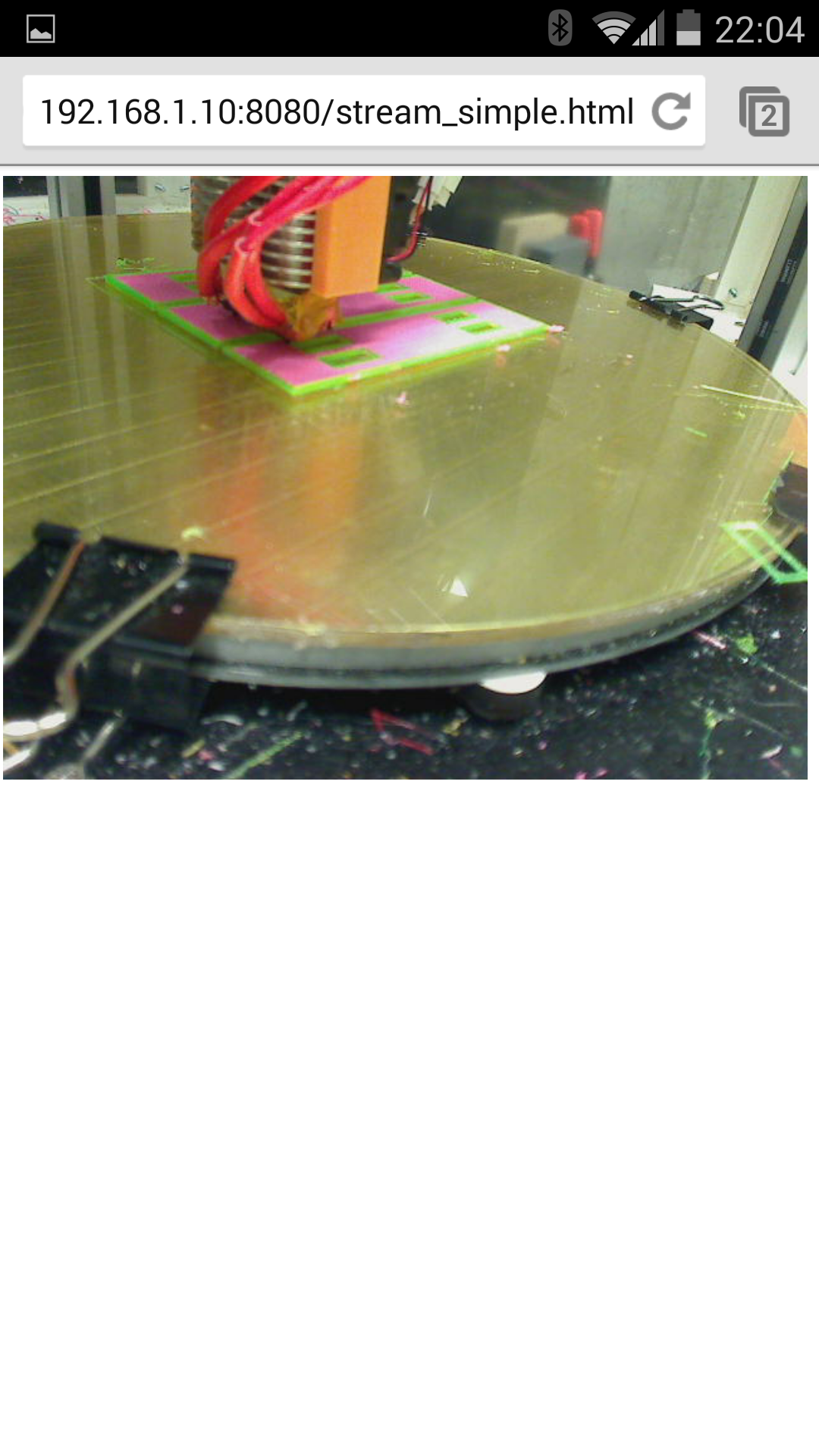

here is something i made real quick to test slic3r
[img]https://lh4.googleusercontent.com/-GA8F ... -no/14+-+1[/img]
Re: dual e3d
I'd say you have your dual extruders working well.
Excellent job!
bubbasnow
Posts: 1061
Re: dual e3d
Post by bubbasnow »
Printing some stuff
Sliced in s3d
