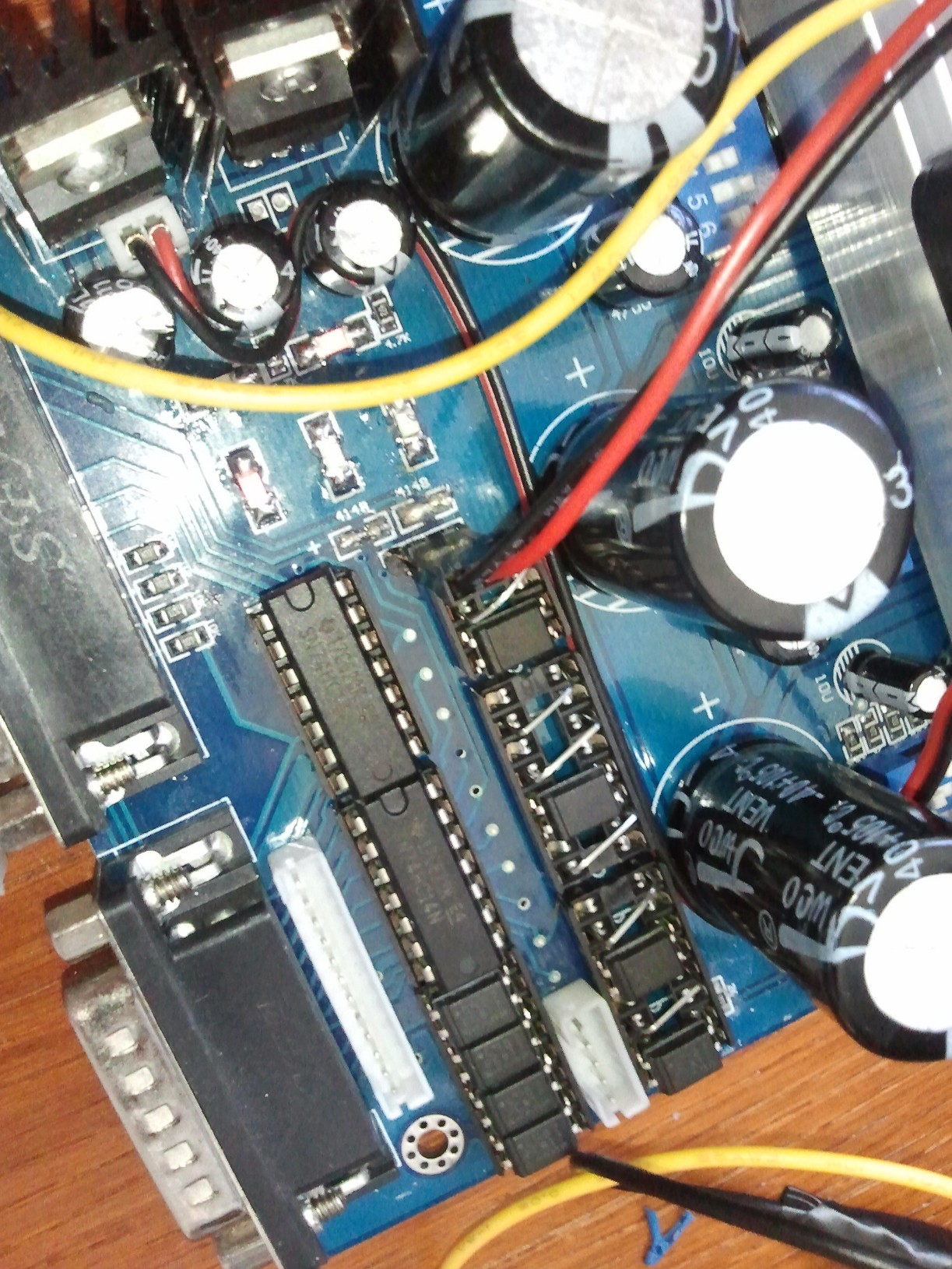

Ok... So I feel that I have wired this thing correctly... But I can't get it to move at all... What do I need to doubel check ??
I thought I had my motors hooked up properly but maybe not... I have Wantai 42BYGHW811 steppers with 4 wires - Red - A+ / Blue A- / Black B+ / Green B-
I can here a slight hum when it is on and everything is lit up but I get no response from the machine when issuing commands in Mach3....

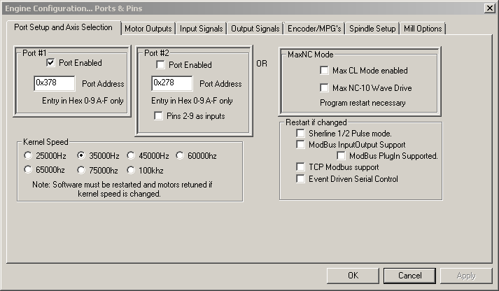

Also, make sure your parallel port is configured properly in Mach. I saw an old config file that was incorrect. Where did you get your config and did you verify everything?

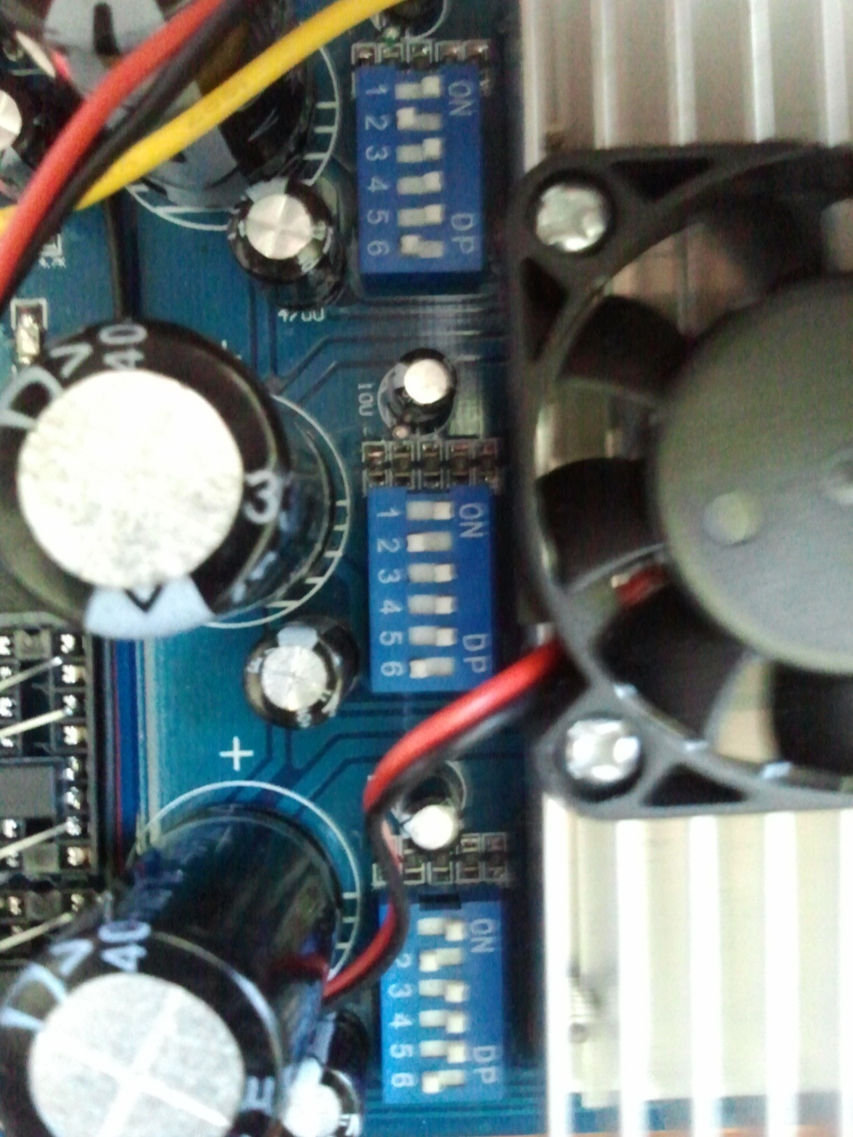

Re: HELP!!
Did you do the opto isolator mod to the 3 axis board? If so, you might not have steed the jumpers completely. We now know your wiring from the connector to the motors is ok - at least to energize the motor. But, Y, Z and A ports are not getting power. That might well be a mach pin configuration issue. You need to double check the Y, Z and A axis pin configuration and make sure they are on Port 1 (if that is the parallel port you are using, it usually is) and are enabled. Some screen shots from your end would help too.
Michael
Michael
Re: HELP!!
Its a little hard to tell but your 2nd photo looks like the staple jumpers are off in a few places. Make sure they are in the correct places - use the drawing in the H-1 Electronics Manual. Also make sure they are seated well, the staples are very thin and not easy to get a firm grip. I ended up using little wire jumpers because of that. I am betting that it is in the jumpers - either not in the right place or not making contact properly.

So I replaced with some solid core wire and no change... Also I tried putting the chips back in and no change... Only the X axis is responding... What am I missing what else could cause this...? I am on deadline to get this project done so any other ideas are really appreciated... the glowing red lights to the left of the opto chips are they all supposed to glow when everything is on because the two direct beside where the diodes i removed and bridge the contacts are not glowing but the rest are...?

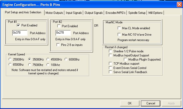

Re: HELP!!
They glow when the axis is jogged. Check your Mach pin settings, how do you have it setup?
Re: HELP!!
It is critical to get Mach setup correctly. Just as critical as all the wiring be done correctly. You have to answer questions if you want help with troubleshooting.
Post some screen shots of your settings screens.
That should help us eliminate Mach 3 and get to the wiring. There are so many different causes for problems like this, in order to have good help, you have to have good reply's. No other way around it. That is unless you catch the mistake yourself.

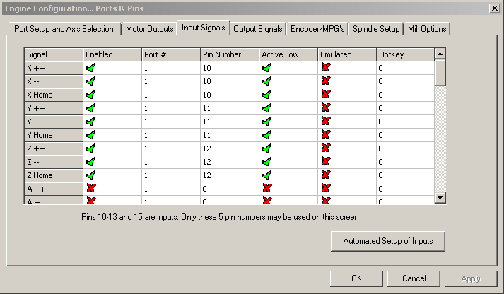

Re: HELP!!
Do you really have all the limit and home switches installed. If not then deselect them so they are not causing problems.

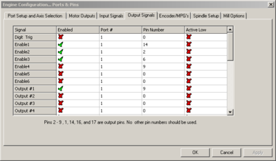

Re: HELP!!

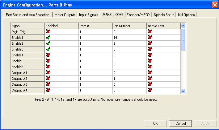

Ok, see this: http://xa.yimg.com/kq/groups/80652411/s ... utputs.jpg
You do need to setup the A drive as shown. Also Dir LowActive as shown. Ports look fine, pin configs are correct. I am not sure about the Enables as I'm running the 4 axis board. Maybe someone can pipe in with their Enables pin #s.

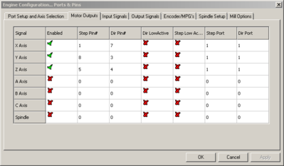

Lee got it. The reason I first asked you to test each motor on the "almost working" X axis port was to test the wiring and connectors to the motor. You have verified that those are all good so the issue is now upstream from that. I still think you have a Mach configuration problem. I am still trying to get a known working Mach config from someone to put in the electronics doc and make screen captures. I've moved to a 4 axis board which is very different and don't have the time to go back.
It sounds most like an enable setting. Even if the did/step pins are reversed you would still get an energized motor.
Lee also has good advice about the parallel cable! I've been bitten more than once by bad cables. You can test the pins at the end of the cable with a volt meter. Do you have one? We can also check the signal that Mach is sending at the cable. That will pinpoint a Mach config vs a 3 axis board problem.
Here is the parallel port pin assignment:
[img]http://image.dhgate.com/albu_140646897_00/1.0x0.jpg[/img]
Your working X axis has: step pin 1, dir pin 7. If you connect your voltmeter set to read volts on pin 1 to the ground pin 25, and then jog the axis in Mach, you all see a signal on the voltmeter. DO the same on the dir pin but now you need to reverse direction in Mach (by alternating pressing the left/right arrow keys quickly). Once you have validated that you are indeed seeing the signal and are comfortable with that, we can move on to test the other axis:
Y - step pin 8, dir pin 3
Z - step pin 5, dir pin 4
A - step pin 16, dir pin 17
Make sure you know which keys to push for each axis as I described in the previous post.
So, let's take a scenario. If you test Y step pin 8 with your voltmeter and do not see a signal when jogging, you likely have a Mach configuration issue. If you do, then double check your port connections on the 3 axis board. If that doesn't fix the problem, then there is a problem with the board - either the opto jumpers are messed up (but you reinserted the chips so that does not seem likely) or the board is bad. Call Steve and John.
If you have a Mach configuration issue, then we need to figure that out. Did you disable all of the homing and limit switch configs on the Input Signals tab as Dave mentioned?
You do have your enable pin settings on the Output tab set properly though. Can you post a screenshot of the general configuration screen. If this configuration is verified and does not work, then you may have a bad parallel port or bad cable.
