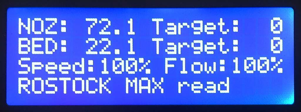

Just finished the printer construction today and have been very careful about the electronics and static... Was concerned when I turned on the printer for the first time and it already had firmware running... thought it was supposed to be blank.

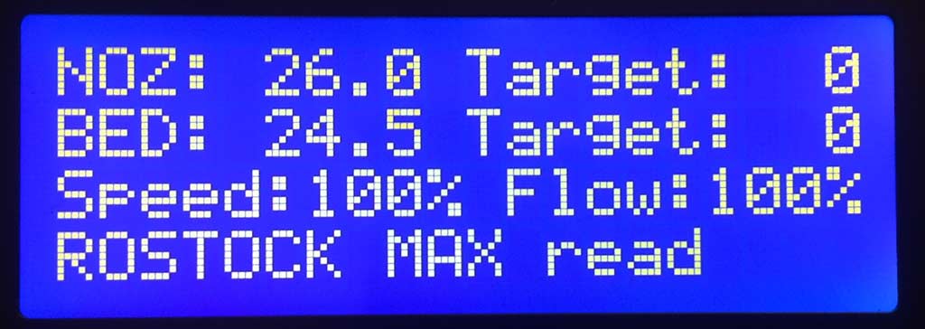

I just finished putting the meter on both the bed and hot end by connecting the meter to the 2 wires that plug into the RAMBo. I used a hairdryer to heat up both parts (separately), and both gave the same immediate results. The meter started counting down from apx 94.7. Once I turned off the hair dryer and let them start cooling, the number began rising again back to around 94.7.geneb wrote:It shouldn't short out if the tiny ptfe tubing is properly seated. It's possible that you got a defective thermistor - it happens sometimes.
Doesn't this indicate that the thermistors and all wiring/crimps are ok and it is something with either the RAMBo or something else?
I'm out of ideas.

Must be a bad RAMBo... Made the change you gave above and here is the result, minus the def/0 and extruder 0: temp sensor defect message in Repetier.
Thanks for saving my sanity!
Bed is heating up in Repetier, but the hot end is not... at least it sees it now, must be more wrong with the RAMBo than the t0 pins...

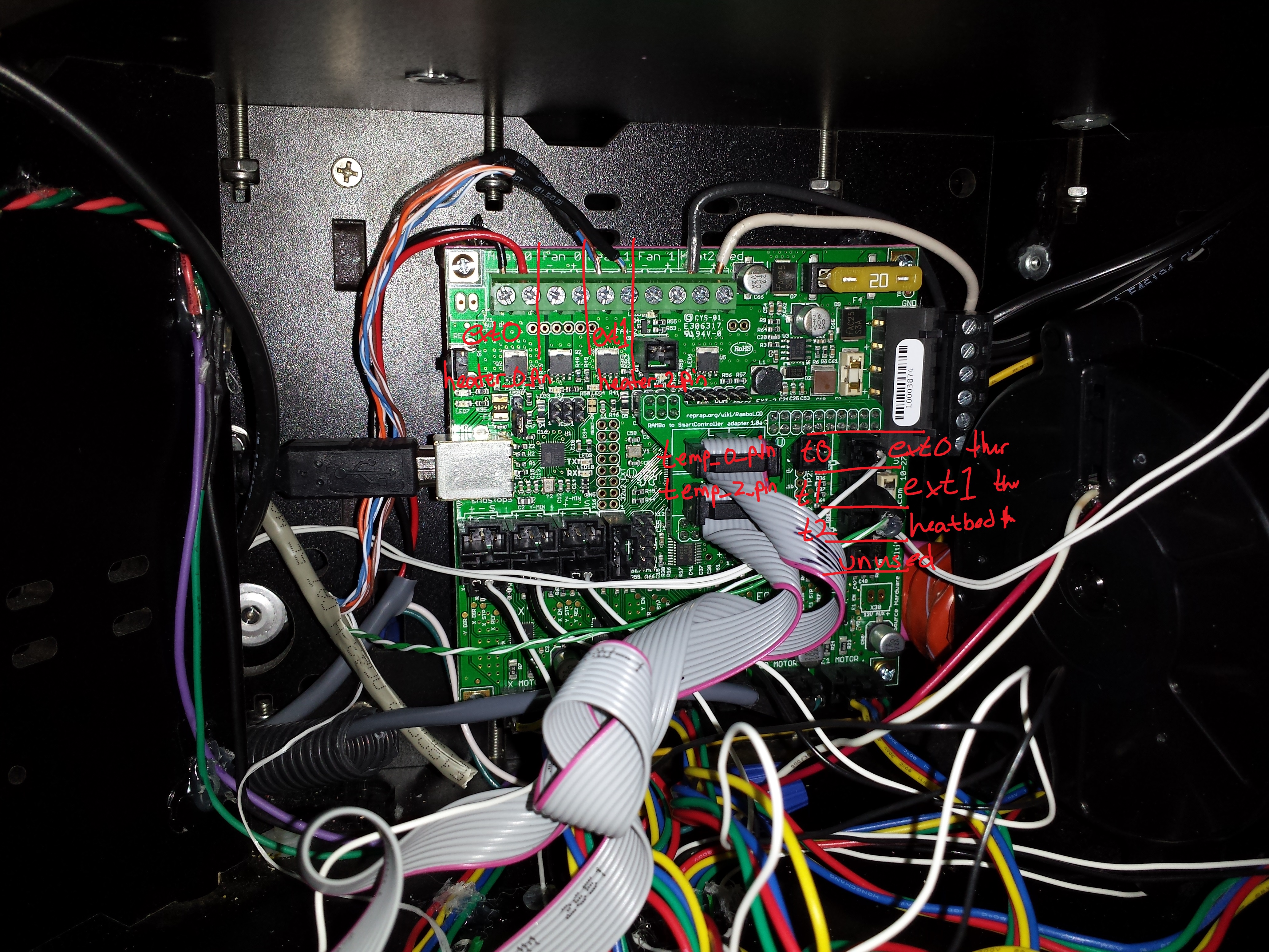

Re: Rostock V2 thermistor fail
ok so attached is my rambo, ive written on it with my current setup.
on the top you see ext0 wired into heat0, on the right you have its thermistor wired into t0 on the board which is heat_0_pin in the firmware.
we think that something in your t0 is messed up on the board so we want to hook your thermistor for ext0 onto t1 which is heat_2_pin in firmware.

Just finished completely re-wiring the hot end itself with a new quick release. Either my moving it around or excessively taping it this time worked! Got a good temp reading and the PID auto tune is working on t0 like it should. Thanks for all the suggestions and your help!
