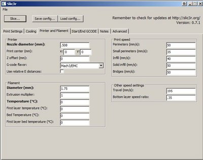

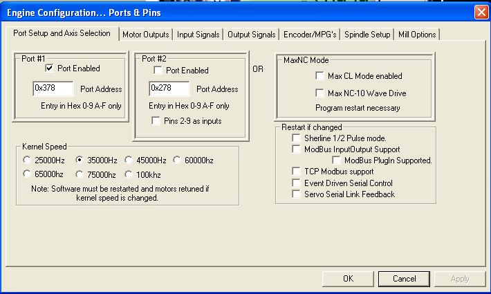

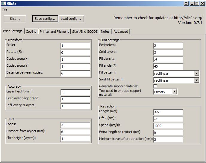

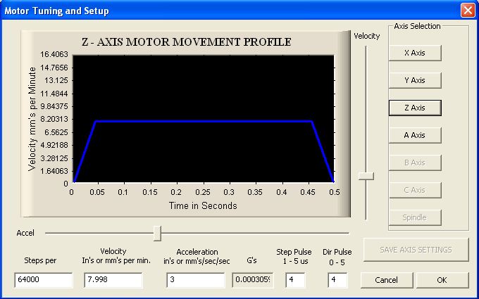

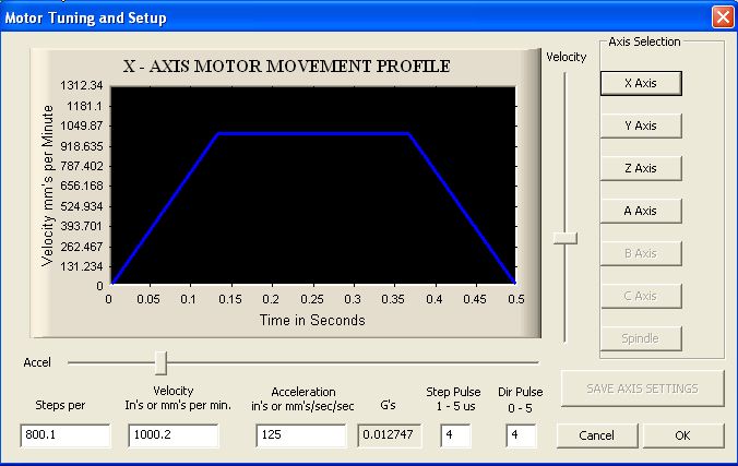

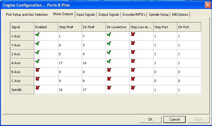

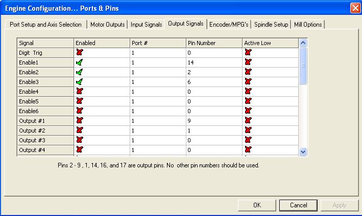

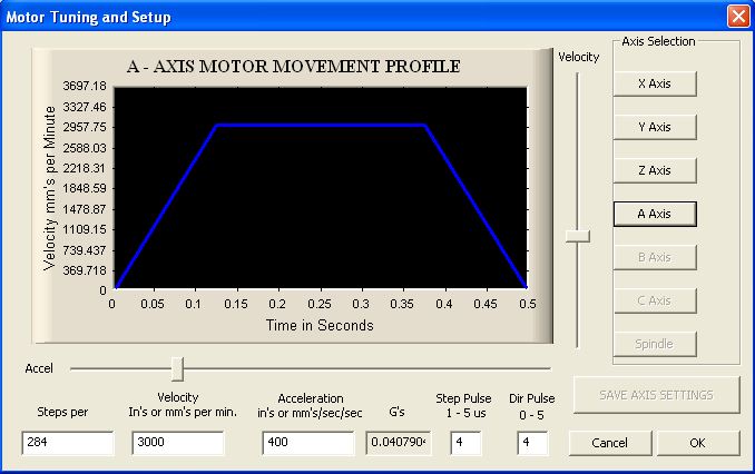

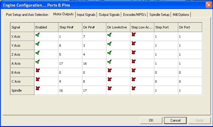

I posted these in another post but I thought I would get a thread going here so that we can all compare settings.
For the record: 1.75mm ABS
3 axis Chinese board with easydriver on the extruder and heated bed.
Share your configs!

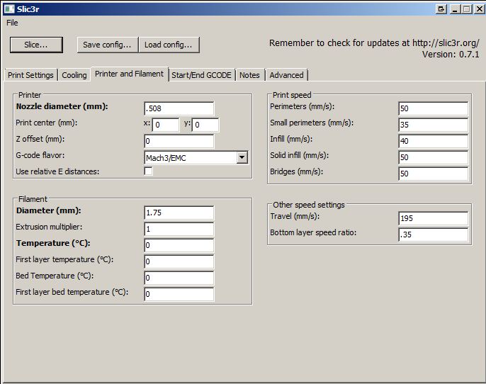

I am using Repetier Host with slic3r 0.7.1 (internal to Repetier Host), my slic3r settings are here along with my settings for Repetier Host
http://forum.seemecnc.com/viewtopic.php?f=31&t=33
