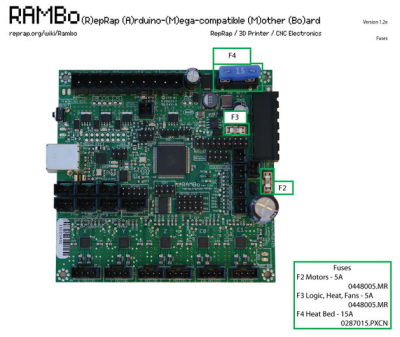

Turns out there are 3 fusses on the RAMBo v1.2 controller. There is 1 large 15 amp and 2 small NANO2 fuses.
I set my multimeter to continuity and tested both fuses and found the F3 had blown!
The F2 (NANO2 fuse) = is for the Motors.
The F3 (NANO2 fuses) = is for Logic, Heat, Fans.
The F4 (large fuse) = Is for the Heat Bed.
I switched the F2 and F3 fuse and got my LCD display working (and I assume everything else on that circuit).

Re: Printer Stoped Dead - RAMBo Board Died?
from the Rambo RepRapWiki:
It is different from the picture you displayed... maybe a difference in versions ?Rambo RepRapWiki wrote:F2 supplies the motors and on-board power supply.
F3 supplies the extruder heater and fan outputs.
F4 is a 15A ATO (the type found in many automotives). F4 supplies the heated bed output.

I got my info and Pic from the same RAMBo wiki : )enggmaug wrote:from the Rambo RepRapWiki:It is different from the picture you displayed... maybe a difference in versions ?Rambo RepRapWiki wrote:F2 supplies the motors and on-board power supply.
I believe I have a RAMBo v1.2
http://reprap.org/wiki/Rambo_v1.2#Fuses
