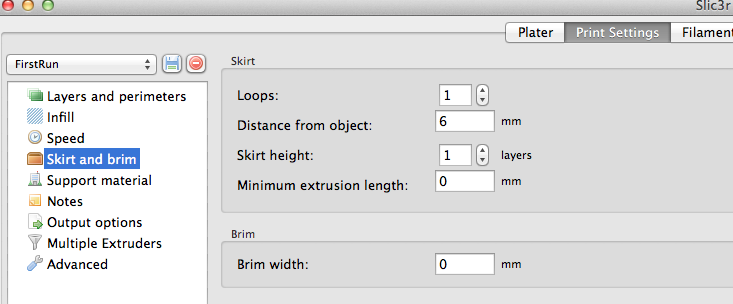

New to printing and just got my Rostock V2 last week. I can print the fan shrouds and things like cubes just fine. If I try to print things that are more intricate, such as a chain, the printing gets about a quarter of the way through and the hot end starts to hit the object and will knock it loose and off the bed. When the hot end moves to print in another area, it appears it is not moving up high enough and strikes the object.

Maybe it would help if I clarified the issue a little more. I'm trying to print a 5-link chain. The print starts fine, beginning with 5 separate pieces. The hot-end will print to each individual piece, moving from one to the next, then repeat. After a short amount of time, the hot-end will strike one of the pieces and will knock it loose. This happens once the 'flat' printing has completed and it begins to print on the edges of each piece as it builds each link of the chain. It's appears the hot-end is moving from piece to piece at the same level without moving up slightly to clear the next. Hope that makes sense.

In the Mac version of Slic3r, look in "Printer settings" - "Extruder 1" and set the "Lift Z" to like...1mm. You should see the hot end lift a tiny bit when it retracts and moves to the next starting point. Hopefully missing the previously printed layer.
The other thing I would do is print this with a "brim". In "Print settings" - "skirt and brim" set it to like...5mm. It should print a five line silhouette of the part, attached to the first layer. You should be able to snap it off pretty easy upon completion. This will really help the part stick better. And give it some stability, if it doesn't have a large "footprint" to begin with.

Awesome! Thanks, that has corrected the issue. I've tried to use the Mac version of Repetier, but I haven't been able to get it to connect to the printer. I selected the usbmodemfd1311 in the Printer Settings but it doesn't respond. There isn't any drivers, correct?
