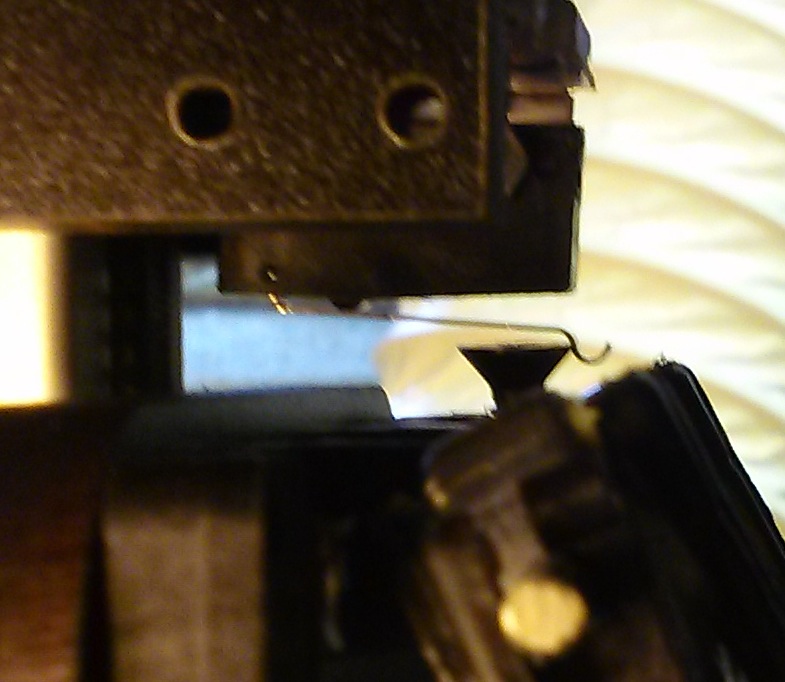

I've discovered a problem with the end stops on my Rostock MAX v2. On my Z tower, when the end stop screw contacts the end stop switch's lever, they touch at an angled part of the lever:
Factory end stop switch lever, installed, with end stop screw precariously on curve of lever
Any wobbling of the screw from side to side significantly changes the height where the switch actuates. This means that turning the screw a given amount will change the end stop position in unpredictable ways. Sometimes it will even move in the opposite direction you expect.
This probably happens on this tower because of the exact geometry between the switch and the Cheapskate; it could have happened to any (or all) of my towers. To check if this is happening to you, fire up Repetier-Host, connect to your printer, and switch to the Print Panel. Home All, and then adjust the Z axis up slowly until the switches activate and motion stops. Then look at how the screw contacts the switch lever. If it's contacting on that initial curve on the end of the lever, then wobbling of your end stop screw can cause trouble.

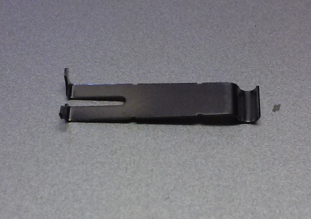

To fix this, I decided to flatten the ends of the switch levers. The switch levers are relatively easy to remove; they have a forked end with points that fit into divots in the body of the switch. Just gently squeeze the fork with needle nose pliers and they'll rotate out:
Factory end stop switch lever, top view, with attachment fork on left

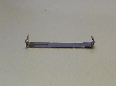

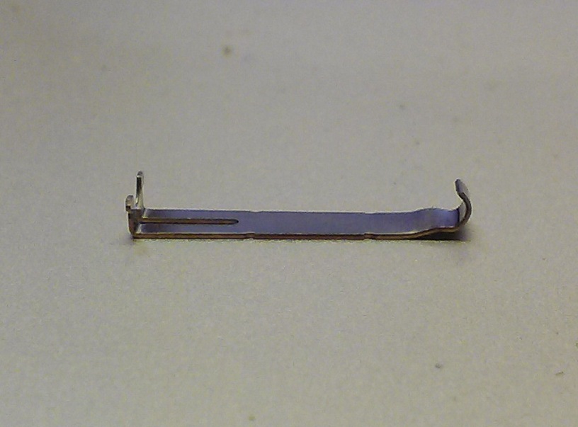

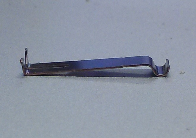

A side view shows the curve at the end which is the problem:
Factory end stop switch lever, side view, with contact curve on right
Use pliers to flatten this end, being careful not to distort the rest of the lever:
Fixed end stop switch lever, side view

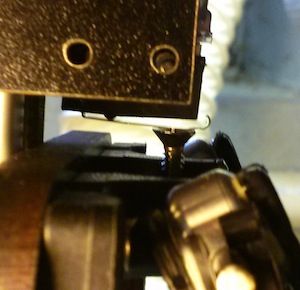

When you reinstall the lever, you'll find that you have a much broader contact area between the screw and the lever, so sideways wobbling of the screw won't matter any more:
Fixed end stop switch lever, installed
