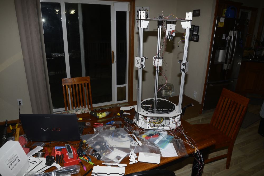

So here is where it stands after about 10 hours of work:

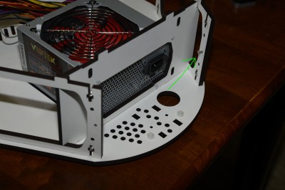

In the supports that go between the base bottom and top there are some flat head screws that are not screwed in all the way on purpose so the smoked plastic can grab on them.
your manual says to install them that way, and then the pictures in the manual don't have them. I took pictures of the same angles that include the missing screw.
This would be a new Fig. 4-11
https://www.dropbox.com/s/ty2gz0yckdclgmv/_6001406.JPG
This would be Fig. 4-12
https://www.dropbox.com/s/chrqk6vqgnebhqq/_6001407.JPG

Here is the photo attached. This would replace fig. 4-11 in the manual

Actually for the screw naming, up on page 15 where it is going through the packing list, the are correctly called
#4, 3/8” Phillips Pan Head Sheet Metal screws.
Then later on page 43 they are called #4, 3/8” Stainless Steel Pan Head Machine Screws (3)
I am pretty sure those are the same part, and they are sheet metal screws not machine screws.
I think they are referred in a few other spots as a machine screw.

Looks like you've made a fine mess of that kitchen table. I think it's impossible to have a clean area when building one of these things.
Re: Tonkabot's Max V2 Build
I was thinking that a large percentage of these things get put together on the kitchen table. The office is already full, and the basement shop is already cluttered.Tinyhead wrote:Looks like you've made a fine mess of that kitchen table. I think it's impossible to have a clean area when building one of these things.
I built mine on the kitchen table chair , next my desk.

The photos are difficult to switch out once they've been formatted and it screws up the layout of the following pages until it gets fixed. A photo replacement has to be _really_ critical for me to want to go through that.
The effort IS appreciated though.
As I said before, the installation orientation of the Cheapskates was explicitly spelled out a few weeks ago. I also updated the section that described the top supports and showed what the "new" shape looked like at the same time.
There's really no excuse for leaving those screws out because I cover their installation a few pages prior and the orientation instruction is highlighted in yellow. I could understand if you're only going by the photos, but that's the reason for the admonishment to read the whole text - the photos don't tell the whole story.
Note that while it *sounds* like I'm busting your chops, I'm really not - asshole is my default state and I'm not a very good diplomat.
