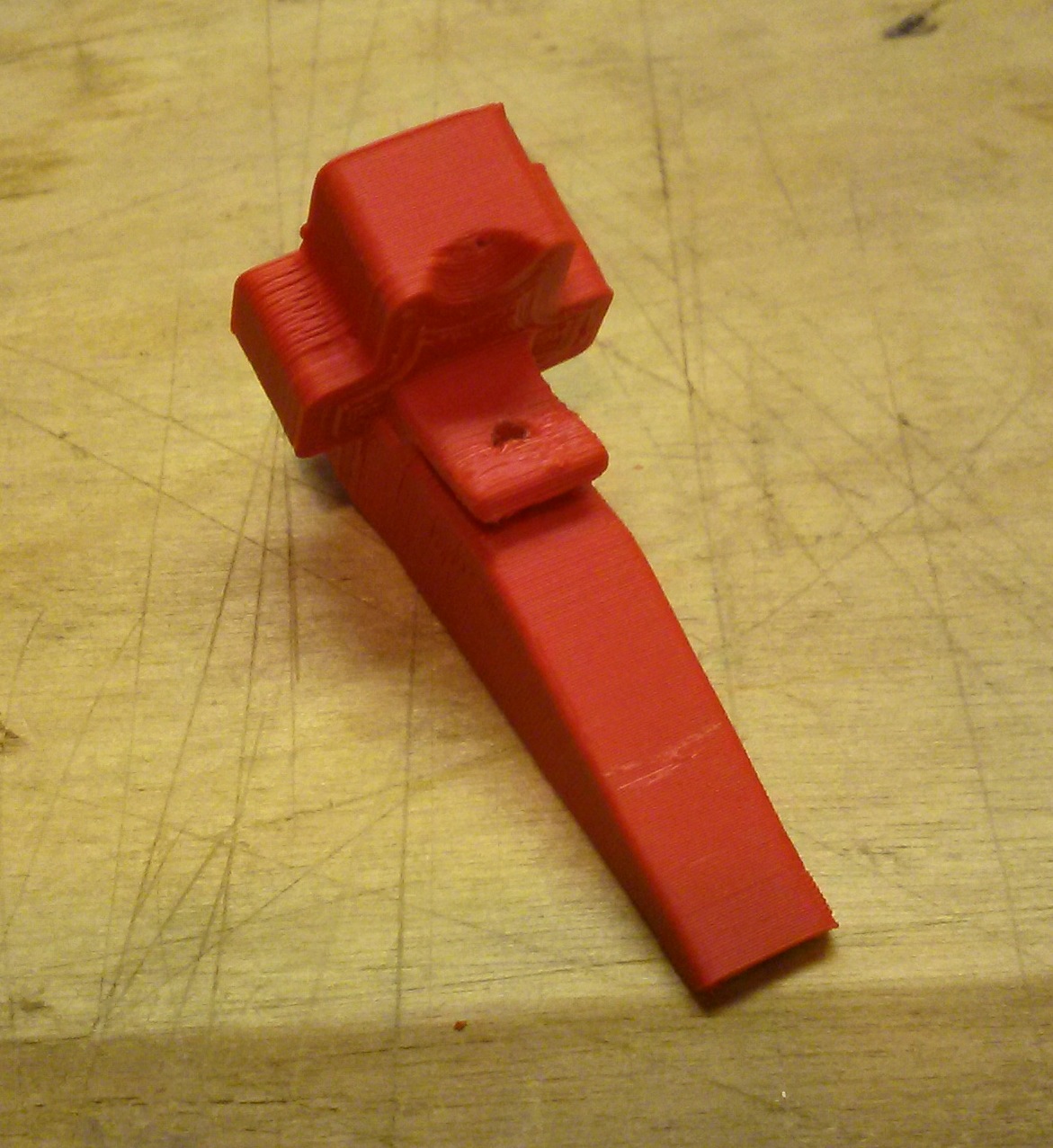

Well, I finally solved it by reworking John Olaphson's housing using OpenSCAD. I wrote a script that imports his STL file and does the following:
  1. Makes the fan slot 1mm wider and taller
  2. Adds some clearance above the mounting screw so that a screwdriver can more easily get to the mounting screw

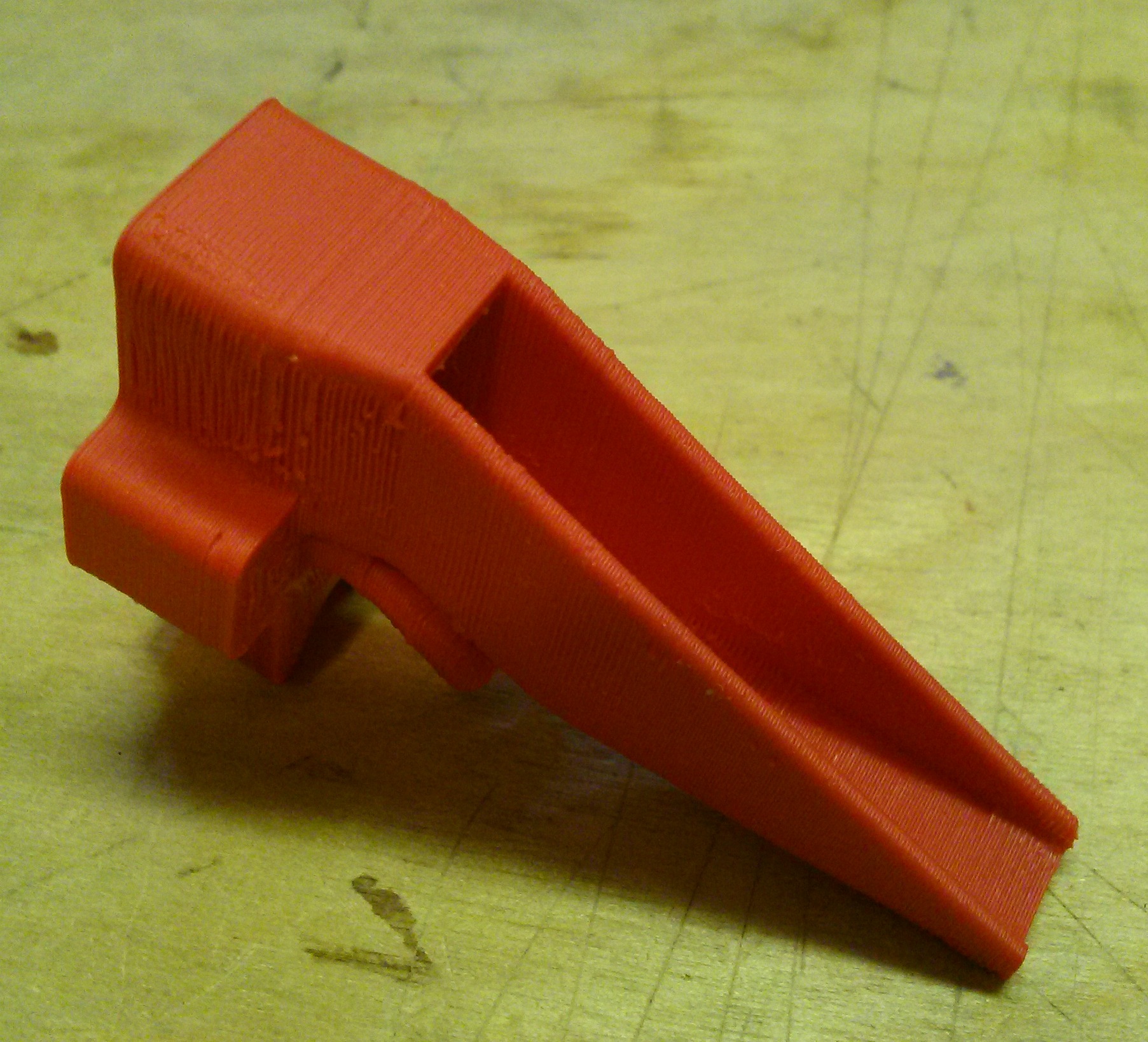

  3. Added a bit of wall to better guide the air exhaust towards the part.
Here's the OpenSCAD code. It takes Oly's design, subtracts a cube to make the fan slot larger, subtracts a cylinder to add the screwdriver access, and then adds a plate to better guide the exhaust:
Code: Select all
extraHole = 1.0;
fanX = 30.3 + extraHole/2;
fanY = 10.3 + extraHole/2;
difference() {
	// Import original fan shroud
	import("./NEW2-Guanu-Blower-Fan-Holder-Shroud.STL");
	// Cut a slightly larger slot for the fan
	translate([16.7 - fanX/2, 11.6-fanY/2, -21.5])
		cube([fanX, fanY, 30]);
	// Cut out clearance for screwdriver access to the mounting screw
	translate([0, 11.6, 13.5])
		rotate(a=60, v=[0, 1, 0])
		cylinder(h = 10, r=5, center=true, $fn=60);
// Add a bit more guidance for the fan's exhaust
translate([32, 6.5, 8.4])
	cube([1.3, 10.3, 7]);
