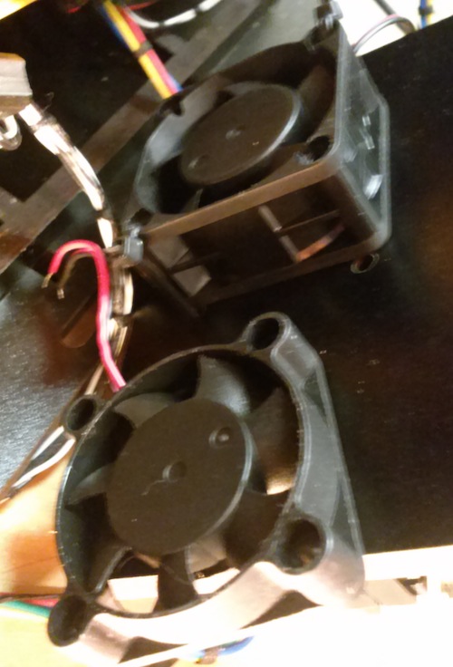

  4. Replaced the RAMBo cooling fan with a much quieter one. The original fan was noisy with a nasty whine, substantially louder than the PSU or PEEK fans. I replaced it with a Scythe Mini KAZE ULTRA 40mm fan from Amazon for $6.84 (free shipping):
    New RAMBo cooling fan, with original fan in foreground
    It's twice as thick as the original, which makes installing the RAMBo slightly more fiddly, but it is a WHOLE lot quieter. I can barely hear it over the PSU and PEEK fans now.

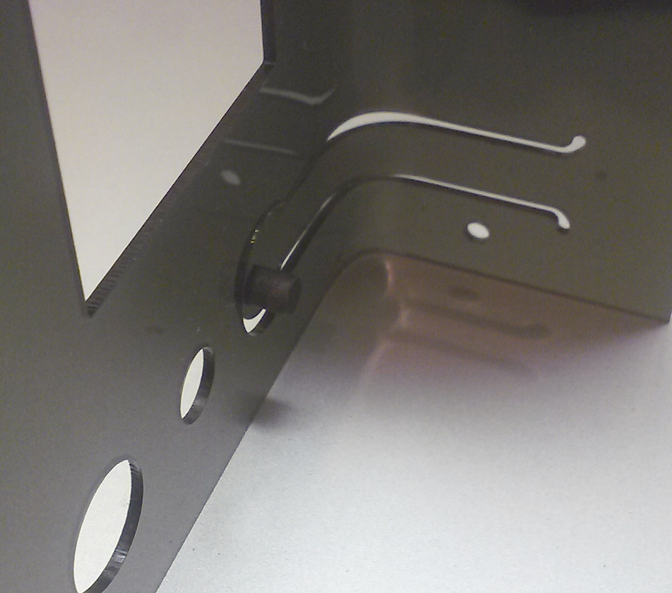

  5. Added an extender to the reset button on the LCD front trim panel so that you don't have to press the trim panel tongue in 1/4" to get any results. I used one of the cylindrical leftovers from the Melamine sheets, trimmed a bit shorter and SuperGlue'd to the tongue on the trim panel. Be careful about positioning; you need to put it further towards the end of the tongue than you think. The results are good, with a nice positive snap action:
