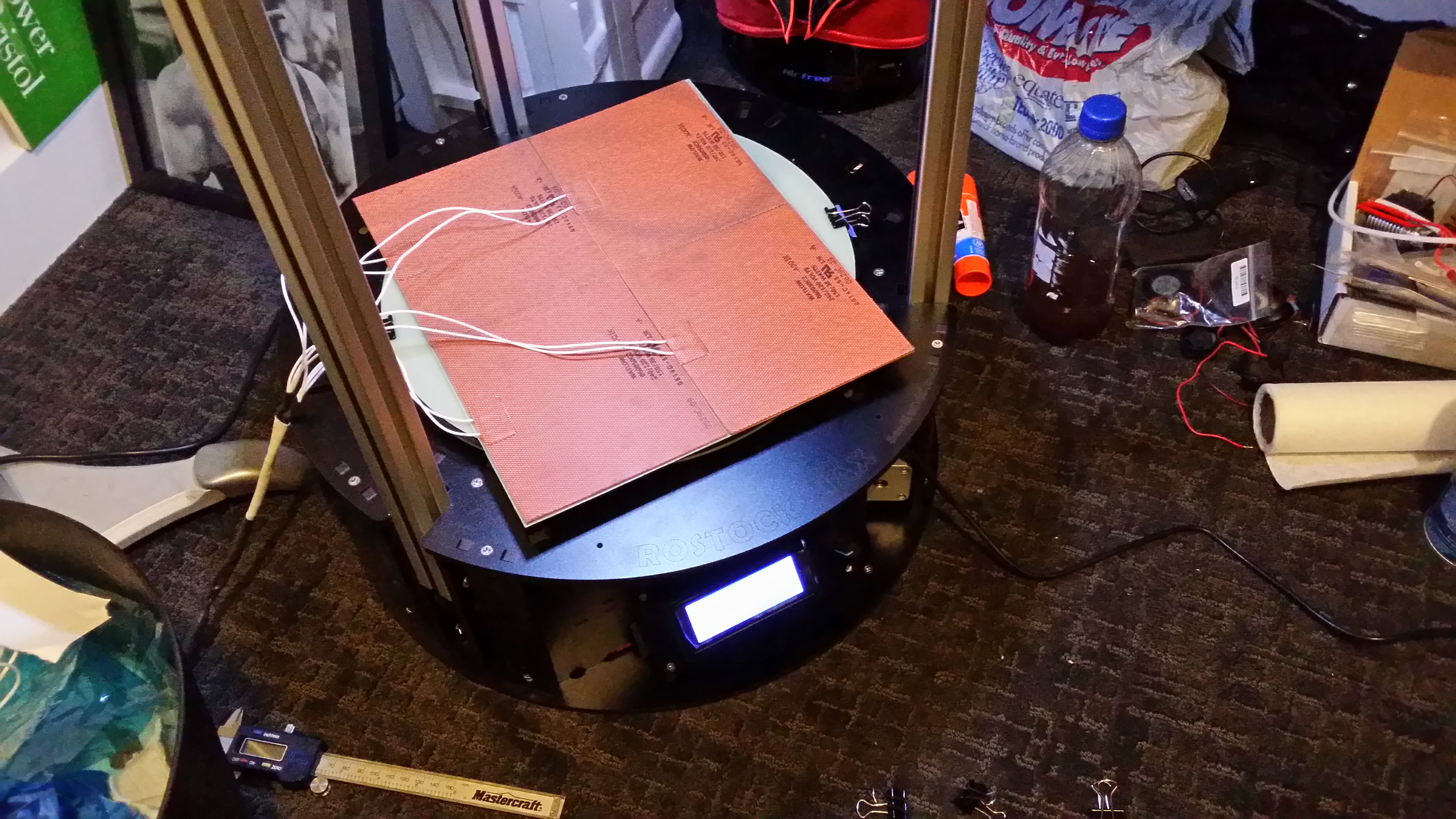

If you get a 24V PSU (I believe Eaglezsoar mentioned a 30A in another post, but sounds like a 20A might be sufficient), it should bring your bed up to temp fast enough. I currently have 4 square pads which help dramatically improve bed heat time, but after it's removed, I have to leave the plate for a bit to let the temperatures equalize to the missing surface heat anyway. I would rather just have the 24V supply (which I don't have). If you get the supply, save the cost of the heat pad and get an aluminum heat spreader instead.

I'm confused... how would I use the 24V supply with the onyx heat bed, when the onyx is rated for 12V? Also, not sure what you mean about letting the temp equalize to the missing surface heat after you remove the plate? When / why do you remove the plate, and what missing surface temperature? :?:
Edit: Oh, I guess you use a heat pad ON TOP of the onxy bed to get the temps up quickly, then remove it, and wait for it to equalize, then print. Is that right? I was thinking about just replacing the onyx heat bed with the silicone. I don't know if that's possible. I'm just going by what I've been reading on forums. This will be my first printer.

A 20amp 24V supply would be sufficient but the draw from it would be approximately 17 amps and I don't like operating that close to the supply's limit, that's why I and others have chosen the 30amp.
Another user mentioned that the Onyx is rated only for 12V and that is true but we have discovered that it works fine on 24V. If you type site: seemecnc.com 24V into your browser it will find many references
to users who operate at 24V along with an SSR. It has been proven to work but not recommended for those who do not know how to connect it properly or those who are concerned about burning up the Onyx
because such a hookup could possibly void the warranty on the Onyx. I am not sure how Seemecnc feels about the 24V mod.

atoff wrote:Oh, I guess you use a heat pad ON TOP of the onxy bed to get the temps up quickly, then remove it, and wait for it to equalize, then print. Is that right? I was thinking about just replacing the onyx heat bed with the silicone. I don't know if that's possible. I'm just going by what I've been reading on forums. This will be my first printer.
That's right. Just to get the temperature up more quickly. And sorry, I didn't realize you wanted to replace the Onyx outright.
I've seen a lot of guys run 24V to their Onyx beds on here and never really see an issue with it. I don't know how much you would want to use one of those silicone pads just for leveling purposes. The incoming wires leave quite the bump. Even if you avoid the wires, I'd be very hesitant.
