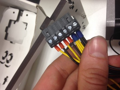

- preparing the PowerSupply cabling, was quite confused by which Yellow & black cable to take, does it matter? or are all exactly the same? I ended up taking the longest ones.
- SUGGESTION: when I put in the cables in the Rambo Power-connector i used some crimps to make a nice safe connection, so no wire can escape (picture will come).

All of the yellow wires are the same, this shouldn't matter.
I used crimp pins on mine too.

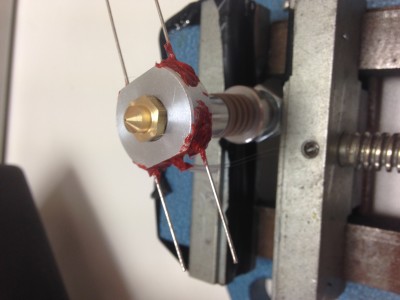

- prepare hot-end (messy work, and its smell so bad , actually a little like Ketchup ;) , anyone notced? )

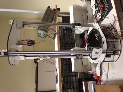

Build going on great!
work in progress
work in progress
Towers: mounted!
endstops: Why does it say to bend the endstops?? to me it seems to fit much better with the straight contacts!!
belts: mountes!
hotend: almost, the temperature sensor was almost coming out, the little trasparent isolating tubes of it moved and exposed some wire after i already solderd everything:/ to fix it i put on mooore RTV, hopefully there wont be a contact. ontherwhise will have crazy or no temperature;/
Do the U-joint AXIS have to be tight or do they have to spin????? after I mounted the springclips the u joint dont spinn freely anymore, is this normal. I mean they still spinn but not freely
TIPP: when mounting the #4-40 T-Nuts for the hotbed press or hammer them in all the way! I was cautious and dind't, so before mounting the hotbed I had to screw them all in deeper, pecause the screw trough the hotbed was to short tho reach them.
tomorrow hope to finish and start calibrating!
so stoked!

simowaves wrote:Build going on great!
Towers: mounted!
belts: mountes!
so stoked!
The endstops are bent so that is easier to put on the connector when pushing it on from the bottom.
The springclips are designed to eliminate free play by putting a little tension on the u-joints, they will still spin, but not without a little resistance. That is the way they are designed.
