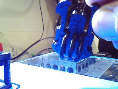

I am getting closer with my Repstrap (using an H1 extruder). I am running Slic3r 7.1, 3mm PLA @ 175c with a .64mm nozzle.
In the present configuration using a layer height of .285mm I am getting fairly good results however oozing is an issue to some extent. I am using a retract of 4mm @ 200. I still getting a little blobbing right where the head starts to lift away. Upon reversal it was also extruding too much when restarting, I installed a negative number in the extra filament column and it has helped with the 2nd problem but not the first. Any ideas? Also I am using .33mm between the nozzle and the bed when starting up. Is there a calculation based on nozzle size of how far the nozzle should be off of the bed? I am having a blast anyway!

I am suspicious of a few things that could be causing the blobbing. 1 could be an incorrect value on the A axis steps per unit. Presently I am in the 324 range (I am using a Hobby CNC Pro board not Seemecnc's board). My infill improved dramatically as I was way off before. (Damn metric system! LOL) I used the axis calibration tool within Mach but accurate filament measurement could still be off a few %.
The blob I have an issue with is right before the toolhead moves to another location. I have Mach set on CV and not exact stop so motion should be smooth. I also have it looking ahead 200 lines. Lift and or retraction doesnt help though elimnating both does but then stringing is a PIA. IMO The PLA oozing is the issue. If I lower the steps per unit of the extruder 1% at a time to see the results and go from there.
I am also thinking the toolhead might be dragging in the print itself. I dont see any build up on the nozzle but the top does look heat sealed for lack of a better term.
All in all for this type of technology I am impressed with the results. Also I have c clamps and fans on my extruder as it flexes quite a bit (it did!).

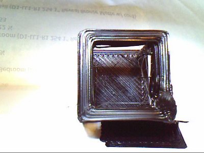

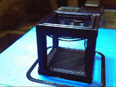

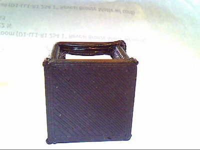

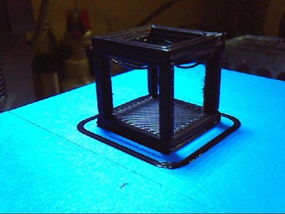

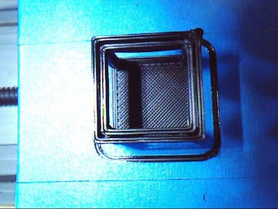

I am running the hollow cube right now and have had a few surprising results. After the statements on A axis tuning speeds, I sped all of my axis up till stalling (huge offsets in the cube). I then lowered them by about 1/3. The results are much better. My A axis has a velocity of 1600 at the moment, IIUC this is a retraction speed of 26mm/sec. It is definitely moving. I am getting no stringing to speak of. The columns are straight though the infamous blob (though very small) is still affecting the the NE & NW corners (columns in this case). I also noticed on my first print of this cube my bridging speeds were also too slow due to my maximum velocity setting within Mach. Hopefully my new tuning will allow faster bridging and less sag. My present attainable speeds should be right in the 100mm/sec range. I am also finding the only way I get good adhesion to the bed and uniformity is to run a single "post it note" (.04mm-.06mm) for clearance. This gets the seemingly correct amount of squish into the filament. Other's experiences in nozzle heights of the bed at start up would be great.

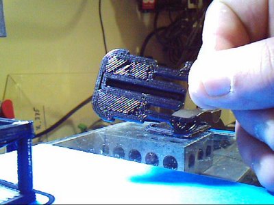

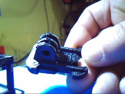

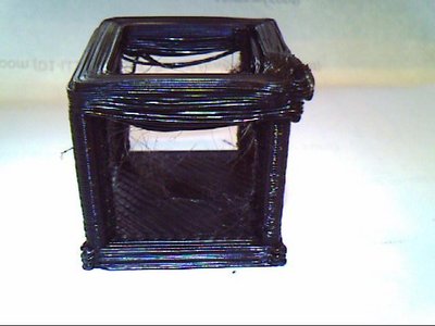

This was a GoPro bracket I was attempting. Btw Sorry for the low quality photography!

Looks like you will need to calibrate your extruder. Also the settings I used on the cube the last time were for ABS, so won't do much good for PLA. That is also the typical way I set the Z axis.
I lie to Slic3r and tell it that I am running a .33 mm nozzle instead of .35. That helps on several of these smaller prints to get full printing without voids.

I saw that there was no infills, but now it occurs to me that you may have set it that way.
That calibration is always to first step to do before you start playing with the slic3r settings. Just didn't know if you have done that or not.

I didn't see any solid fill on that cube. The top of the base should have filled solid as should the top. Now the top is likely because of the width of the nozzle and the actual width of the part. It didn't have enough room for the last perimeter, so didn't infill. Not sure why it didn't do it on the base though.
Mach dpends heavily on acceleration settings as to whether it can reach full speed on a given axis. That setting moreso than velocity setting will will stall a stepper fast than anything. Typically you increase that until you get missed steps, then back off at least a quarter. You did that I think.
