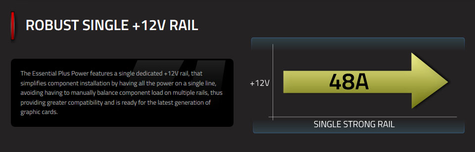

There's always the bolting on the second PS for heated bed specifically...
This weekend, amongst other changes, I bought this to power the entire unit. I'm hopeful that I can heat to whatever temp I want.
If not, I still have another PSU.
http://www.corsair.com/en-us/rm-series- ... wer-supply

Corsair make a quality PSU..JohnStack wrote:There's always the bolting on the second PS for heated bed specifically...
You have the same idea as me...I'm picking up my V2 tomorrow from the FedEx depot and plan on using an old 750W Thermaltake Toughpower as the PSU. I'm going to use power from the two PCIE rails (18A) each to power the bed. Hopefully should be enough...
It's a beast of a PSU and I know from experience it can pump out much much more power reliably than it is rated for....
