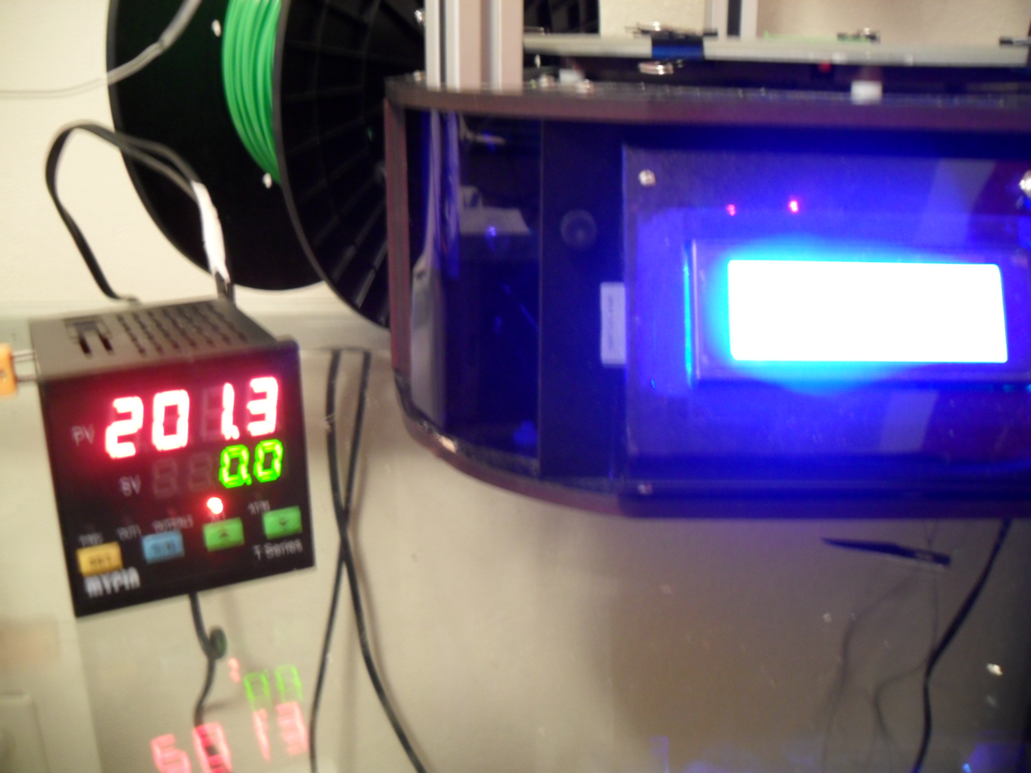

Finally, after tearing up two electrical chords (cords?) I realized that I didn't need to run the power through an AC adapter, and instead I just shot 120V (aussies do what, 220v?, I blew up more than a few things on those style outlets for damn sure, but that's a diff story for a diff time) straight through to my PID to get this lovely photo:
The PID reads 201.3, the Orion reads 200.8, well back to the old drawing board I guess. At least now I don't have to mess with the beta value in the firmware so I get to kick that can down the road but I still have no idea why my prints are comin out all weird. Could it be that during long prints the hot end thermistor gets crazy/lazy?

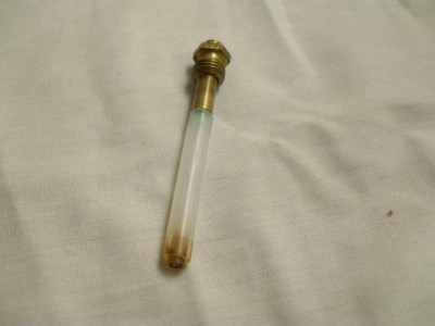

I hear what sounds like a SNAP at times, almost like my spool of filament is being jarred awake from its slumber, also when I turn on the hot end the peek fan makes a clicking noise as well, I took it down and sanded the housing but it didn't seem to make a whole lot of difference, the noise is still there. Also sometimes when I turn on the Orion itself I hear a clicking noise coming from the housing, almost like a wire is caught in the blades of the internal fan, I have no idea what to do about either of these problems unfortunately and I am hoping that solving them helps my prints in the long run. It could also be possible that the peek fan shuts down on my long prints and causes the hot end to act strangely, here is a picture of my internal PTFE tubing, no idea how it got to be this color:
I have learned that seemecnc now ships the orions stock with a different setup for internal ptfe tube, I feel like this may be part of the reason for grinding filament/poor hot end performance as the filament gets finagled around in there and slowly builds up pressure....my theory anyway. I guess I will also have to learn how to mod the firmware in order to print hotter than 230 if need be, as the ABS can handle a bit hotter than that and so can the peek.
