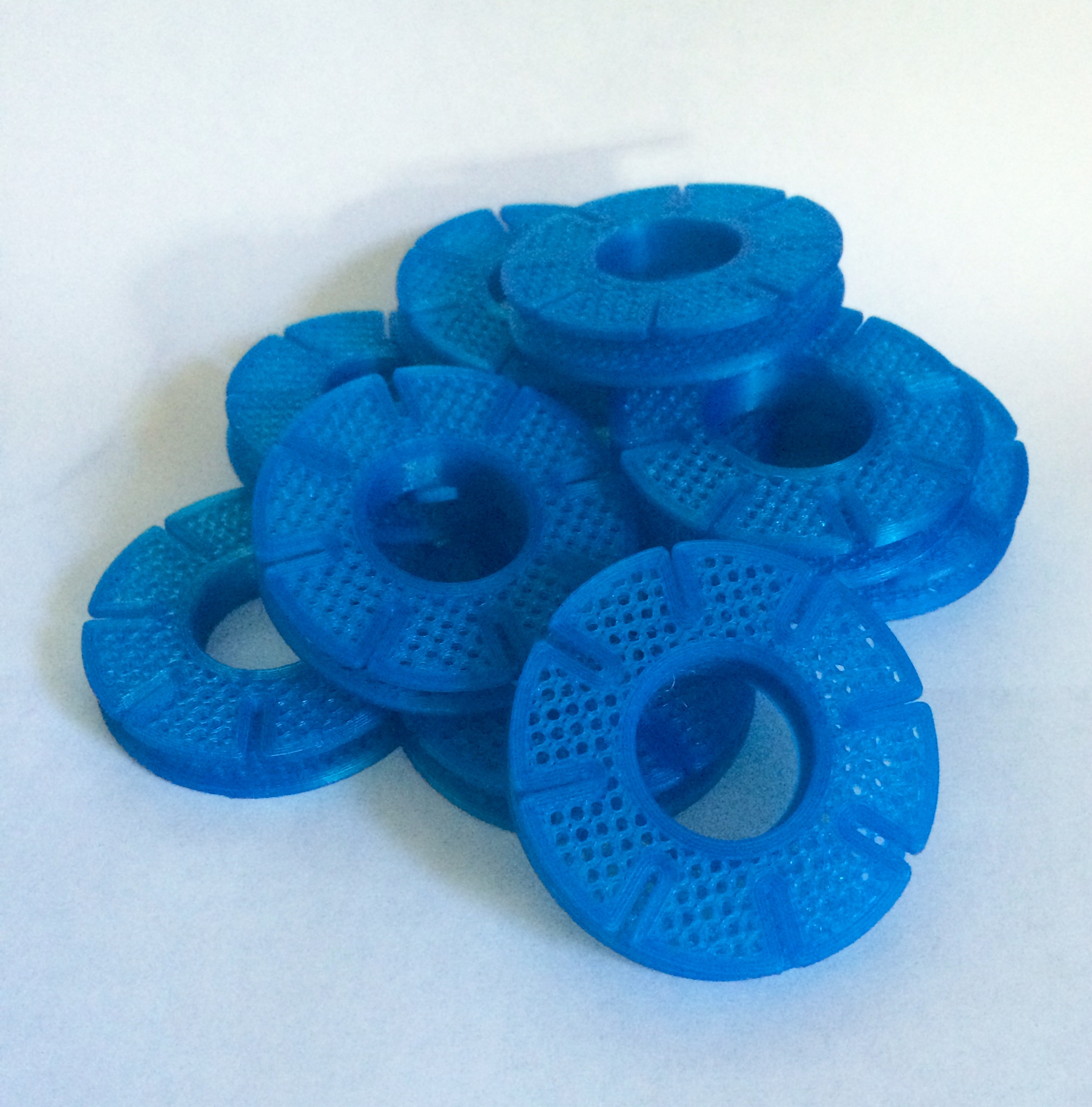

Firstly, BuildTak's web site says the material CAN WITHSTAND high temps (110-125°C) but I don't print anywhere near that temp. I could imagine that aggressive sticking would happen at these temps. I've been printing PLA at 55°C and ABS at 75°C. The parts stick very well and they pop off with a very pleasing "pop" when they come off. (My hot bed temps are calibrated with a thermocouple so are reasonably accurate.) I had no problems with first layer pealing or curling and my "open weave" tenkara line spools are very good tests for this since they have many small radius corners (like a flower petal) AND they have very low first layer contact surface due to the open infill. When one of these stick to a build surface, I know it's a good one! You do have to make sure your Z=0 is set properly as it is more difficult to remove highly smooshed first layer parts from this surface, probably due, at least in part, to the surface texture.

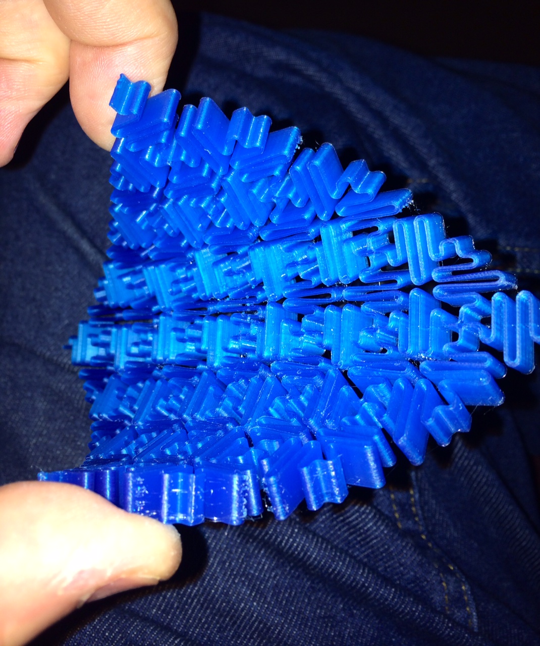

I also printed this very tricky mesostructured cellular material to get stuck with no problems:
These are both difficult parts to get stuck on any build surface and the BuildTak had no problems with first layer lift or curling. And all parts (well, actually 40 pieces of the line holders since they are printed in 2 halves at the same time) came off with a reassuring and crisp "pop". I do clean the surface with isopropyl alcohol wipes between prints to remove any finger grease, etc. NEVER use acetone on this material, it will ruin it.
