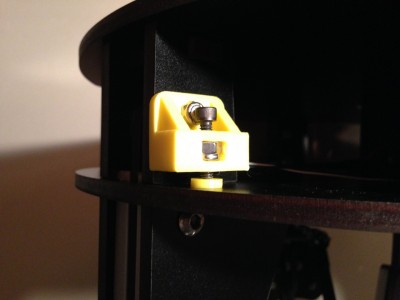

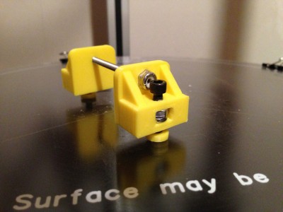

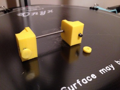

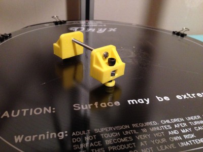

I spent some time today and ran out a prototype/idea that might have some promise. Before I try to install one of these, I'd like to get some opinions from all of you regarding this.
The difficulty is coming up with a design simple enough to work with the single hole we have in the melamine panel. The first Rostock had two holes and in my opinion makes a custom tensioner even easier to develop. What I've come up with MIGHT work, but I feel it needs some tweaking. The general idea I have is to make a tensioner that installs on the single screw, with a socket head cap screw added for adustment. The possible downside is that this would put pressure on the melamine panel, but I don't think it would be enough to break or stress the melamine panel. Not sure though. The other issue with this design is that it doesn't allow for a ton of adjustment due to space limitations. That said though, I think it could still work, or at least seems like it would on my printer and the way I have the belts tightened at the moment. I'm happy to develop something for all of the v2 users out there, if I can get some feedback on this design. I'm sure we can all come up with something that would work.
Final thought...Am I overthinking this? Is there even a desire to have a more easily adjustable tensioner? Your advice and feedback are greatly appreciated. Thanks!

There most certainly is a need for a tensioner on the V2 and yours is the first one that looks like it may actually work. Even the tensioners on the V1 did
not have a lot of room for adjustment but offered just enough to allow you to level the upper pulley so the belt may run in the center of the pulley. Your idea for the V2 seems to offer close to the same range of adjust-ability and I would definitely take this to fruition to benefit all V2 owners. Great job in coming up with something that looks like it will actually work.

Looks good... I'm definitely interested in a tensioner for the V2! I was originally thinking of creating a "cap" that would fit the post; Something that would end up looking like this: [img]http://i.imgur.com/3FnY9pu.jpg[/img]
...minus the middle spacer... but that would create about a 2-3mm gap at the top plate.
I don't think your design would create enough pressure to cause damage... seems ideal. A bigger / wider screw cap would help.

I agree that a larger cap at the bottom would help distribute the stresses involved but you can't go too much larger.
I like esbowman's design just the way it is with Atoff's idea of the larger cap. The design seems perfect for the V2.

I thought about doing some sort of a cap but that would likely cause the top to sit up higher and the acrylic panels would not fit as well. I'm sort of OC in that regard. :)
I'm working on the next version now actually. I'm thinking about having two adjustment screws instead of one. I think this could spread the load a bit more and prohibit the tensioner from accidentally rotating. I'll post something late tonight hopefully.

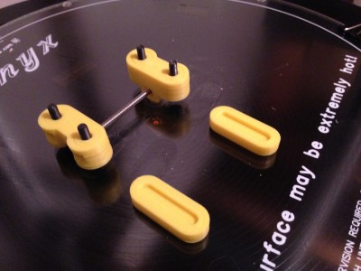

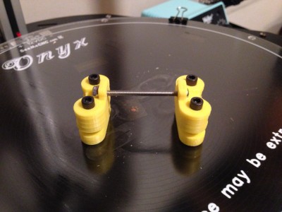

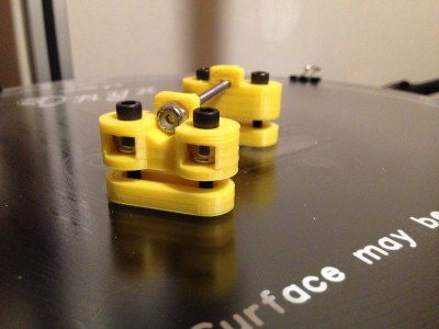

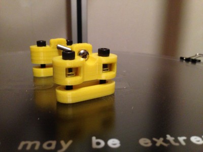

Here's a version 2 prototype. Let me know what you guys think.
A couple of things I noticed will need adjusting.
1) There's a cable tie on the right side of all my towers that grasp the wires that exit the top of each tower. I think I would need to either add a cable tie slot in my screw bottom pieces, or just move the adjustment screws a little further away from the towers. This would provide a small gap and allow it to fit over them.
2) There's a stop screw for the extruded aluminum towers on the left side of each melamine tower support. This gets in the way with this design as well. Again, I think I can just move the adjustment screws away and leave a small gap.
3) I'll end up making the nut capture area more substantial so it's easier to install. Right now it's so shallow that it's a little difficult to press them in place. This is the area for the #6 32 nylon lock nuts for the screw that goes through the bearing. Not the adjustment screw nuts.
The good news, is that I think this design works much better. Haven't installed it yet, because I know it's not ready for prime time but this seems like a much more solid design. Pics below...for whatever reason my printer decided to get sloppy tonight. :(

Re: Easily adjustable belt tensioners for Rostock Max V2???
Posted: Mon May 05, 2014 5:46 am
by barnett
I don't have a V2, but I think that looks good. The double screw version seems preferable so it pushes on the melamine over a wider area - as long as there's enough room for it.
There's probably a break in period for these belts because in the beginning I fiddled with it a lot and now I probably haven't touched them in over a year.

Nice...looking good. I think the two adjustment screws per side is the way to go.

I like the original design better - I'd use one screw, but use a wider, rectangular foot for the adjuster screw. Same effect, fewer parts. :)

The drawback to the first design in my opinion is that it doesn't allow for as much adjustablility when compared to the two screw design. By separating the two screws I'm able to gain 1-2 mm by moving their respective nut captures up a bit. I hope that makes sense. That said though, I do agree that less is more in this situation. I'm all about keeping it minimal . :) I'll tweak the first one again with a wider foot and see what you guys think. Thanks for all the feedback.

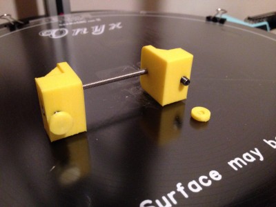

Ok. So here's what I was thinking with the "ramp" axle tensioner. Please, you real engineers pop in here and clean this up. I'm only a fake engineer.
Essentially, you've got the Blue fixed block that goes on either side of the tower. It's even got a cutout to avoid the wire tie and screw that aligns the top plate to the top of the alum tower post. (not visible).
The black vertical block, shown better in the 2nd picture, just shows the approx travel range that is laser cut in to the tower piece of melamine.
Then the Green block with the axle running through it. This will raise or lower to add tension to the belt.
The tension is adjusted by the bolt going through the pink block. As you tighten the tension bolt, it pulls in the pink block toward the blue block and that pushes up on the green block. Once you have it dialed in, the axle will now rest on these blocks. This should require very seldom adjustments and should hold everything in place real nice.
Anyone see any glaring issues with this?
Posted: Sat May 10, 2014 12:17 pm
by Eaglezsoar
How is the green part supposed to go up when it is held captive by the adjusting screw?

I like the idea, but I'm afraid you don't have enough room from the center point of the bearing screw to the outer wall of the blue block and that adjustment screw. Hard to tell unless we have dimensions. Eaglesoar has a good point too. I appreciate the brainstorming, and altering your design could possible work if there's a way to make it all fit.
