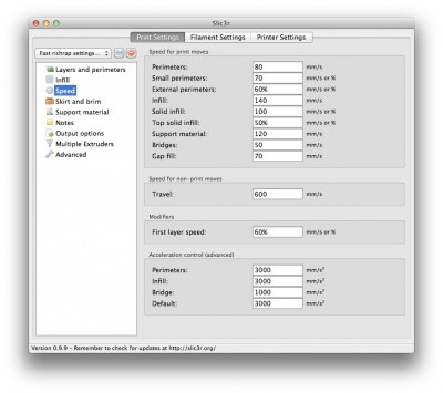

Good safe defaults, up to you to see where you can push it. I've been incrementally creeping things up and have reached this point but I haven't hit any big problems yet.
I'd also remark that I get BETTER results going a little faster than the 30mm/s - the layers seem to be a lot less blobby.
Maybe save your settings now and give something like this a go:

Awesome, thanks for the settings. I'll definitely give them a try with Slicer. I use Cura, but I'm not sure which settings relate:Captain Starfish wrote:Good safe defaults, up to you to see where you can push it. I've been incrementally creeping things up and have reached this point but I haven't hit any big problems yet.
[img]http://i.imgur.com/FH5WLg0.jpg[/img]
Cura complained about all the values I tried entering!
[img]http://i.imgur.com/LWkhWum.jpg[/img]

It should be noted that really big values for things like travel speed are capped in the firmware, setting the speed to 600 is probably identical to 300 and possibly 200, depending what the cap is in the firmware.
Acceleration settings in the firmware also becomes dominant in print times as speeds creep up.

Well, I just tried the settings from Captain Starfish
Something odd happened, because it stopped printing 5 minutes into a 3 hour print (at those speeds), and went to 100% complete. It was a little messy too, but damn I loved watching it move!! I restarted the print with my standard Cura settings, though with print speed at 35mm/s and ramped it up to 150% through Repetier-Host. It seems to be doing well. A little globby at first, but they may be the new filament I'm trying.
Edit: I just realized I forgot to adjust the filament size after swapping filaments!
I don't see a way to change it mid-print, or through the LCD. It's not so off, 1.73mm avg vs the 1.78mm I had set... and this filament did vary to 1.78-1.80mm.
