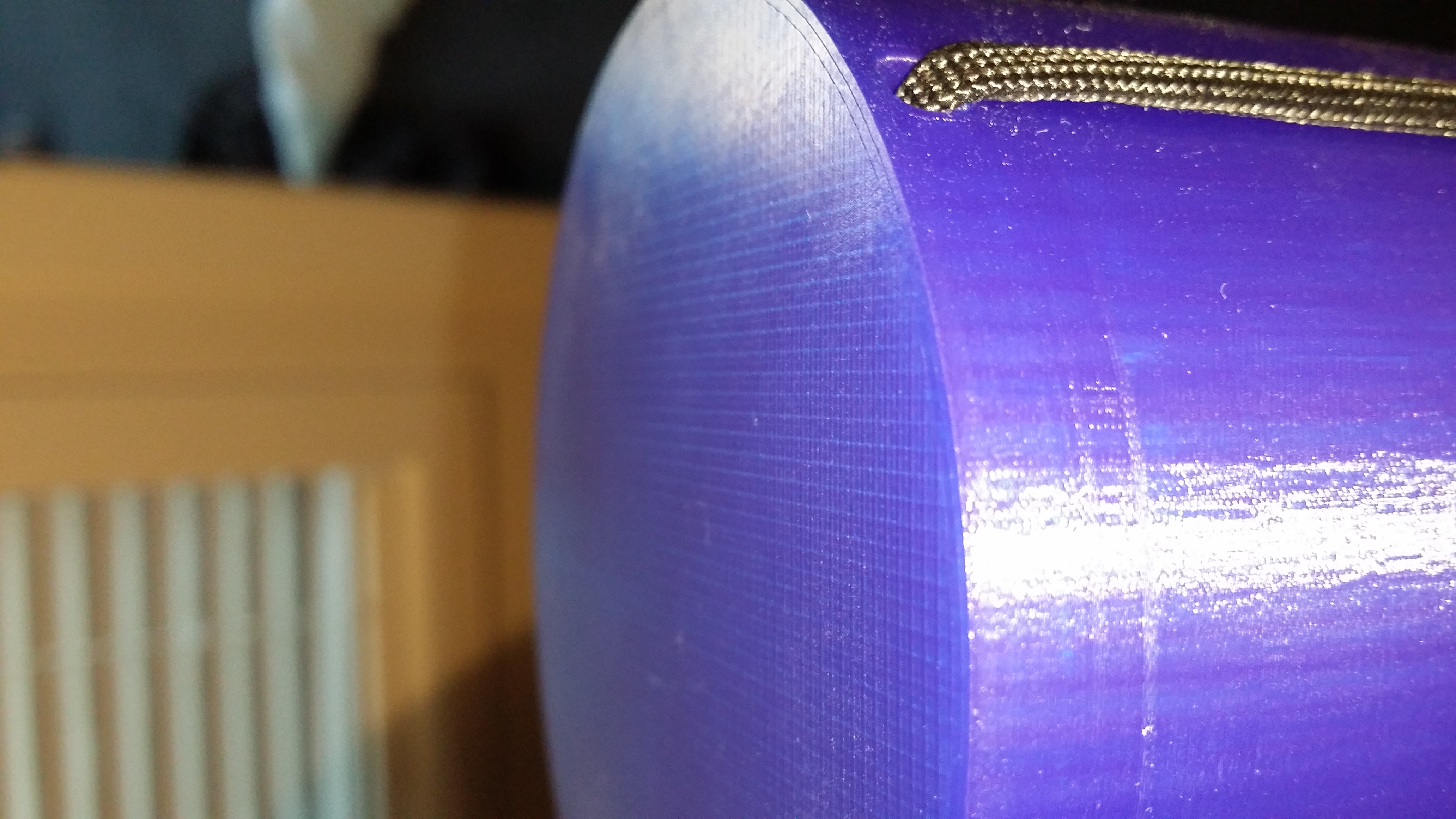

Not sure what's going on, but my prints have been awful lately... anyone tell me what's wrong? I've just recalibrated the bed, re-measured the filament, tightened the belts.
[img]http://i.imgur.com/6HnywN2.jpg[/img]
Filament is Filamex, purchased from faveprices on Ebay. Temps: 195c Noz, 60c Bed. Printing 100% speed at 35mm/s... safe settings. Sliced using Cura.

Extruder calibration? Do you mean the E-steps? I did calibrate the endstop heights, and horizontal radius, and checked the filament diameter. I spent yesterday trying to tweak and test. I ran a print, which came out fine for the most part, just some typical problems with overhangs that I would expect... but I still see the problem mentioned above.
The print was small and with white filament, so it's not as obvious...but it seems like whenever I have to print straight lines the issue occurs, also, the same gaps in the infill at edges.
Here's the print, which looks fine (mind you, it's small, so no straight line stretches).
[img]http://i.imgur.com/iqwCUzr.jpg[/img]
Here's the bottom, again, since it's a small circular area, it's not as pronounced
[img]http://i.imgur.com/UTR0ftJ.jpg[/img]
And here's a better example of the problem, though still not as obvious as the print in my OP.
[img]http://i.imgur.com/cs3O1Bc.jpg[/img]
Could this be an issue with belts? I believe they're nice and taut. Just looking at the thin parts, it appears like there wasn't enough filament extruded, as if perhaps at those places it may not have fed properly, but the gaps on the edges, those are occurring regularly.

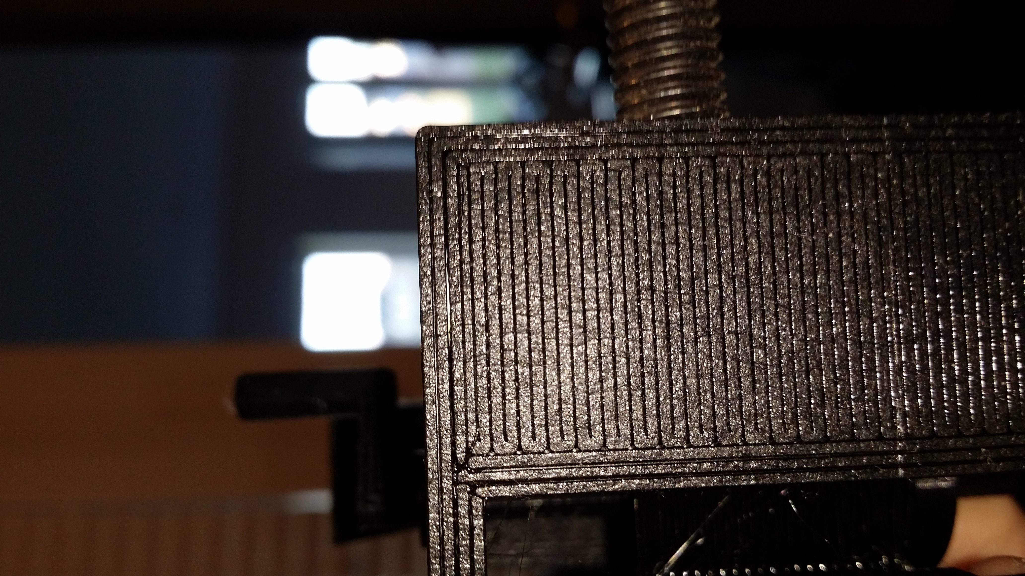

Okay, finished printing the bottom part of the case. Lowered the Z height until I couldn't move a piece of paper underneath. Still there are gaps, and the lines are thicker, which tells me it's really being squished into the bed.
I also used the really nice Hilbertcurve infill for the top and bottom layers. At least it looks good. But as you can see from the picture, gaps in the middle where it meets the perimeters, all the way through the layers. This COULD mean the level is convex right? But I don't want to touch that because it really does have the same height at all 4 test points. Same amount of grip on a sheet of paper. Also, looking at the other prints, the faults aren't all in the center. They're all over. But, looking again at this recent picture... looks like the left and right sides are fine... only the top / bottom have gaps... does that indicate anything? Loose belt along the __ axis?

I used to get the same thing using Slic3r. I ended up going to Cura and haven't looked back.
This was the result I would get with slic3r. Much that same as what you're getting. You can see through near the top like yours and this piece is about 5mm thick. This was printed on painters tape too.
Fill not touching edges
Now this is the kind of bottom surface I'm getting:

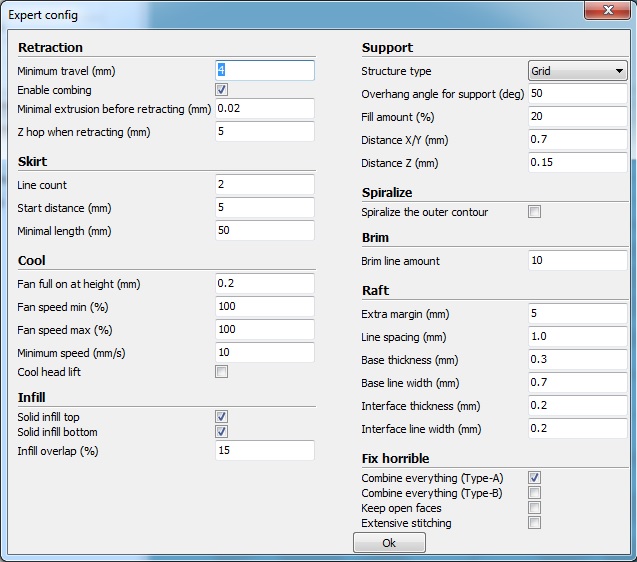

These are the settings I have in my expert window for Cura. The overhang angle is pretty steep, but the infill overlap and solid fill top and bottom are likely the money makers. Try making sure they're on.
Since you've got the exact same thing going on with your prints that I did, I'm guessing it's not mechanical.

Ah, that is a big difference! Thank you, I'll give those settings a try and see if it fixes things! Can I ask what you have for your Shell Thickness and Fill Bottom / Top Thickness in Basic, and your Initial Layer Thickness in Advanced?
