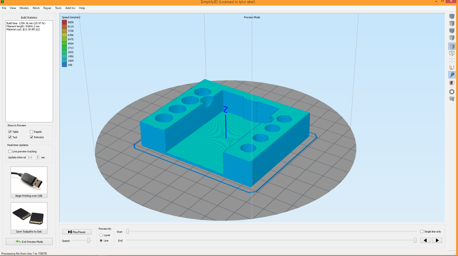

I'm doing my first decent sized print. I sliced it with Cura, which is what I've been using most often, and for some reason it was skipping the same line in the base layer no matter what setting I used. No problem, switched to Slic3r/Repetier-Host. Now the problem: a 10 hour print in Cura is showing 123 hours in Slic3r :shock: . I could carve this piece out of whale bone with a toothbrush in 123 hrs. My question is, how accurate is the estimated print time in Slic3r? Is this a common issue?

Here it is. i think it's just being crazy on estimates. It also estimated 225 meters of filament, and this shouldn't take over 40. I timed the last 2 layers and I'm figuring around 10 hours, give or take.

21 hours, 30mm/sec, .3 layer height, .4 nozzle, 10% infill, 3 perimeters,3 solid top/bot

Generally I now only look at the Slic3r estimates (actually, all of them) for a laugh. Takes as long as it takes. If I have a somewhat time sensitive print I'll stopwatch the first few layers, scale to whether they are more/less full and complicated than the "average" layer of the model, and multiply out to the number of layers to get an idea.
