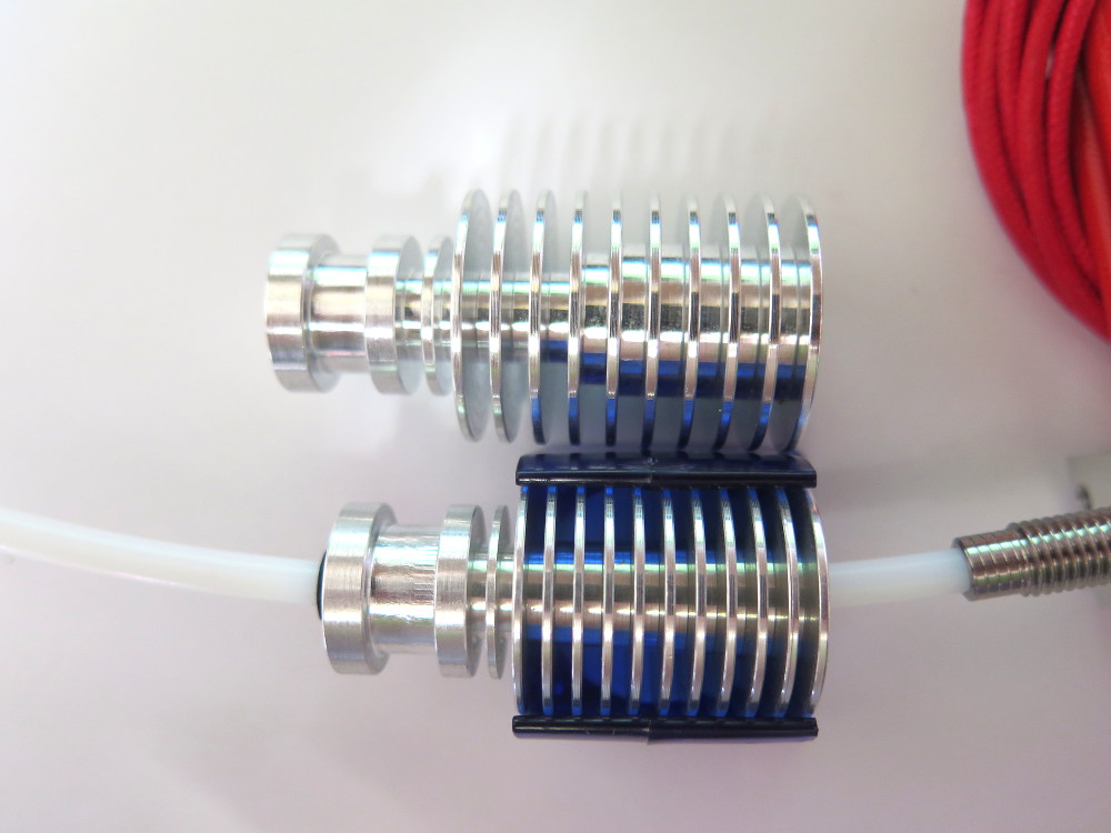

I have included as attachments some pdf files that are mechanical drawings of the V6.
Also included are a few pictures of the V6. You will probably notice the V6 is
shorter than the V5 and here are the numbers.
V6 Direct HotEnds are 7mm shorter than V5
V6 1.75 Bowdens are 20mm shorter than V5
V6 3mm Bowdens are 23mm shorter than V5

Some pictures to go along with the text.
You notice there are two small screws to tighten and hold in the ceramic heater.
The other small screw is to hold the insulated legs of the thermistor.
