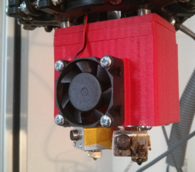

I agree with McSlappy about using 1 single fan. I had printed and used all three known (by me at least) dual mounts for E3D V5. Among them, dpmacri's version (http://www.thingiverse.com/thing:217662) sports a single fan. It works very well, not over-heating problems at all.
This is my print
Dual E3D Mount
Dual E3D Mount
This is my print
Wow, glad someone has working proof on that. What size is that fan?
