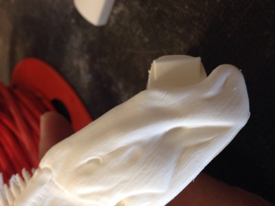

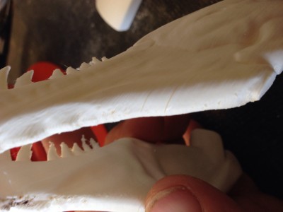

I am currently printing ( http://www.thingiverse.com/thing:308335 ) @ 100% and was sad to see no less than 6 CRACKS in the print.  By no means ruined, but still saddening.  I have been using a heat gun ( http://www.harborfreight.com/1500-watt- ... 96289.html) to help cleanup my prints and thought that I would try to reflow the ABS a bit to remove the cracks.  Much to my delight CAREFULLY heating the ABS causes the entire heated area relax without deforming, and the cracks melted back together beautifully. The larger cracks 1/16" went back together with only a minor misalignment present while the smaller cracks disappeared completely.
I hope the helps anyone who is dealing with these ABS issues.
Tips:
1) Where cloves these heat guns WILL burn you.
2) Keep the gun moving over the print you are trying to heat the surface and the support structure under it, not just the surface.
3) If you deform a small protruding surface element a small knife will help you put it back in place and hold it there why the ABS cools.
Tips:

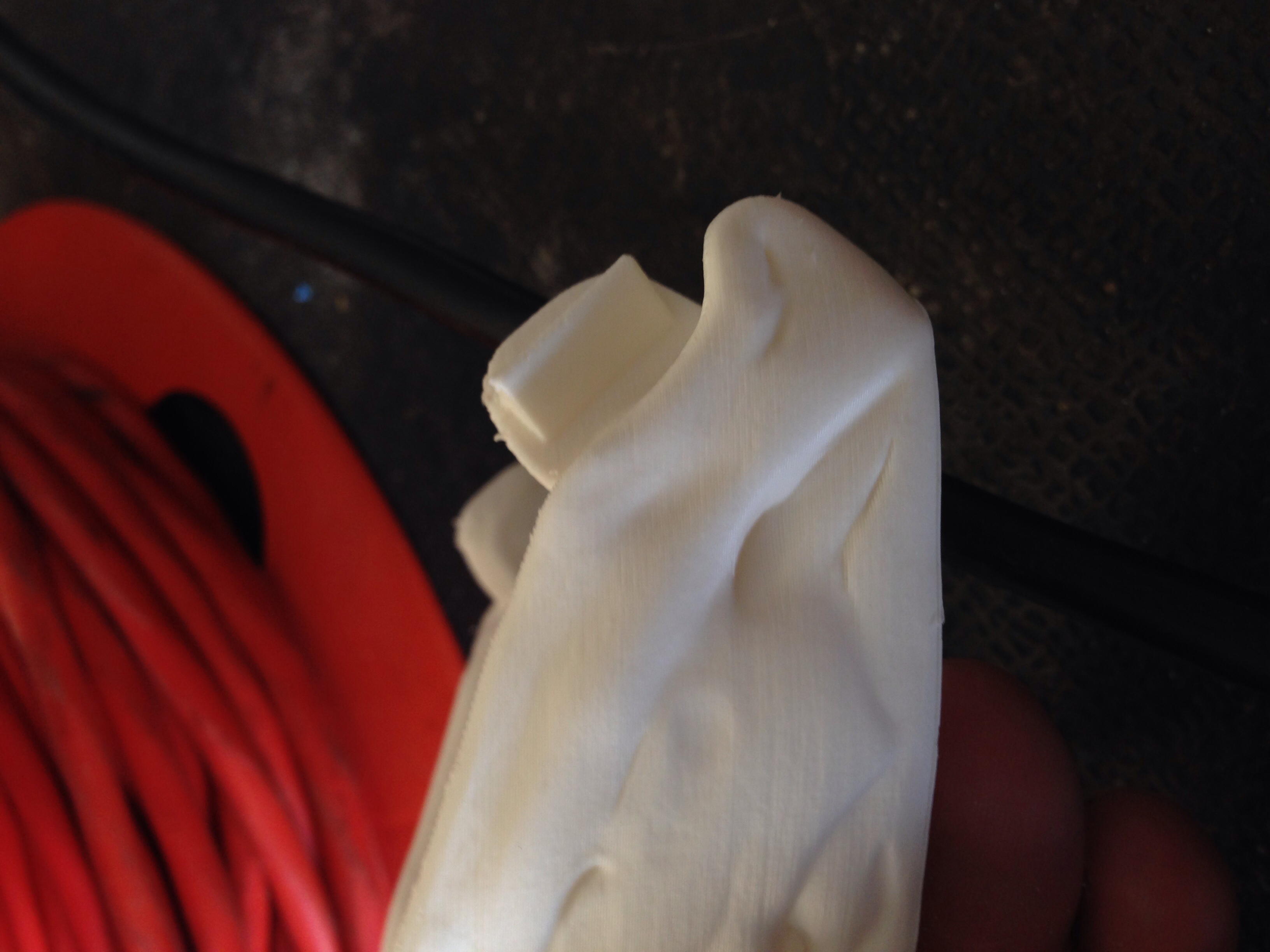

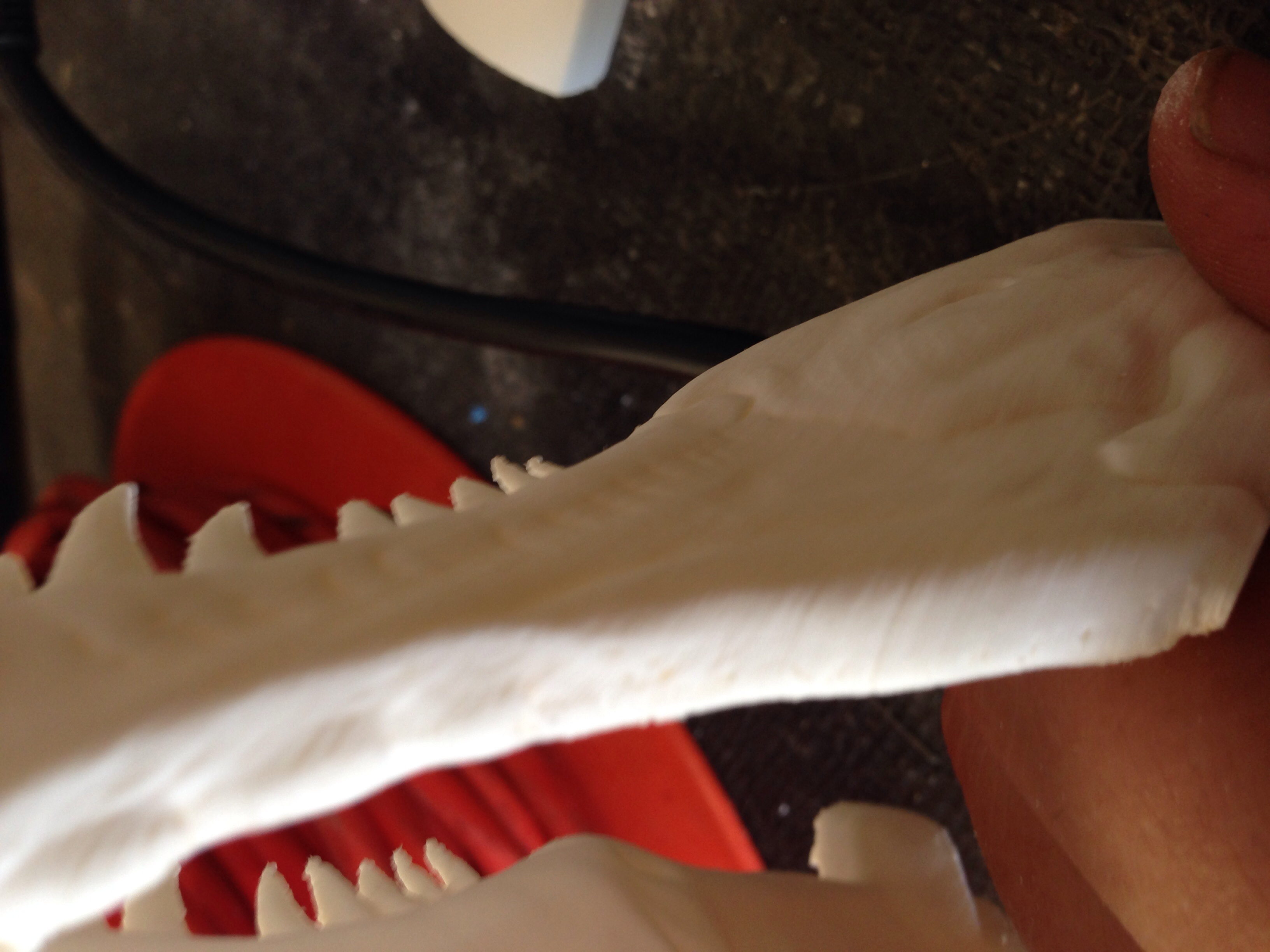

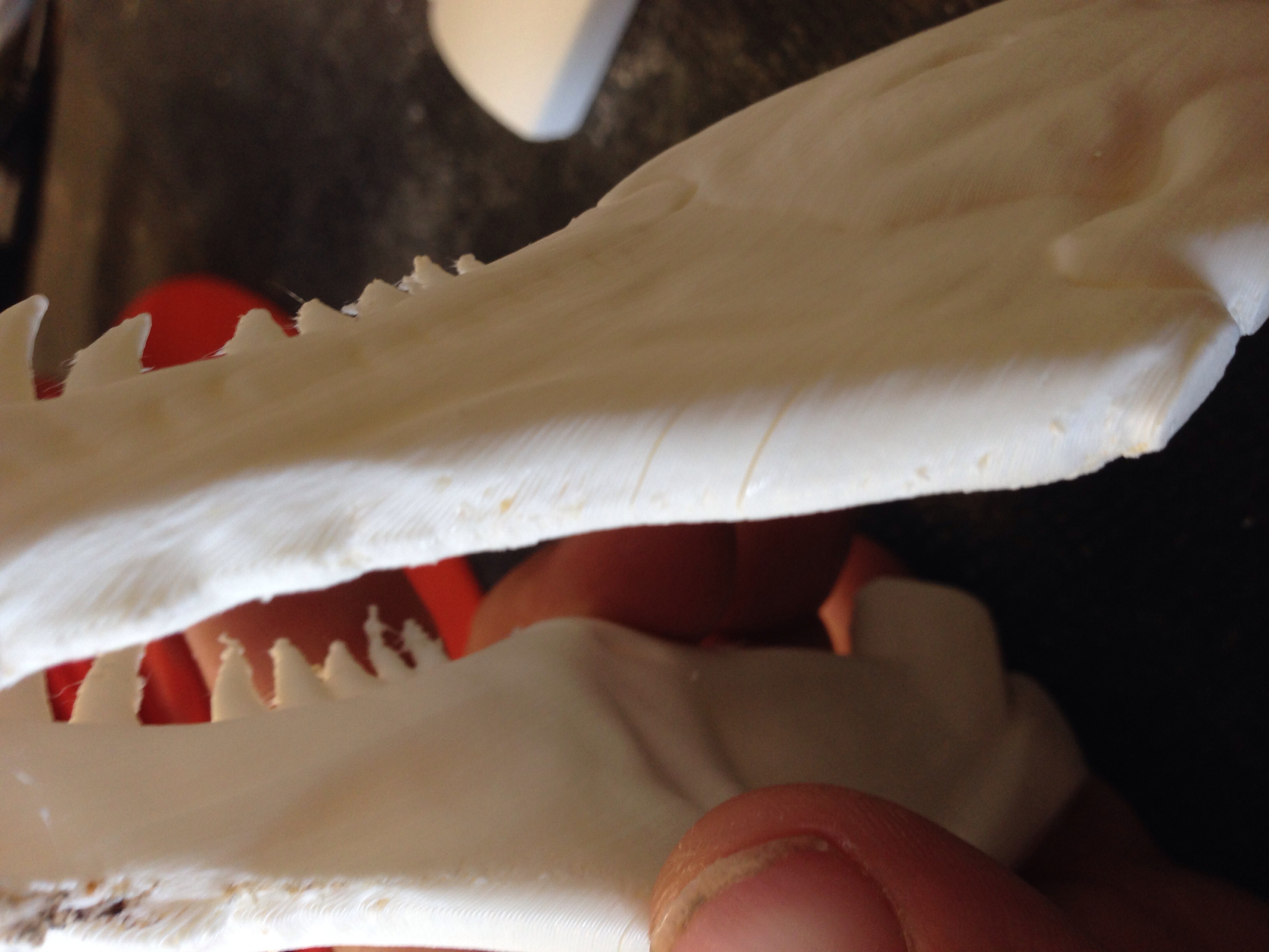

These are very small cracks (may have to click on image to see them), but they disappear when you heat the ABS.  To me this indicates what many have already said about printing in ABS and needing a heated chamber. I believe this is a patented method (Stratasys, or 3D systems)  (
 ) but you can do it for yourself without much fear of reprisal.
						Re: ABS Cooling Crack Repair
That's a pretty good idea!  I'm actually surprised it doesn't create more surface distortion.  Looks like it smooths it right out.  Good work!

There is no noticeable surface deformation IF you keep the heat moving.  My major reason for using a heat gun rather than my plastic welder was that I wanted to heat the entire area to see if I could relax the internal stress that cause the crack rather than try to melt the crack together.
