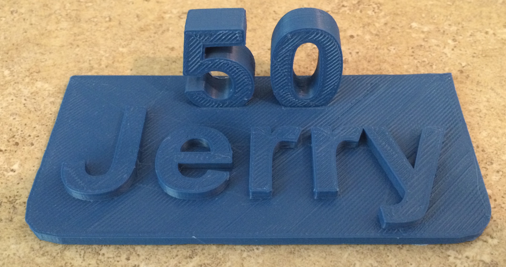

Doesn't say much, but I wanted to do something on the 3D printer for my brother-in-law's 50th birthday. Maybe a cake topper would be a better title.
This was my first time using the ABS Juice. It held down in the middle with a death grip. But some of the corners did peel up a little. Nothing like how the hair spray would peel up though..
Those numbers are full and separate parts. I used a boolean operation on the base to carve out a "socket" for those numbers to sit in to. That and a little ABS juice glues those numbers in pretty good.
