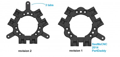

Posted: Mon Jul 07, 2014 12:53 pm
by PartDaddy
Hi Guys, Here's a picture to identify the platform revision. Revision 1 has one tab. Revision 2 is the current model and has 3 tabs. I'm unaware of anyone having a problem with walking axles in rev 2. I made a completely different mold set for revision 2 and it has a very tight grip on the axle. Anyone with problems with a revision 2 platform should email support at seemecnc.com so it can be reviewed and corrected. :)

Re: Axles on the Orion Delta...
Posted: Mon Jul 07, 2014 2:42 pm
by Eaglezsoar

PartDaddy wrote:Revision 1 has one tab. Revision 2 is the current model and has 3 tabs.
Ok, good to know, thanks. The silly little part I made uses the two unused tabs on Rev 2. I guess they'll be LED holders afterall.

by Norm77
Concerning the "platform" revisions, I guess I've got "revision 1". Also on the
"revision 2" style, does that allow you to reposition the fan in 2 other locations?
Thanks,
Norm77...
Posted: Mon Jul 07, 2014 3:57 pm
by PartDaddy
Yes, an additional fan, or almost anything, can be mounted to the other positions. It is extremely strong, I injection molded most plastic parts on our machine from glass filled nylon.
