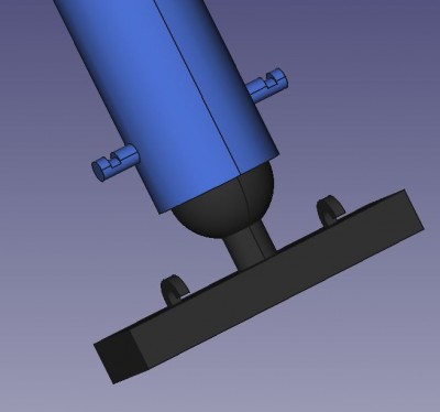

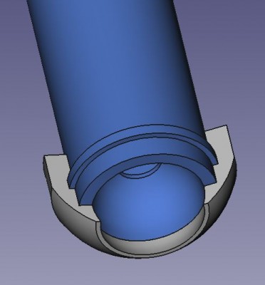

[disclaimer: I'm in the process of going magnetic, and trying a lot of different things. Some might not pan out.]
Why not use a cap?
It would snap on and off for maintenance, but should hold the ball in place in cases of high torque.
Why not use a cap?

Max wrote:[disclaimer: I'm in the process of going magnetic, and trying a lot of different things. Some might not pan out.]
Why not use a cap?
I was thinking about trying something like this also, but the cap would be held by spring pressure from a piece of rubber tubing slid over the CF rod.

Re: Springs instead of magnets for CF ball end arms
Problem with this is that your spring (or band) force is proportional to the amount it's stretched. Two things happen with this design. First is that when you bend one way, the shortening band loses pulling force whilst the tightening band increases pulling force - so the further the arm moves off centre, the greater the "centering" force on the arm. This is exacerbated by the short bands - you're doubling or halving the length and therefore doubling or halving the force as you move around, and that HAS to have an effect on the print job quality.Max wrote:Same disclaimer. I was considering rainbow loom bands, 600 for $2.50, or grab a few from the kids... add two or more for more force. Since I still need to print my connection plates I could add them.
The long spring isn't so bad because it changes length only by a small proportion as it moves around - even though it's unbalanced and off centre.
A hollow ball with a pin in the centre and the band hooked from that pin, through a hole in the ball and a matching hole in the rod end, to a second pin in the axis of the arm would work better provided the holes could be made wide enough for the full range of motion. Or
