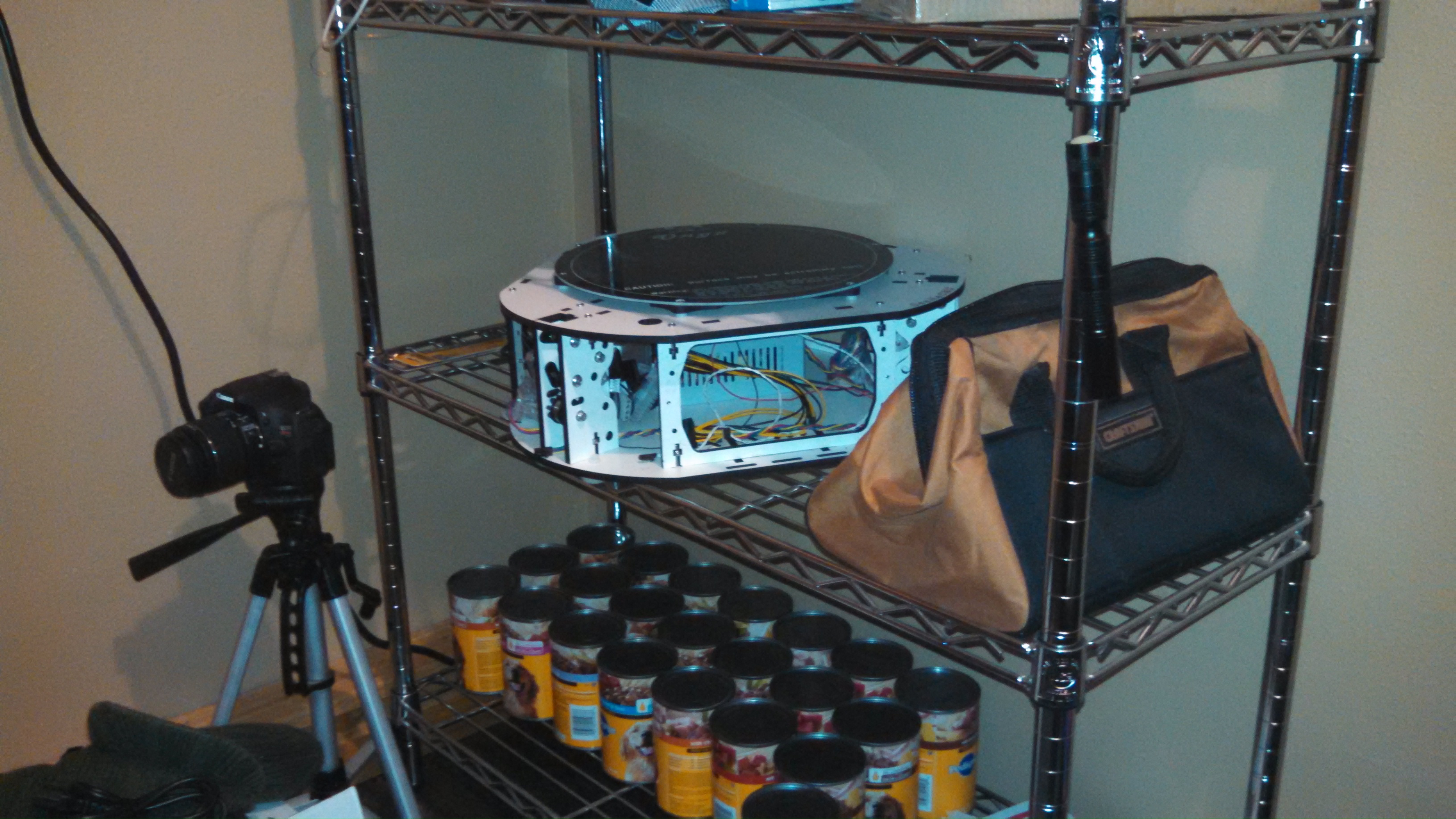

I took out some extra time to paint the edges of the melamine, with high temperature paint, that's normally used on charcoal grills, or wood burning stoves. It's Rustoleum's, and it stays tacky until it's exposed to a high heat as well, or takes forever to dry. After two weeks, I stopped waiting.
The insulation in my lab/storage/man cave, is very thick, and just turning on my soldering iron, turns this place into a sweat box. But, I did figure out some minor modifications to compensate for the difference. You can look at the back of the hot bed and follow the traces for most of it. Everything else about the assembly has went fine, and the advice in the Assembly Guide, about using a motorized screw gun or drive, it's really bad advice. You'll crush at least one of the nut braces. Screw guns, are not so well designed to have an adjustable torque, and melamine is not something you dial in on. The screw gun will never stop when it should, and you won't want to use it. Way better off going full manual. You want to stop when you notice it start to deform. Not have the screw spinning so fast it mushed.. It's the worst advice unless, you can adjust the drag on the screw gun as well and as accurately as the drag on fishing reel. They are not designed with the kind of fine tuned control you need to just spin those screws in. It would be nice but, no such thing.
I just checked the early assembly pdf file in the downloads section, and I did get a version one hot bed. Man, you guys should include the possibility of one or the other, just to avoid overstock in the warehouse, anyone would understand. So, that would have two assembly procedures pending on which hot bed you happen to have.
This is a note for the assembly guide, "You want solder and solder wick on hand before you start. When you finish, you want to make sure there's no bumps on the side the glass will rest on. First, bend you leads to fit, then trim them shorter than the hot bed is thick. For the power and sensor wires, use a piece of kapton tape to hold the wires in position before you solder. It can be removed later. Run your wires under the snowflake, and through the center of the melamine board. Fancy twisting, bundling and things of that nature, won't fit in the dip, and the plastic is just likely to melt, weaken, or short, pinched between the hot bed, and the snowflake." I'm going to drill a hole, and relocate those one more time. Straight down, and I'll fish the wires around corners until get to the Rambo. I took another look, and that hole is a little closer to the center, and an inch wouldn't be too far because, all of the plastic is moving away from the heat to head down that hole. Plastic, get's soft, when it get's warm, and wire can migrate through it over time. It's like overheating wire with a soldering iron, in slow motion. Could be weeks, could be months, with enough distance and length too long, years but, eventual. I might even seek out some PTFE, and heat shrink it into position. By first sliding the PTFE up to the solder joint, holding it in position, sliding the heat shrink up over the PTFE and wire insulation, then shrinking it in place. So, it's a much larger diameter than has been used with the thermistors. The melamine, is a heat barrier, with allot dead air. Technically, I think the version 1 hot bed, is better because, the center is going to be hotter. If you use a thermal imaging camera, to look at that thing, the edges are just a little cooler than the center of the hot bed. Everything has been done for an even temperature, and I can see where the heating element is under the lamination. It's better to solder away from the heating element, even if only by a quarter of an inch.

I'm waiting for lacing and connectors, as well as crimp on pins, male and female. I got way too many lines, of too many wires, and these guys are only using 12 volts. The ATX form includes 2.5 volts, 5 volts, and a split supply for 12 volts. I know, that if they just wrote to the power supply manufacturer about the Rostock design and kit, they could drop so many parts, that they'd save money, and only use the 12 volt side, and maintain the entire ATX transient etc.. IBM wrote the specs, for surge protection etc.. and get a way cheaper power supply. The engineers would know which parts to drop from the board, and even thought the printed circuit board is the same, we only the 12 volt rail. That is allot of wire, and I'm trying to control all of it. Lacing, is a good way to control it but, I'm turning to shortening the cables for the motors, and getting stuff out of the way for the Ardiuno/Rambo board. I've started with the first thermistor because, it doesn't need leads longer than the hot bed. I can't find heat shrink end caps for these small diameters of wire, and am about to open up and desolder all of the unused ATX rails. I don't need too many wires, and the kit would cost less, if they just talked to the manufacturer about the ATX form, Rostock want's too keep and not buy bunch of unused parts, and wires.
450 Watts of 12 power, is easy to work with, as far as prototyping is concerned. I've got modifications, I can't make fast enough. I am half way through the build of the kit, and I have already bought E 3D's hot end. I want nice clean and sturdy print. I've got to build the trapped air space box, with a door, that goes around the printer, so that I can run a peltier cooling module as a dehumidifier so that I can prevent delamination. Okay, I've read through Forum, and sought out problems, and am debugging them, faster that I can build but, I know I will have a sturdy print, and a durable result.
You see, the trapped air, has to be from the print bed, up. I need, cool atmospheric air to cool off the processor, and bought heat sinks for the stepping motor drivers. I did that because, if you live in Alaska, you won't need those heat sinks, nor the dehumidifier. But, if you live anywhere else in the US, you should have both. The dehumidifier, won't work without an enclosure but, it will effect how well any of the plastics bond to themselves. I would love to see a torcher video of left to the weather vs dehumidified print. So, I'm working on the thought of my enclosure. I've been reading about all of the troubles, and all of the bugs, and problems anyone who's built this kit, has seen, and I keep writing to support. Be thankful because, if you're anything like me, you'll buy another kit to have a true color 3D Printer.
