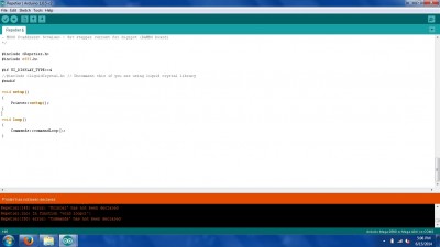

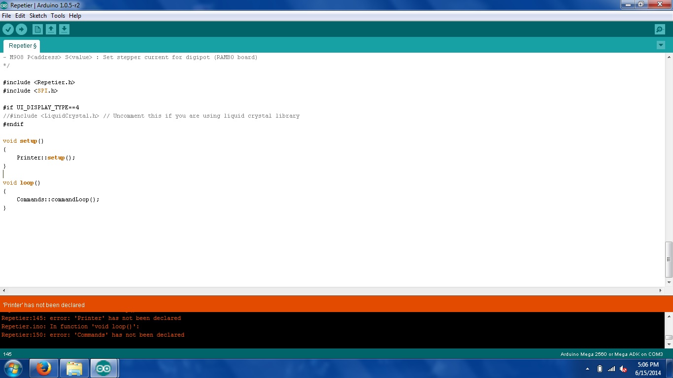

ok so i have built my printer it appears to be working i was able to clear the eprom without problems and it looks like it takes so i load the repetier.ino to arduino and get an error message. i am not converscent enough in arduino to figure out what is wrong with the program so i am including a jpg to see whats up.
any help would be great

Wild guess: it looks like you're missing some files, so that the main objects aren't defined.gaexcalibur wrote:ok so i have built my printer it appears to be working i was able to clear the eprom without problems and it looks like it takes so i load the repetier.ino to arduino and get an error message.
We also only see three errors in that error window, but the scrollbar implies that there's LOTS more above it. What's the first error you hit?
Dan

for some strange reason it has a lot of blank spots above the errors shown, dont know why but it is blank above those errors. and i have put all of the files i downloaded into the arduino directory so i should not be missing anything, hopefully

looking at your screenshot, you should have a ton of tabs across the top for all the files, when you download the firmware zip, extract it... then open the repetier.ino file in the /repetier/ dir, it wont compile if all the associated files dont open with the main... if you only get one tab at the top, it didnt fully open.

well i got it figured out, when ardiuno opened the repeater it moved it to a different directory without all of the other files so once i copied all of the other files to the same location everything worked as advertised and i am now to the point of running the machine. YEA happy time
