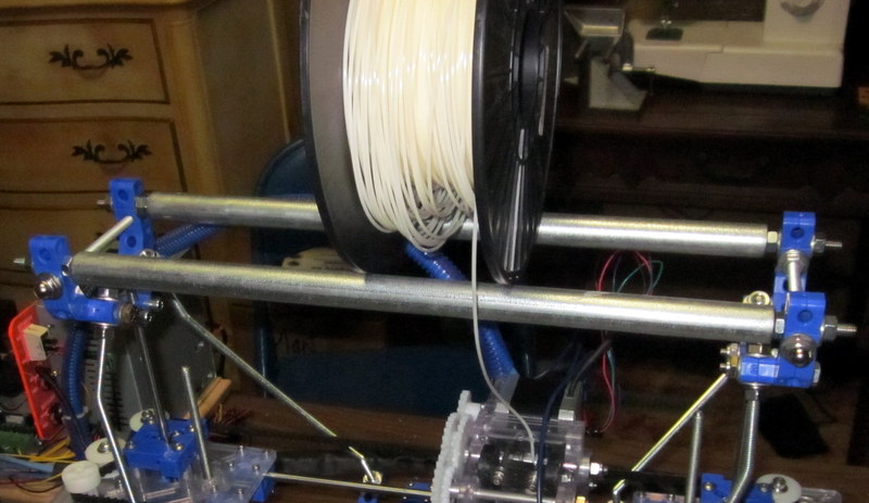

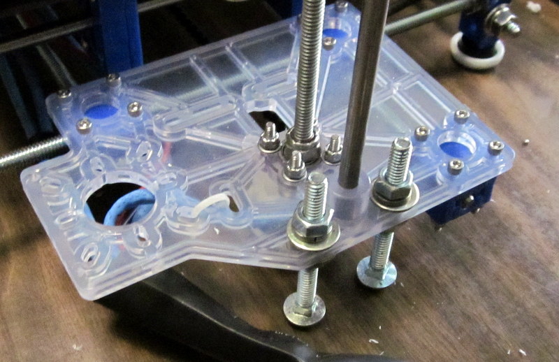

Added these simple "feet"
It eliminated almost all the wobble and shaking of frame.
This along with adding rods across top.
Now the machine is rock solid.
~*Brian

Interesting, I might give that a try. Nice mod!
