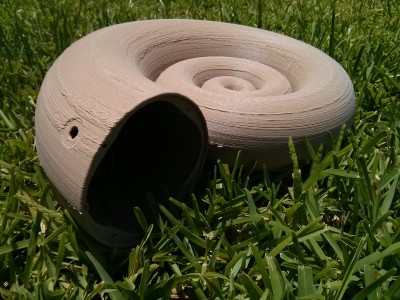

And, this is my version!.
Akemake Spirula speaker!

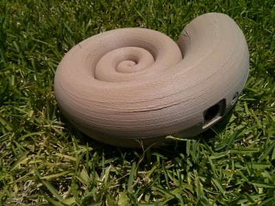

another view
another view
I am using Zen Wood PLA. Still waiting on my electronic components to finish this little guy!

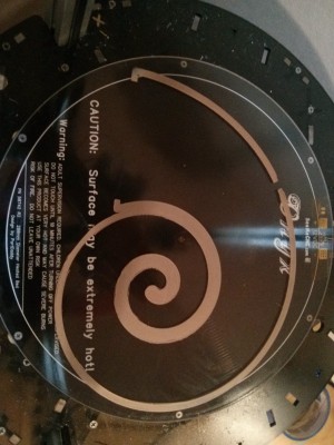

Warning: you would have to print a little outside of your printer bed ... face no fear, it is possible (I do this regularly:-) )!
Look Ma! I'm printing out of the 11"! :-)

artexmg wrote: Warning: you would have to print a little outside of your printer bed ... face no fear, it is possible (I do this regularly:-) )!
How did you fool your slicer to print outside the bed? I got the file and Slic3r does not like it with default settings.
nitewatchman
Re: Akemake Spirula Speakers
Posted: Sun Jun 22, 2014 12:17 am
by artexmg
nitewatchman
I am using Simplify 3D. However, I would just change the settings of the Printing Bed in Repetier Host to the diameter you want to print (I assume you are using Slic3r with Repetier).
Cheers!

EDIT: I made a comment a few minutes ago that I could not get this to print as it was just too big. Gotta take that back; I'm still learning. If you have either of the farthest edges of the print directly across from a tower, you're done. BUT, if you take a moment, you can see that you can take advantage of the delta geometry and put those farthest points close to a tower instead. This is what I've now done and I can reach those distances fairly easily.
Posted: Sun Jun 22, 2014 11:10 pm
by McSlappy
I've printed slightly beyond the bed but it seems to introduce some oddness in the vertical walls.. Nothing too bad but not as pretty as a normal wall is :)

Tinyhead wrote:EDIT: I made a comment a few minutes ago that I could not get this to print as it was just too big. Gotta take that back; I'm still learning. If you have either of the farthest edges of the print directly across from a tower, you're done. BUT, if you take a moment, you can see that you can take advantage of the delta geometry and put those farthest points close to a tower instead. This is what I've now done and I can reach those distances fairly easily.
Yes, you are right! if had learned (the hard way, literally), that little trick. I can gain 1" (aprox) using it.
and, yes, the risk of having these points right across from a tower is the cheapskate "falling" and hitting the ground :-)
Posted: Sun Jun 22, 2014 11:40 pm
by artexmg
Ah ... there is another trick that, I am not sure if it is real or just my imagination (had not time/need to verify it yet).
This is, I think I can reach further distances if I mount my E3D hot end below the effector platform, than when it is mounted above it.
Which makes me think that the higher the layer, the further I can get in the perimeter I can get. It is easy to verify, though, not done it yet (yes, I am lazy!)
It makes sense, but, not always what makes sense is what really happens, so, until not verified, it is just a kind of myth :-)
Having the same issue but I haven't figured it out yet. Got a hint for the rotation?
nitewatchman
Posted: Sun Jun 22, 2014 11:55 pm
by artexmg
nitewatchman
Well, just rotate the piece before slicing it. Take a look to the picture I posted. If you look close, you will see in the top the X tower. I would suggest you to made the same orientation.
Ah, other thing I did was to increase the current on the three steppers, in the configuration.h section of the firmware, to 195 each, like this:
#define MOTOR_CURRENT {195,195,195,195,195} (NOTE: the last motor if only for a second extruder configuration)
I believe this helps the motor to perform when they are in those edges (not sure if this is true or just a "superstition" :-))
Cheers!
