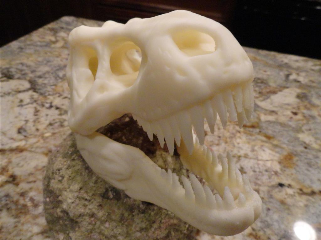

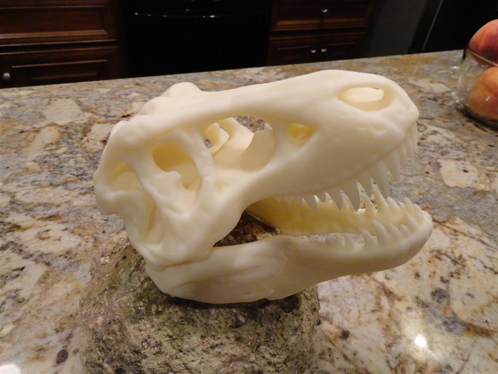

As demanded ------ photos.McSlappy wrote:Yes we demand photos!!
This was printed without support. The skull is not water tight and I did not repair it. This results in a couple of thin spots at the top of two bridges but it still prints very cleanly. I did turn on the layer fan when the front teeth started to print, otherwise they are a little rubbery even with ABS. Printed very cleanly just as dropped, back of skull down. I still need to work out on the teeth with a scraper and wire brush.
Guy on thingiverse is working on the rest of the skeleton in the same scale as the skull, he has the legs and pelvis done. If he matches the quality of the Curriculum Model the result will be spectacular. The Smithsonian is also scanning a full T-Rex skeleton and intends to put it on their web site for 3-D printing.
Looking at the finished skull is pretty intimidating when you consider the teeth, muscle anchor points and strength of the jaw. Even an animal this size would be deadly. Now consider the real one was 20+ times larger. If men have been around at that time they would have just been horse-doovers before the meal.
nitewatchman
