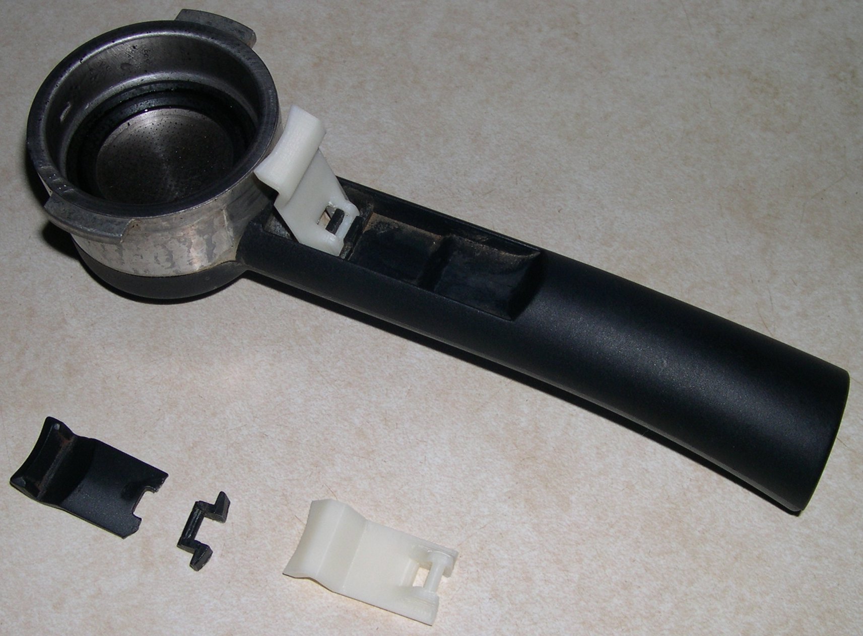

My son drew this up and we printed it last night. Fit just right the first try!
Wife was very impressed :D
Beefed up design with fillets and extra ribs, should last longer than the OEM part.
This little lever folds up to hold strainer in place while banging out the coffee grounds puck. Keeps you from burning your finger on the metal.
( De'Longhi EC155 - Coffee machine with cappuccinatore - 15 bar )

Thank you guys for the compliments.
I enjoyed working with my son and making something truly useful.
Print time was 15 minutes. probably 3 hours in design/draw/convert/setup.
