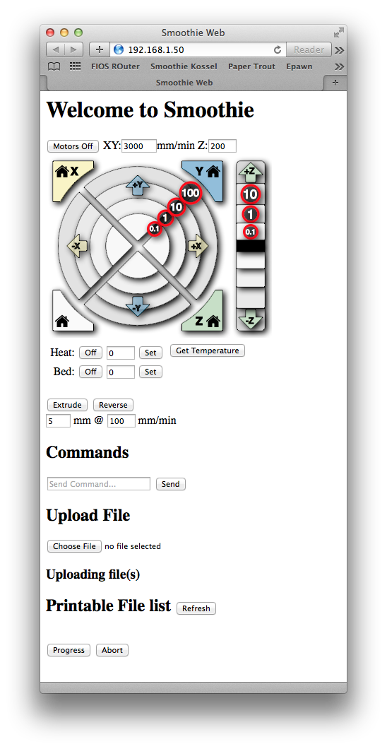

Printing from the SD card on smoothie is easy. You transfer your files to the card first. You can do this by moving the SD card to your computer and adding the files, or simply copy the files to the card when it mounts on your desktop. If it isn't doing this, you probably are running Linux and have auto mount disabled. You can change that or manually mount it. The other option is to use the built in Web Server if you have an ethernet port and connection to the board. You need the smoothie's IP address. You can upload files to the SD card with it. The interface looks a lot like Pronterface:
To run the gcode from the SD card there are a few options too!
Use a serial port terminal application like CoolTerm (supports Mac, Win, Linux). You can run/pause/stop, etc.
Use the Web interface mentioned above.
If you have an LCD (like the RepRapDiscount GLCD) you can run from it exactly like you do with a display on RAMBo.
If you use Pronterface, you can use its built-in serial terminal feature - just prefix serial commands with an "@". So, once connected to smoothie send "@help" and it will list all of the available commands.

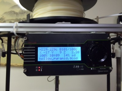

Curious - will the smoothie work with the SmartController shipped with the RMax?
Re: Quantifiable improvement?
Not really. Apparently there is too much noise on the IC2 bus so they are not recommended: http://smoothieware.org/panel
However, one of the smoothie developers - wolfmanjm - has a an adapter that uses a cheap Arduino mini to use these panels. I plan to try this but haven't yet.
Hey Michael! Any progress on using an Arduino Mini to connect the RepRap Discount LCD? Curious if you got it to work because I may be trying it soon.mhackney wrote:Not really. Apparently there is too much noise on the IC2 bus so they are not recommended: http://smoothieware.org/panel
I am using the Viki LCD controller which is I2C and using wolfmanjm's universal panel adaptor with a Sainsmart Arduino nano clone and it works great. It even includes a splittable ribbon cable with individual jumper style connectors on each end that is long enough to connect it up between the 3 boards without soldering. Is the standard Rostock Max LCD also an I2C interface?mhackney wrote:Not really. Apparently there is too much noise on the IC2 bus so they are not recommended: http://smoothieware.org/panel

Is there documentation to set up the Viki LCD in the configuration that you used?Broose wrote:I am using the Viki LCD controller which is I2C and using wolfmanjm's universal panel adaptor with a Sainsmart Arduino nano clone and it works great. It even includes a splittable ribbon cable with individual jumper style connectors on each end that is long enough to connect it up between the 3 boards without soldering. Is the standard Rostock Max LCD also an I2C interface?mhackney wrote:Not really. Apparently there is too much noise on the IC2 bus so they are not recommended: http://smoothieware.org/panel
All I needed was in the readme in wolfmanjm's universal panel adaptor on github. There is a little messing around to get the Arduino libraries set up right to compile and download. Some the pins were named somewhat differently but I was able to figure it out without too much trouble. I think I ended up using a different pin than the example did on Smoothie for the busy line so I could use a pin with a jumper leg on it and didn't have to solder to the board, then I defined that input for "panel.busy_pin" in config (as described in the readme)Eaglezsoar wrote:
