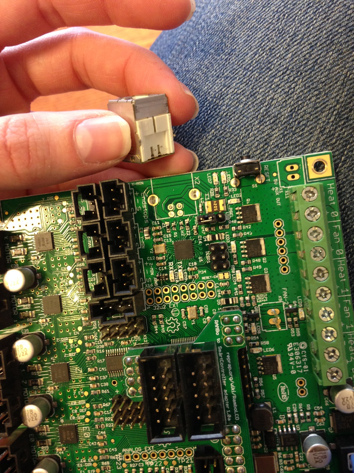

I broke off the USB port ... (rostock max) Pic included
Post by Vakbezel »
It was a little jiggly to begin with, but I broke it off.
Recommendations of what solder to use to re-attach this?
Or any Tips on re attaching would be greatly appreciated

Re: I broke off the USB port ... (rostock max) Pic included
Post by atoff »
It's a simple enough fix. The 2 pins look intact, but the shielding pins seem to be severed. I'd just buy a new receptacle https://www.sparkfun.com/products/139 to make life easy. Get some solder wick, some standard 60/40 solder, and a bit of flux. Clear the holes using the solder wick, then just solder the new one in place. I always use flux when soldering, to create clean solder joints, if this is the only thing you're ever going to solder, you may just forgo that.
Post by dtgriscom »
Once you have this fixed, you should probably anchor the USB cable where it enters your printer so that yanking on the cable doesn't stress the connector.
