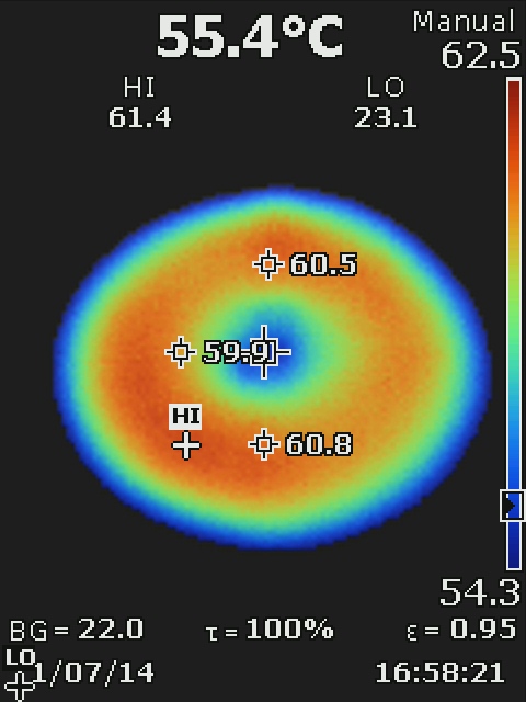

Having issues with my Rev5 heated bed not being able to reach more than 80-ish degrees, I decided to try something fun. I have access to a thermal imager, and I used it to determine 1) the real temperature of the bed and 2) see if the heat is evenly distributed over the entire bed face. I heated the bed to 60 degrees and took this picture:
I used the predrilled hole in the center for my thermistor, but it is seen that the center is actually "cold" (~55 deg.) relative to 4-5 inches away from the center (max. ~61 deg.). I guess three conclusions can be drawn from this:
1. The temperature across the entire face of the heated bed varies 5-6 degrees with the center being "cold".
2. The thermistor measurement is "off" by about 5 degrees (the printer thinks the bed is 60 degrees, but it is actually 55 at the location where the thermistor is located).
3. The best (average) temperature reading is achieved by placing the thermistor in the "green zone" in the picture, which is about 2 inches from the center (I believe as already suggested somewhere in this forum - You would have to drill a new hole though avoiding the tracks in the PCB).
I am somehow lucky, because the error introduced by "2." makes up for the error in not placing the thermistor at the correct (average temperature) location ;)

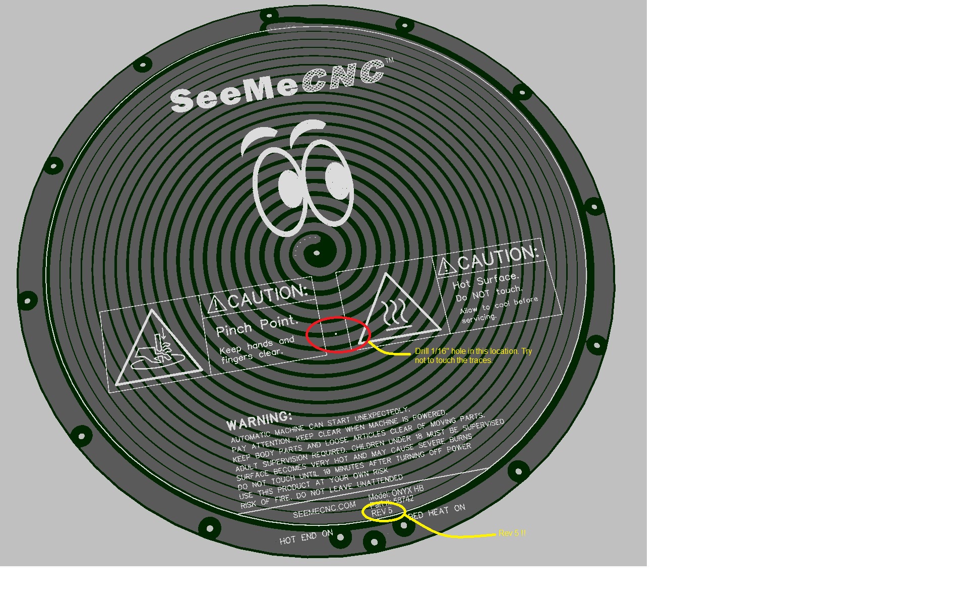

yup, you must have got one from the first round before we found out the same thing and created a second different hole for the thermistor....
see http://forum.seemecnc.com/download/file ... &mode=view for the new thermistor location... and rev 6 coming here soon for testing also.

nope, same solder pads as rev 5... just different heating element design... I brought a rev 6 here at the shop up to 120 in under a half hour and it held it for a few hours no problem
Guanu
edit: I take that back, the only real difference between rev 5 and rev 6 for soldering is that you dont need the + wire for the heated bed LED, its tied into the power of the bed, and since all + are shared on the rambo, its not needed anymore, so doesnt matter if its hooked up or not, but the - of the hot end led is still required...
the thermistor can go in the center of rev 6, does not need the extra drilled hole like rev 5
