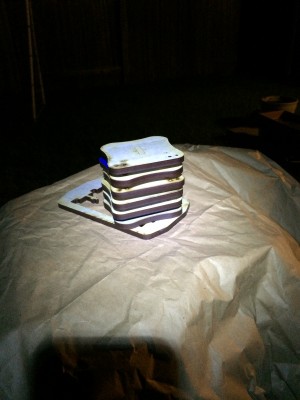

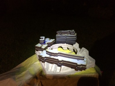

I got my *NEW* V2 kit this past weekend (great!).

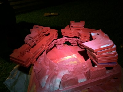

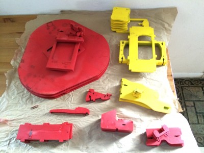

I ordered it black, as I like the combination of black-red-yellow, so, I started by painting the pieces accordingly.
As you can see on the pictures, this paint work was done at night ;-)
before
before
after
after

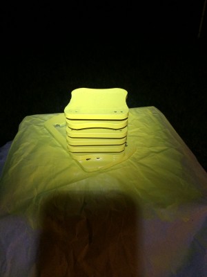

more
more

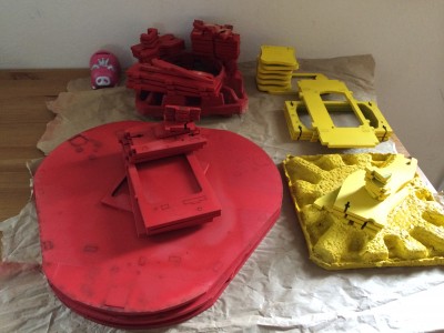

now red
now red
everything painted, ready to be peeled!
It is so exciting building a new kit again, after so many advances since the original one!.
Re: Art's *new* RostockMax V2 (Aka Night Fury!)
Posted: Tue Jul 08, 2014 2:56 am
by artexmg
Did anybody noticed the little pinky piggy in the last picture? :-)

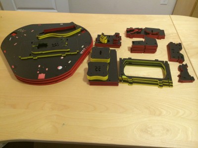

And, here is the before and after peeling ... I like it!
Ready, set ...
Ready, set ...
Peeled!
Peeled!
And I am ready to start building!!!!!!!!

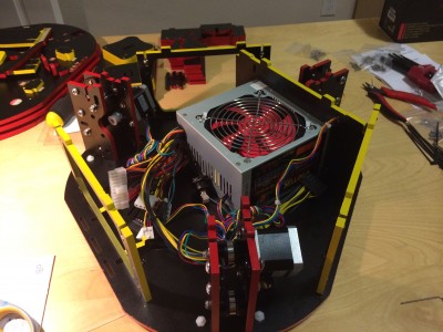

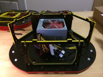

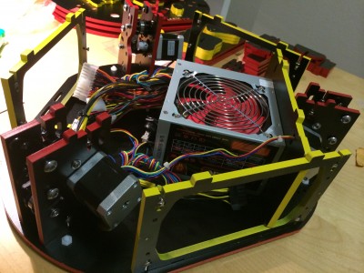

Making progress, these are the first steps in the building manual (by the way, thanks geneb!)
power source mounted

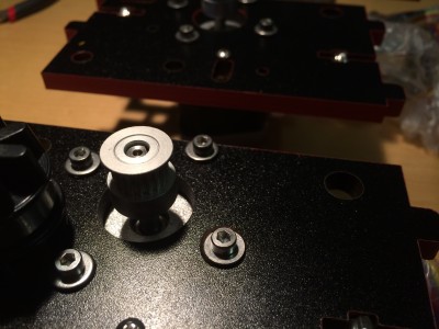

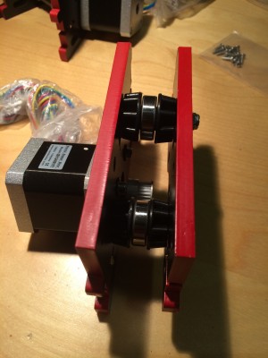

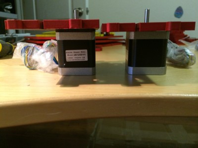

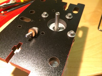

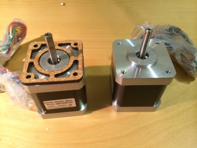

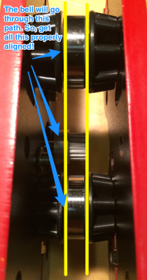

Installing the Motor Dampers (from Tricklaser ;-) )
With and without damper
See the difference between the two motors
The motor with the damper is "higher"

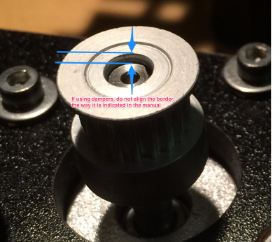

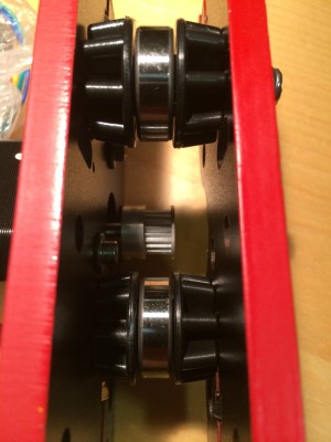

To compensate the width added by the dampers, you will need to place the Hobbed gear not aligned, as Geneb's manual indicates, but a little up.
Pulley perfectly aligned with the belt path (I jumped some steps ahead!)
Everything in line
Everything in line
Belt Path
Follow the yellow path (Oz?)
Be sure to place the damper in the screw, as well as washer, (first washer, then damper)
Be sure to place the damper and washer!
Posted: Fri Jul 11, 2014 4:39 am
by artexmg
This is the gap that has to be left to compensate the width of the dampers. If not, then the pulley will not be aligned with the belt.
See the gap, to compensate the damper!
This close or is OK? :-)
Close look
Close look

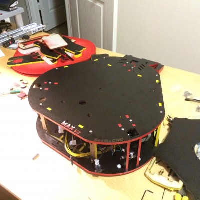

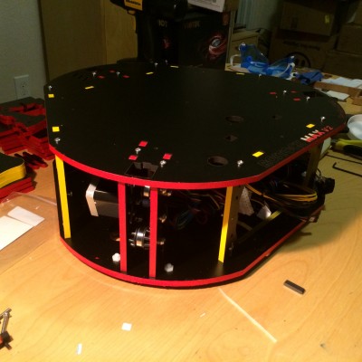

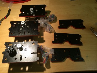

All step motors ready on one side
ready!
ready!
And now ready on the other side as well
Set ...
Set ...
... and now, steppers mounted all the way in their place ...
Go! all stepers mounted in the base ;-)
Diferent Angle
Diferent Angle
Posted: Fri Jul 11, 2014 4:47 am
by artexmg
It starts to get the well known, good Rostock Max shape!

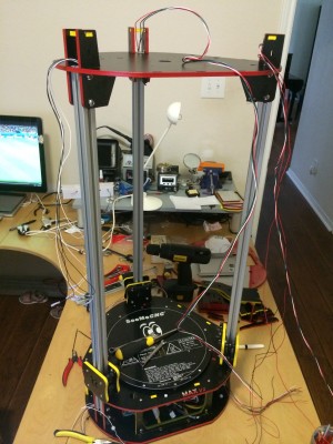

Posted: Sat Jul 19, 2014 3:31 am
by artexmg

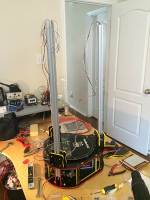

Towers mounted with cables routed inside.
Then, with the cheapskates mounted (here a short vid on how they roll work (just like geneb's :-) ): http://youtu.be/L42-53poE8Q!
another angle
another angle
