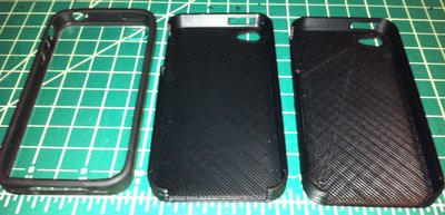

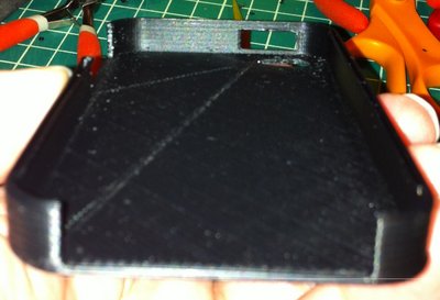

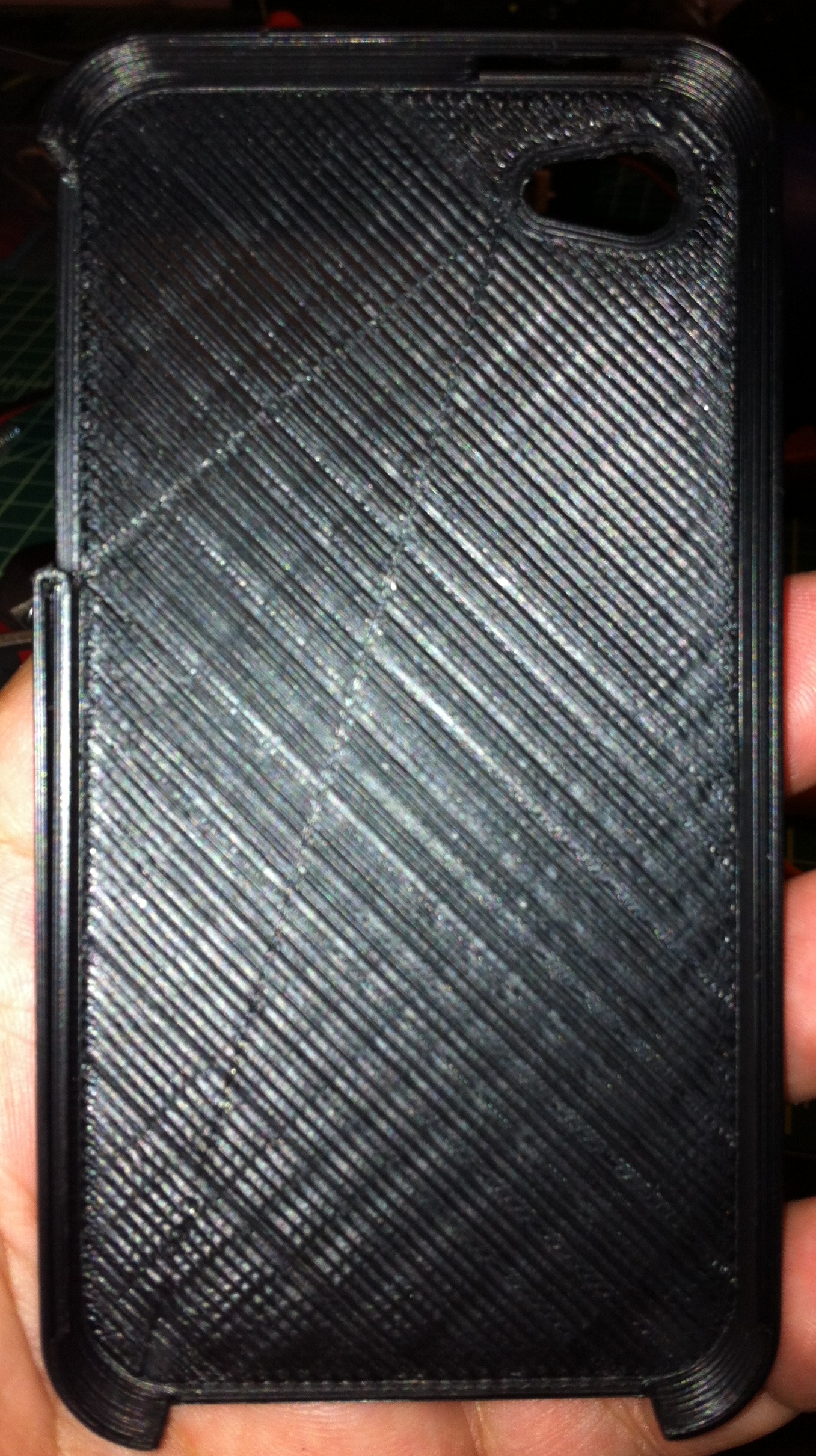

Hey all,
Here is a set of prints I did last night to replace a failing griffin iPhone 4 case.
The prints came out really well, a friend saw my case and wanted one for his iPhone.
I got the stl file from thingiverse. http://www.thingiverse.com/thing:22572

Very nice Michael! are you using abs? 3mm or 1.75

Thanks! I am using ABS 1.75mm. I have been fortunate that the same Slic3r settings (http://forum.seemecnc.com/viewtopic.php?f=31&t=33) are usable for everything I have printed so far.
I just use the Repetier's speed slide to increase the speed or decrease, so no need to mess with the settings.
It took me a while to get all the axis dialed in to allow for precise prints. The main one I used to calibrate my x and y axis is the 1/4 circle nickle print (http://www.thingiverse.com/thing:11261). I followed the instructions and was able to print 30mm test cube to within ~.1mm.

Looks really good.
How did you keep it flat and not curling up from bed?

Thanks Brian.
Yep, heated bed, nichrome wire design (http://forum.seemecnc.com/viewtopic.php?f=43&t=491) running at ~110C.
Prints stay flat and they seem to stick better to Kapton tape.
One thing I have found helps is that I use a Lysol/Clorox wipe to clean the print surface every 2-3 prints or when prints start to not stick and it makes a huge difference with it sticking to the tape.

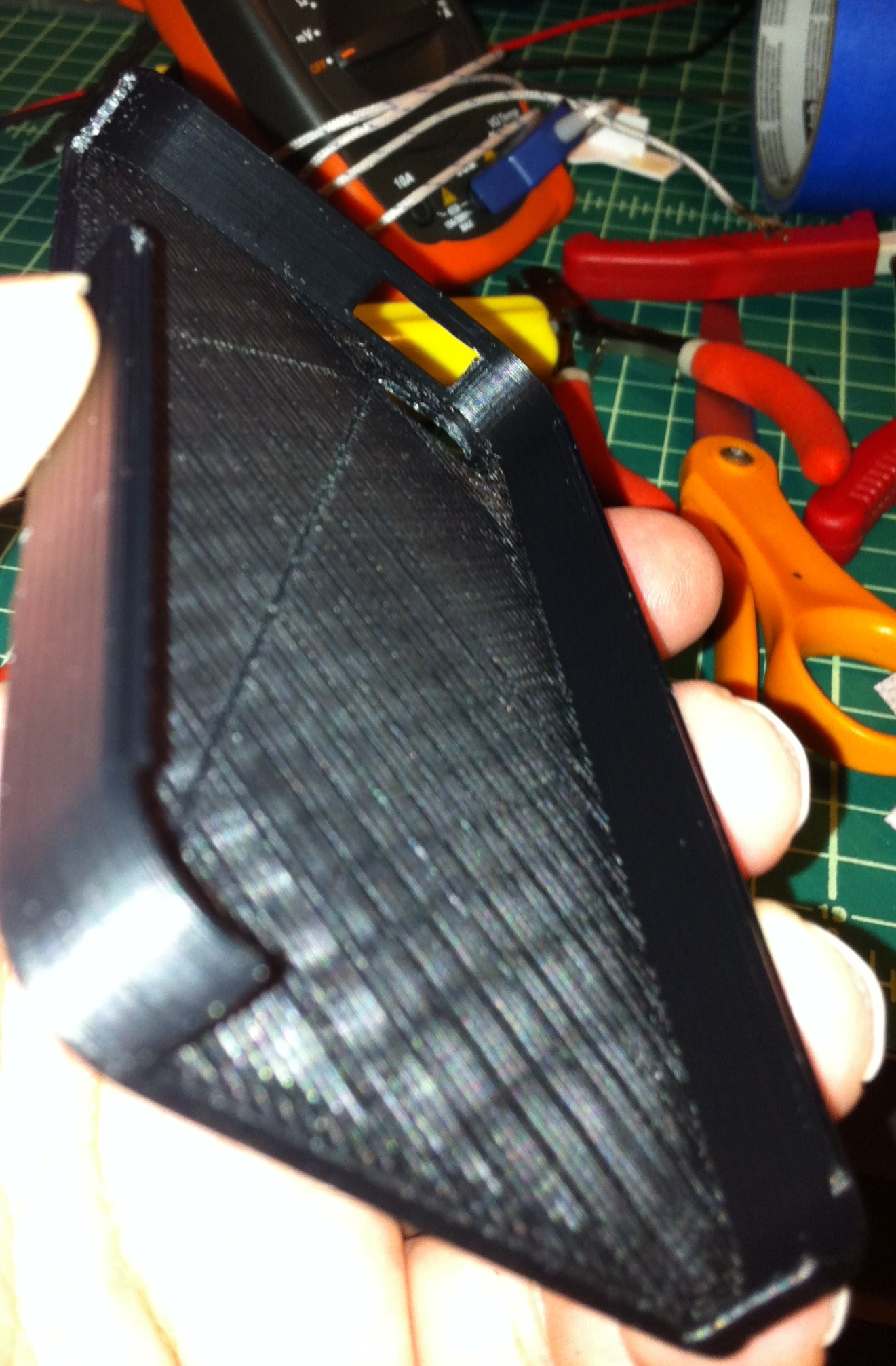

This is one I have tried to print several times. 1.75mm black abs
looks great till I get to the bridging sections then goes all to !@#$

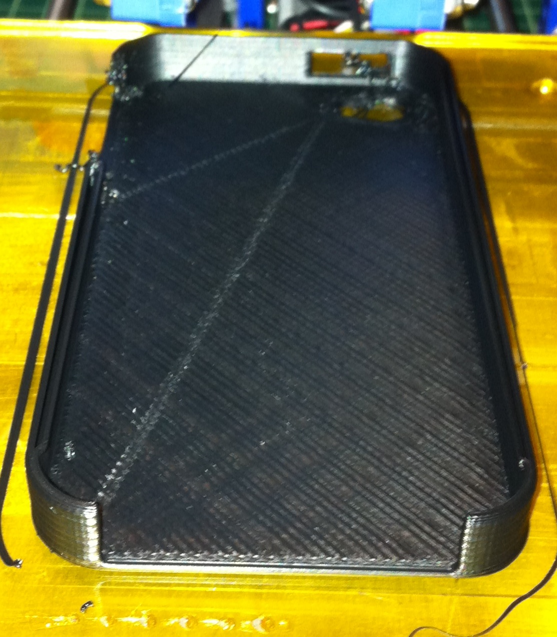

I printed my first attempt of this case tonight in ABS. The first layers seemed to go down great but then I started to get curl. This was with a heated bed and blue tape. I've noticed that even with the heated bed I still get curling on large flat surfaces like this. Perhaps blue tape is not the best. I do usually wipe the tape with acetone before printing but not always. Might need to try some other things. The case would have been perfect if not for the warping which caused the sides to be too short at the corners.

This case seems to be temperamental when it comes to curling, most of the time Kapton tape and a rubbing alcohol wipe work and once in a while nothing I do will make the print stick and the edges curl. . . Most other prints either stick ok or not at all

i use a little abs glue on larger (base) prints, mixed pretty thin.
Then I wipe it off with acetone when done. My heated bed gets a little hotter in a 4" square in the center.
But I warn you that it is MUCH harder to remove prints after, if you are using Kapton over glass I would let the item cool all the way down before trying to
remove it. I have pulled air bubbles into the tape that way.

I did another print last night with clean tape and fresh acetone wipe. It did not curl but it stuck to the tape and I couldn't pull it off! I might need to lower the temp of my hot bed. The part looked awesome though. The new "random starting point" option in Slic3r is great.
