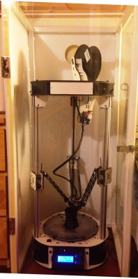

Hi,
I made cabinet with plexiglass & thin steel sheets combinations with powder coating finishing. It reduced the noise level from averege 68 DB to 59 DB for same make. Temperature
increased +5 degrees C related to room temp. There is 0.5 cm. all opening at bottom, 12,5 cm circular hole at the back&up of cabinet. I intend to apply dampers later too.

This is probably the route I will go first. Have you thought about lining the walls with foam or egg crate material to kill more sound? This also reminded me to download a decibel meter app to my phone. Thanks.denatik wrote:Hi,

Mounting egg case style noise reducers might cause more temperature increase. Opening big heat vent hole might cause noise increase too. So I do not recommend insulation. I used Iphone noise DB measurement too. Reminding, DB scale is logaritmic, 70 to 60 DB means 10 times noise reducing.BONE wrote:This is probably the route I will go first. Have you thought about lining the walls with foam or egg crate material to kill more sound? This also reminded me to download a decibel meter app to my phone. Thanks.denatik wrote:Hi,
